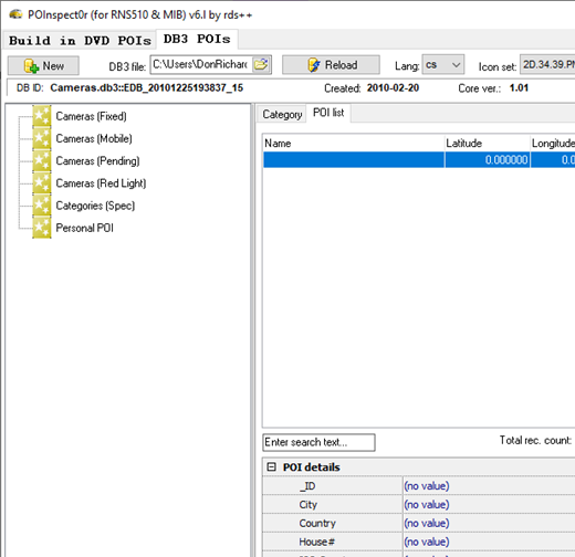

The USB stick was empty and formatted as FAT32 with 32KB sectors.
In POInspect0r I clicked on 'New' and created db3 file.
This then created a 'Personal POI' category.
I then created five categories as siblings of 'Personal POI'. See below...
Should I have deleted the 'Personal POI' category?
I've quickly done this at work, that's why there's no POI data or icons, but it's the same as I did last night
Tell
Yes if you haven't set an icon up for it. I guess that would cause it a problem.
The nesting is correct.
Once you get past this fussyness of first setting it up, it becomes easy to use.
Failing that try an SD card in the second slot in case it's idiosyncratic about reading a usb or that usb for Poi import. Default cluster size is fine.

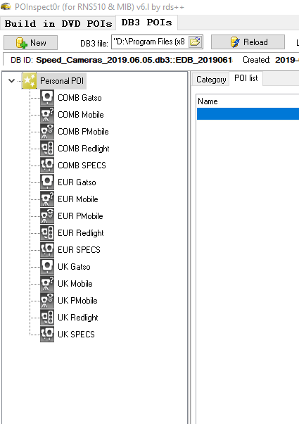

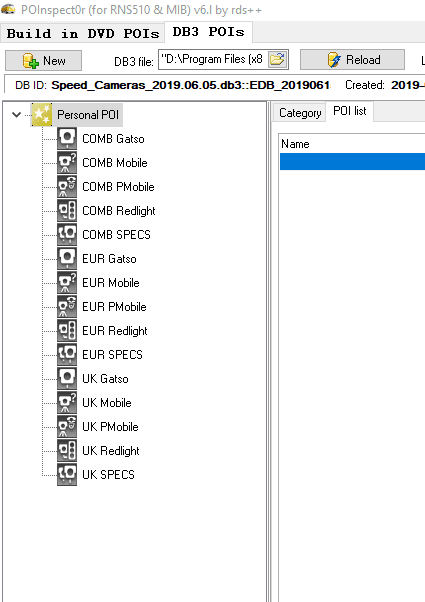

This is how I have mine. I have 3 lots, UK Only, Europe Only and I also setup combined ones. Works fine. I know the initial instructions seem to say have them all in their own groups, but that didn't work for me. I have a MY2018 car.

You can spread them out into types like that, uses more of your maximum number of icons the unit can show on the screen. Probably musical shares on getting it to work. Works fine how I have it but the GPS World screens are a bit clunky, take the "other" menu option and ov2.
BTW that's how you toggle them off when your friendly French or Austria policeman has his head through the window ;). I think they still beep. You'd have to test.
I only use 5 at a time, and now I have the UK and EUR ones combined that's all I need. I've kept them seperate like that so when I next update, I'll only update the UK ones. When I next go to France I'll update them both before hand and combine them again.
I have the beep turned off, too annoying as too many. I just put them on my Virtual Cockpit when on the motorway/dual carriageways etc.
As for the structure, doing it like @Don1961 has done it would not be recognised by the unit at all for me, despite the instructions I'd read seeming to say that was the way to do it. The way I've done it works for me no problem. I have 15 options to choose from, but obviously only use the 5 I need.
Edit - as for toggling them off, have you tried using the touch screen quickly when nervous haha, its bad enough when your relaxed lol

No the instructions are not wrong :). But it is tricky getting the icon profile set up correctly. I have had the program doing strange things in the past during the setting up phase. That is where its a good idea to start with a fresh build of the database file. Once you get past this phase using it is fairly easy. Because it's backwards compatible to the forunner of Mib units and has the flexibilty on numbers of POI sets it feels complex to set up, but a once only activity.
Once I got a bit of direction from @Maypack, the system is pretty easy to use to be honest.
I started with a completely new setup and this way of structuring (Siblings) never worked with my MY2018 car:
I thought I was going mad, but then I tied the following structure (Child) and it worked straight away:
Not sure how you could set up the sibling route any differently. It just never worked. Bit I've updated my Cameras 3 or 4 times now, and the Child way always works.
