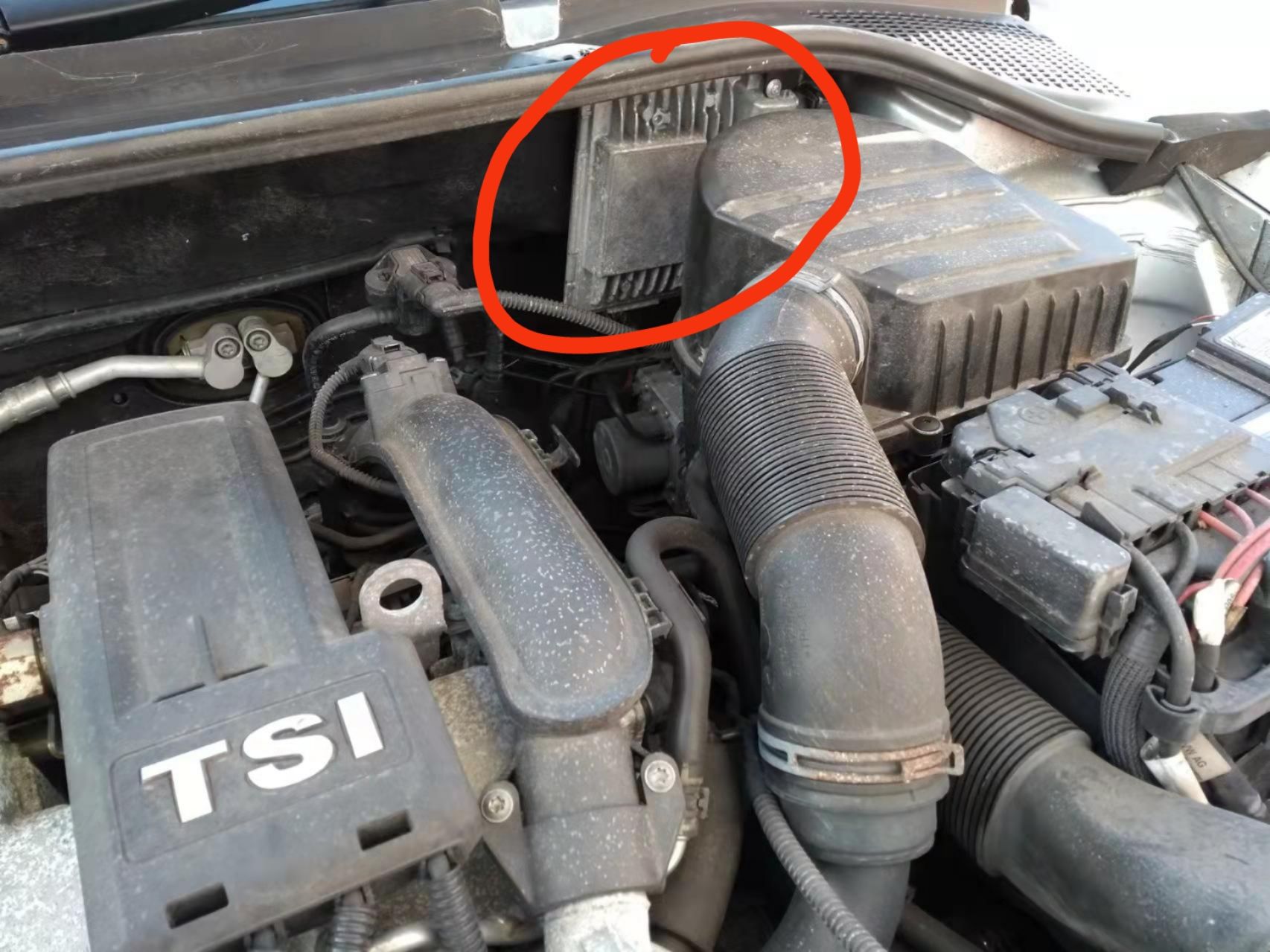

I had a strange noise too and it was a square chunk of metal between the airbox and the firewall. Don't know what it's called but it was loose, so I jammed it back onto the top where there were two plastic clips. The knocking sound over speed bumps are gone now.
Nov 26, 2020
5
I've circled the metal piece I was talking about
