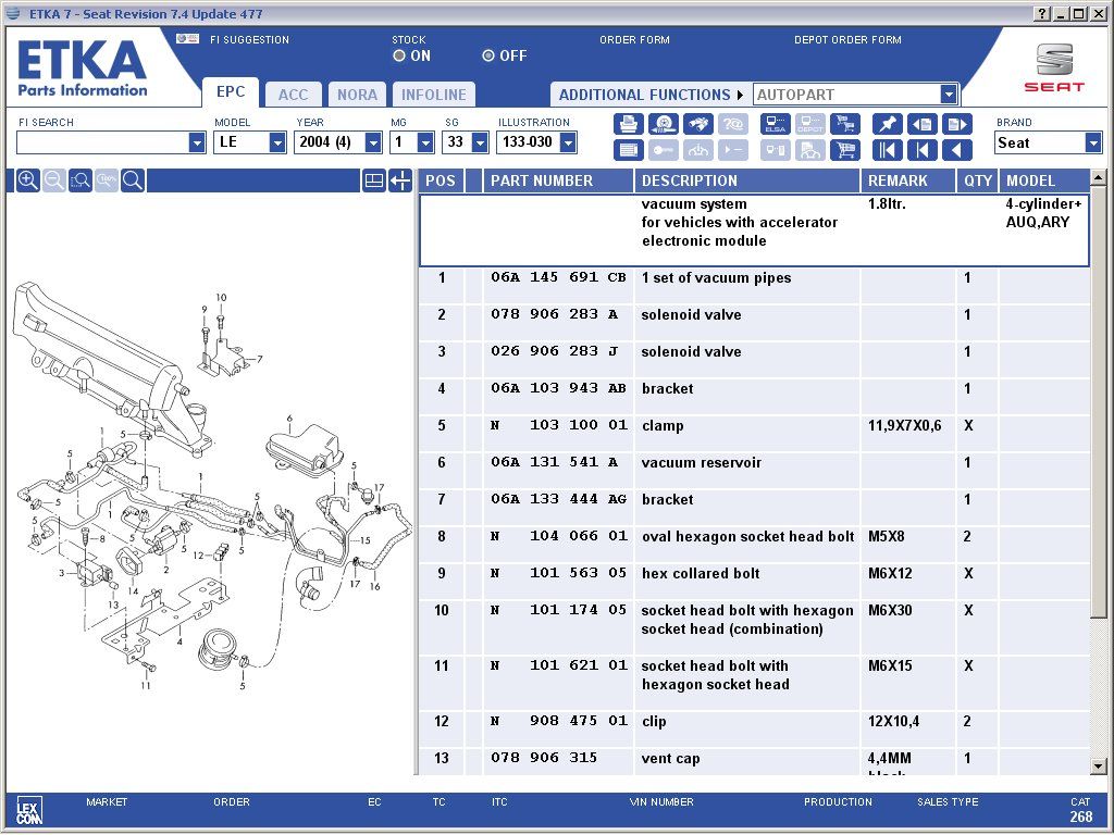

Stick a picture up on here and I will look on etka and see if I can find the part number for you.
747_727
Apr 2, 2012
1,113
Essex

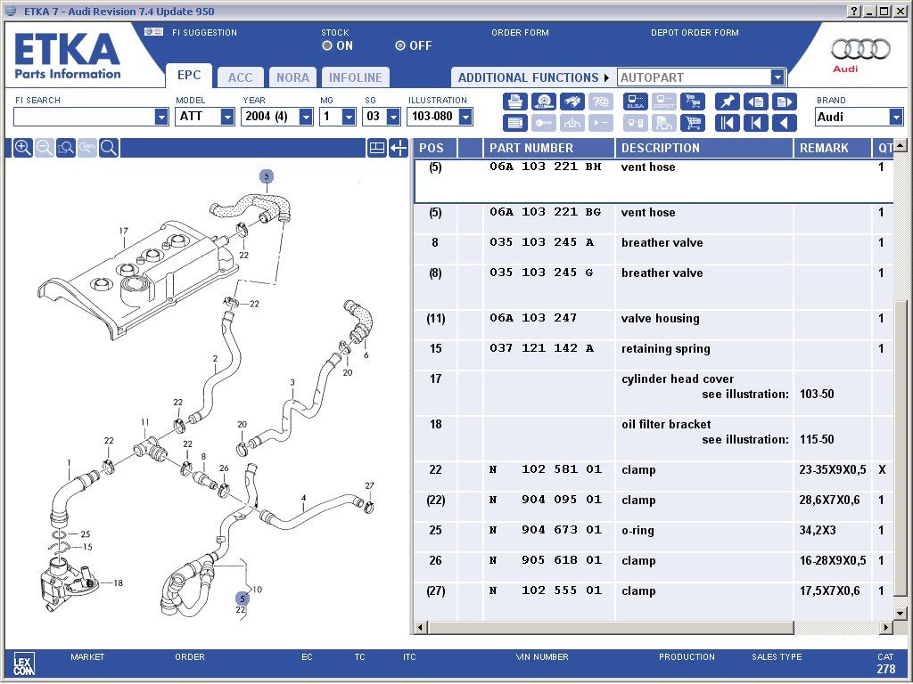

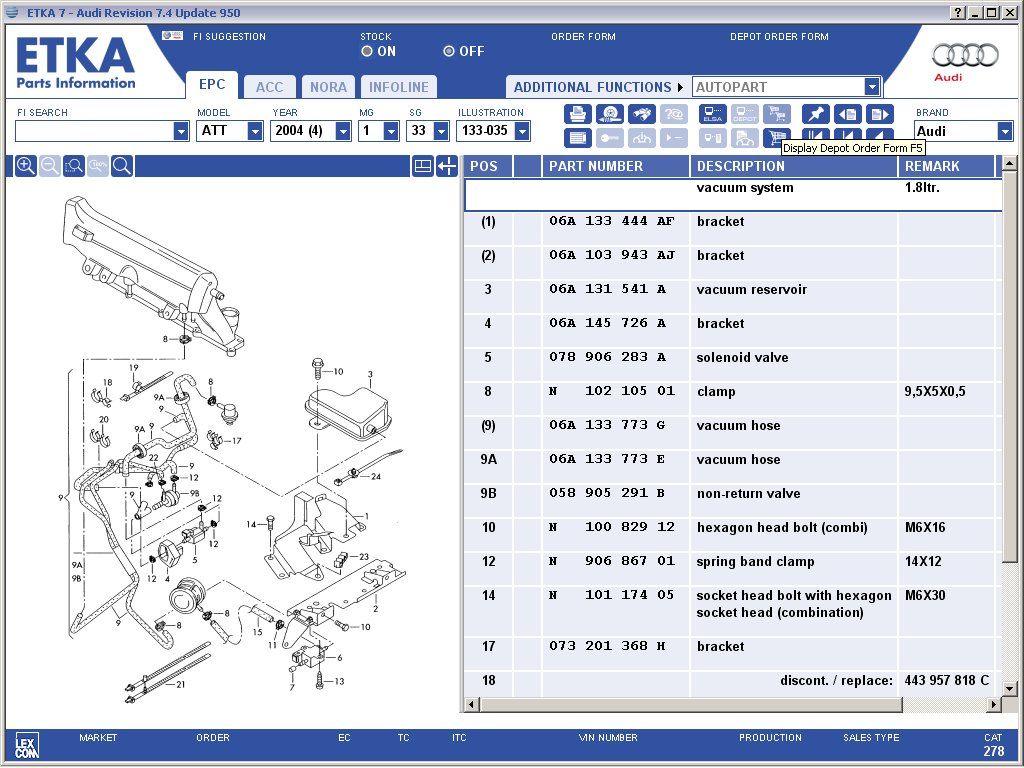

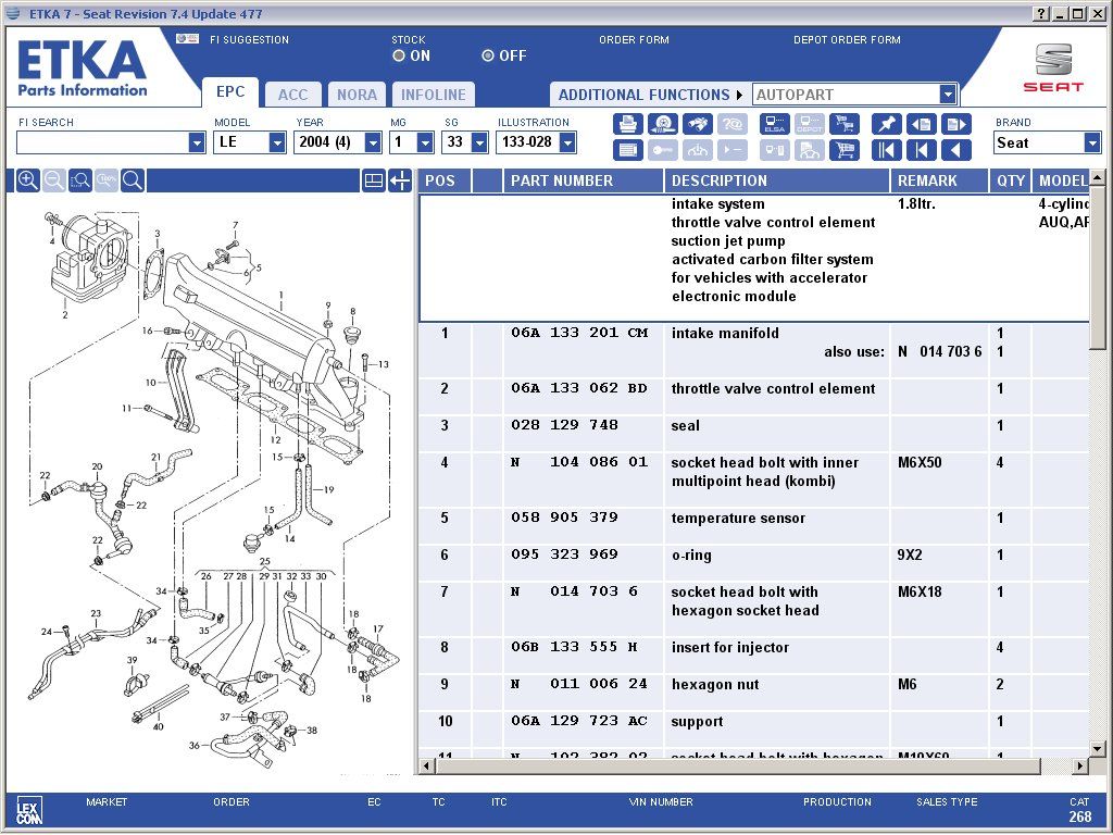

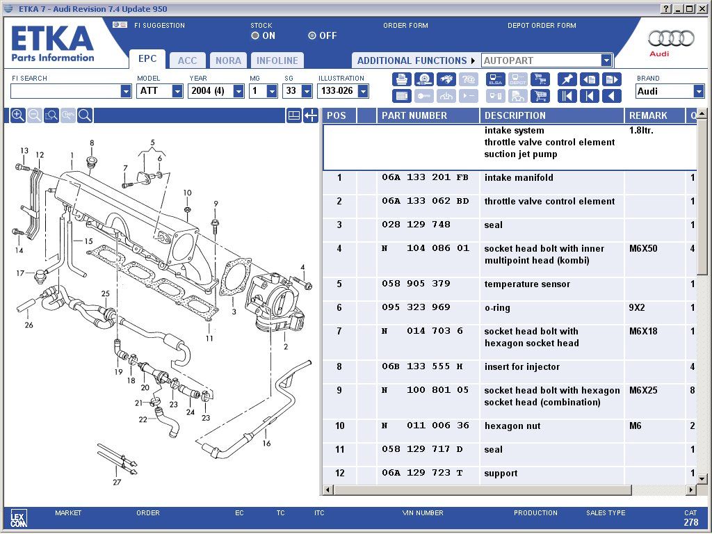

Here are the pictures from etka. See if you can work out what one you need. You will have to see if you can work out where the pipe starts that needs replacing and see if you can spot it on one of these diagrams. I was looking at the same pipes on my lcr and I worked out what I needed by printing off the pictures from etka and then looking at my car.
If you need a price let me know what number it is as my version gives a basic price but its not 100% up to date but it gives you an idea.
