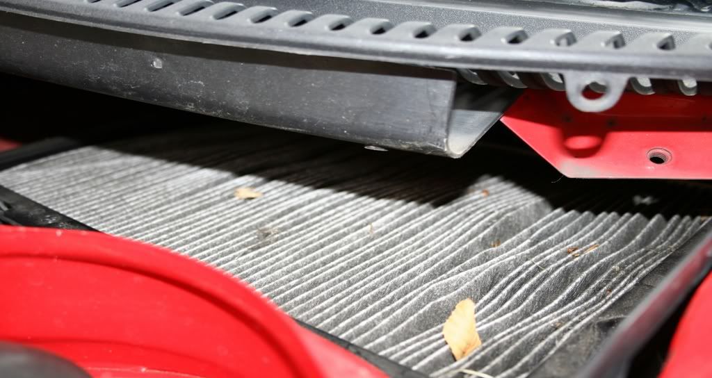

What a week, first get a offside rear puncture, then hit the biggest rabbit in Hampshire at 80mph which rips off my splitter and cracks the bumper.........and then today I thougt I'd give the LCR it's first proper hoover of the winter only to find that the drivers foot well and the rear passenger foot well soaked in water!
I think I have read about this before and a few suggestions were that the pollen filter was to blame for the leak, so I cheecked out the filter and it's in a shite condition (pic attached). So I will replece that ASAP.
Are there any other causes of water leaks (bearing in mind my LCR is on an 04 plate) that would only effect the drivers side??

Being the drivers side, i would say its nothing to do with the pollen filter etc. It's more than likely a case of removing the drivers door plastic trim, so you can see the insides of the door. Once this is off i expect you will see the bottom seal on the inside of the door has detiriorated, easy fix all you need is some good quality sealent.

There is also a fairly common problem with water getting in through seals/grommets in the bulkhead under the scuttle panel - it's been covered a few times in the last few months

me wheel centres are fairly small but they was fine until last couple of months and strongly segest you get some sealent for your doors as mines fine know other fault was where i put me 12v wire for my amp so id double check your polen filter an gromit just to the right of it i did mine on a **** day where it was ranin on an of but its still worked

water drains from the front into the back where it stores so you notice it in the back first it could still be your seals but id get your pollen filter done aswell or your defeating the object
