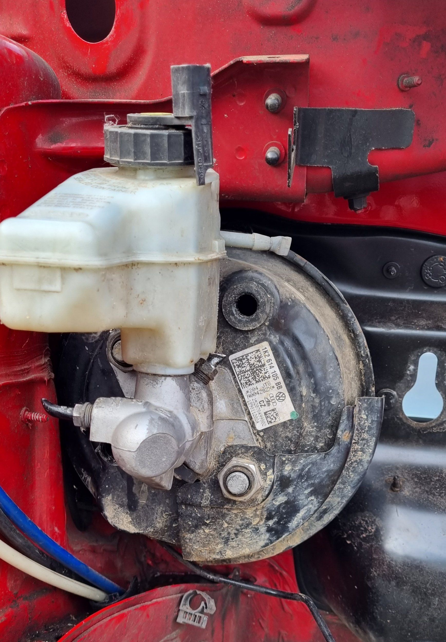

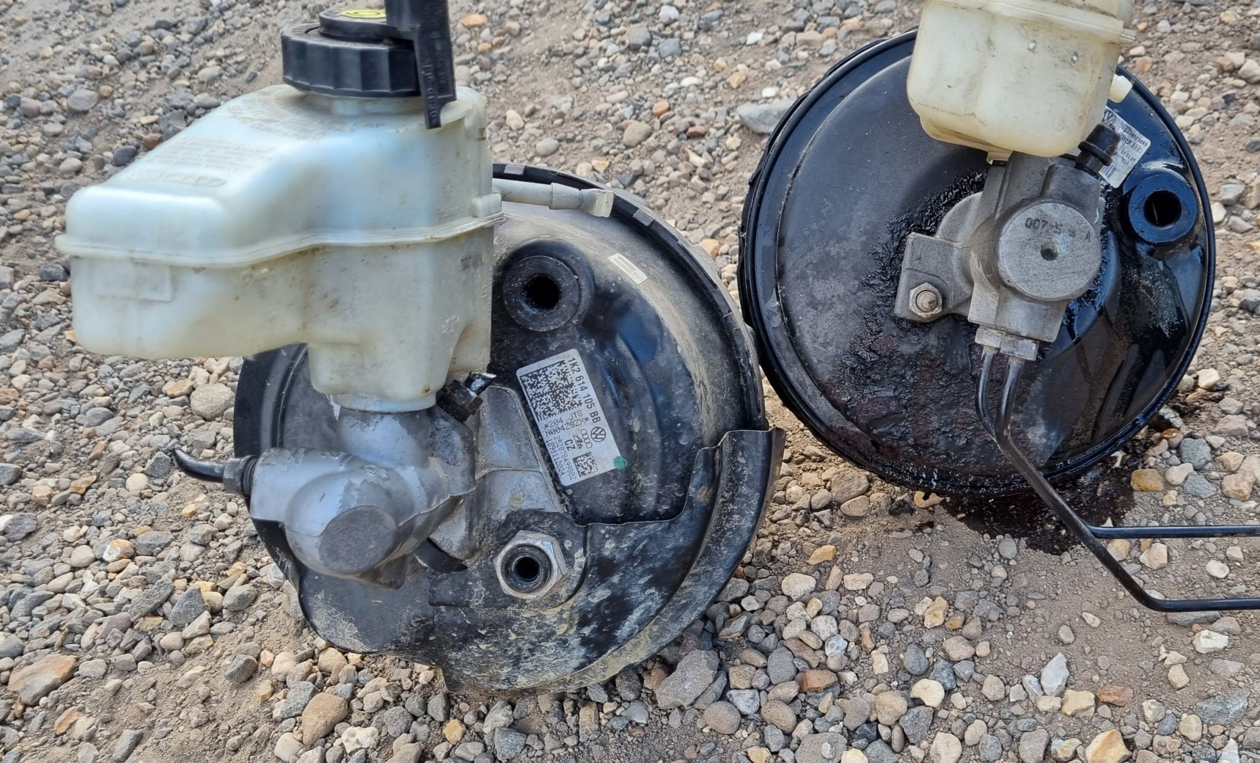

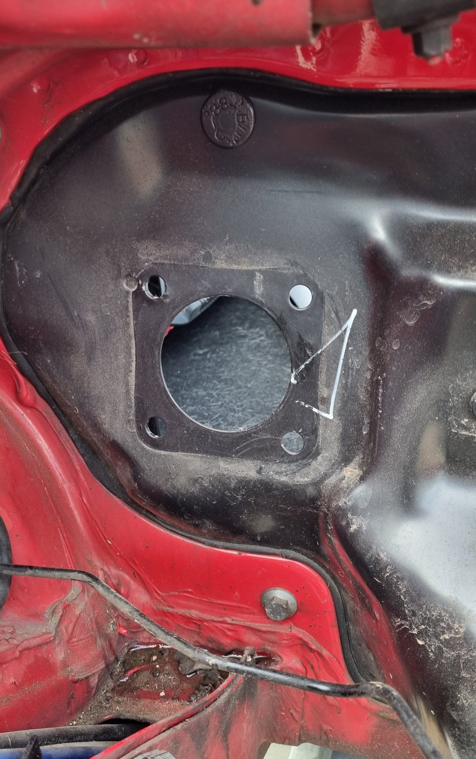

So, you guys know I like my experiments with random car parts so strap yourselves in for the latest installment.
Let's start with a hole
Here's what should go there (right) with the same thing from a 2009 Scirocco.
Pretty similar, but will it fit?
Oh come on, they must have changed something
Nope, it lines up perfectly, like millimetre perfect. Did some measuring and the back end is pretty much the same dimensions wise (was by eye with a tape measure so not super accurate).
The only thing now is the fluid level sensor wiring
Those cheap ba... I mean, great people who knew not to mess with a good thing.
Btw, yes I tested out the vacuum line and it fits as well. So far it looks like only the steel lines would need modification to fit. I don't know if the ESP sensor is compatible for those who run such things.

I love these posts. I'm not knowledgeable enough on different parts and sizes (nor brave enough) to try things like these, but I'm more than happy to ride your coat-tails if it all works...
Any particular reason for the test or just seeing if you can chop and change certain parts? If it might help my brakes, I'm in.
I'm just lucky enough to be curious and know people willing to indulge me (this was all done at a local specialist who was breaking a Leon and a Scirocco).
As for why, part of it is the age of the Mk1 Leon, getting a decent booster and/or master cylinder is becoming expensive, the newer ones may be the better option (newer than the original equipment, cheaper than the new stuff)
Other reasons are a bit more specific.
It reroutes the lines which hopefully gives room to reroute turbo hoses (looking at running a different radpack).
Also, the one I used was from an auto which means the reservoir is capped off for the clutch line. That makes it an easy way to separate the clutch line, useful if you want to run race brake fluid etc
