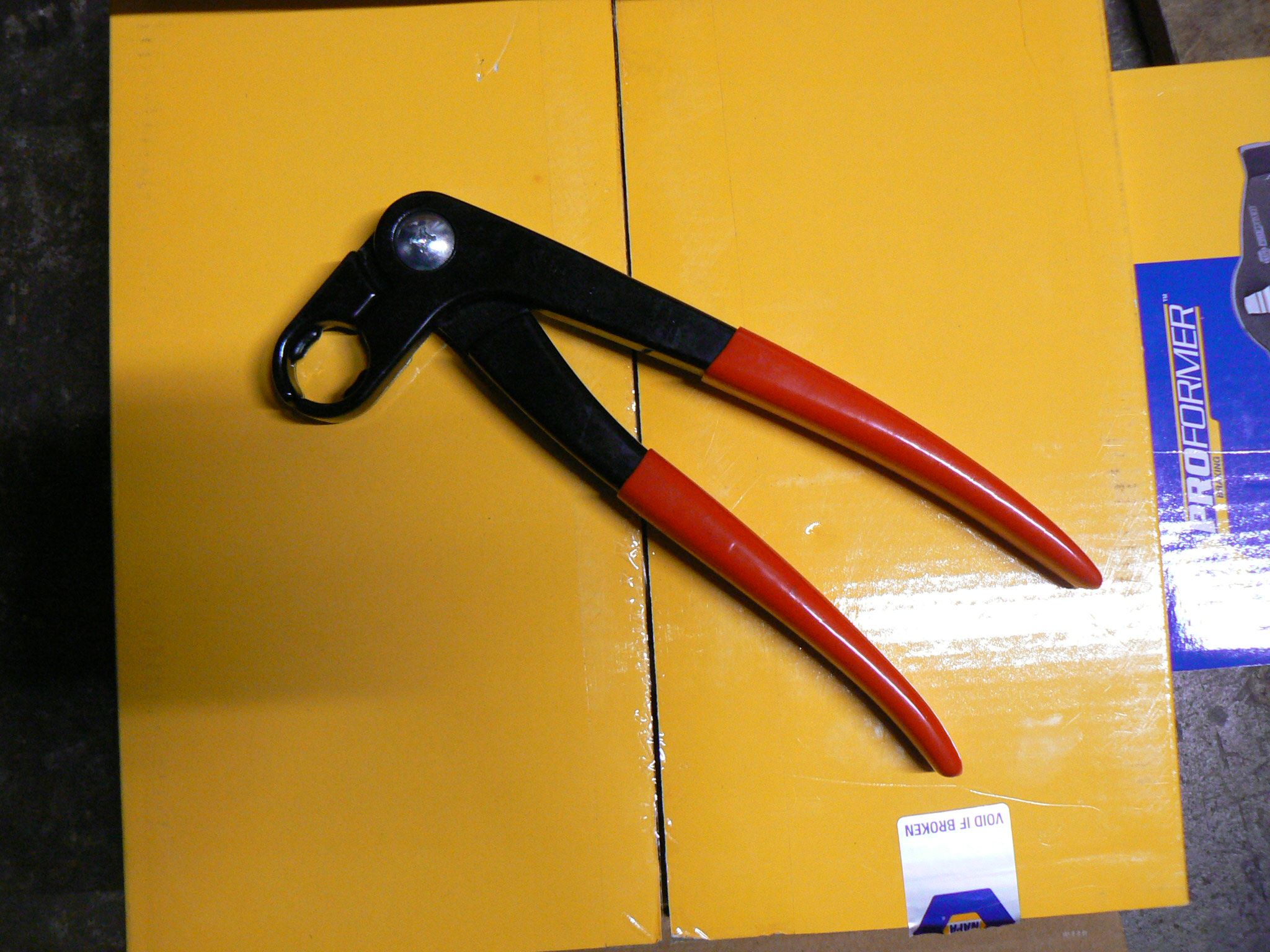

which I found on Ebay (around £8.00) and I've tried it on one of the connections. It depresses the tabs easily and allowed the pipe to be removed satisfactorily. When doing the filter the two pipes on the tank side have their detent tabs facing downwards so could be done quite easily with something like a pair of long nose pliers, but be careful not to break anything as I believe you can't buy just the connectors, you have to buy the whole pipe (RUM may know more on this) However the front pipe - which takes the fuel forward to the engine - has it's detent tab on the top. between the floor and filter pipe, so making it necessary to loosen the filter from it's fixing (admittedly you're going to be doing this anyway to change the filter) to get a purchase on the tab with your pliers. The tool I bought has little protrusions on both jaws which allow it to depress the tab whether it's on the top or bottom of the connector. Just makes the whole job easier. By the way there are 2 delivery pressures - that I know of - controlled by this filter. One is 4 bar and the other 6.6 bar - mine's the 6.6 bar one. If you're doing one make sure to buy the right filter. (it's written on the old one so you can easily check)

Edit : you'll see attachment 34742 in the previous post - it's the pliers for doing the quick release clips on the fuel pipes.
