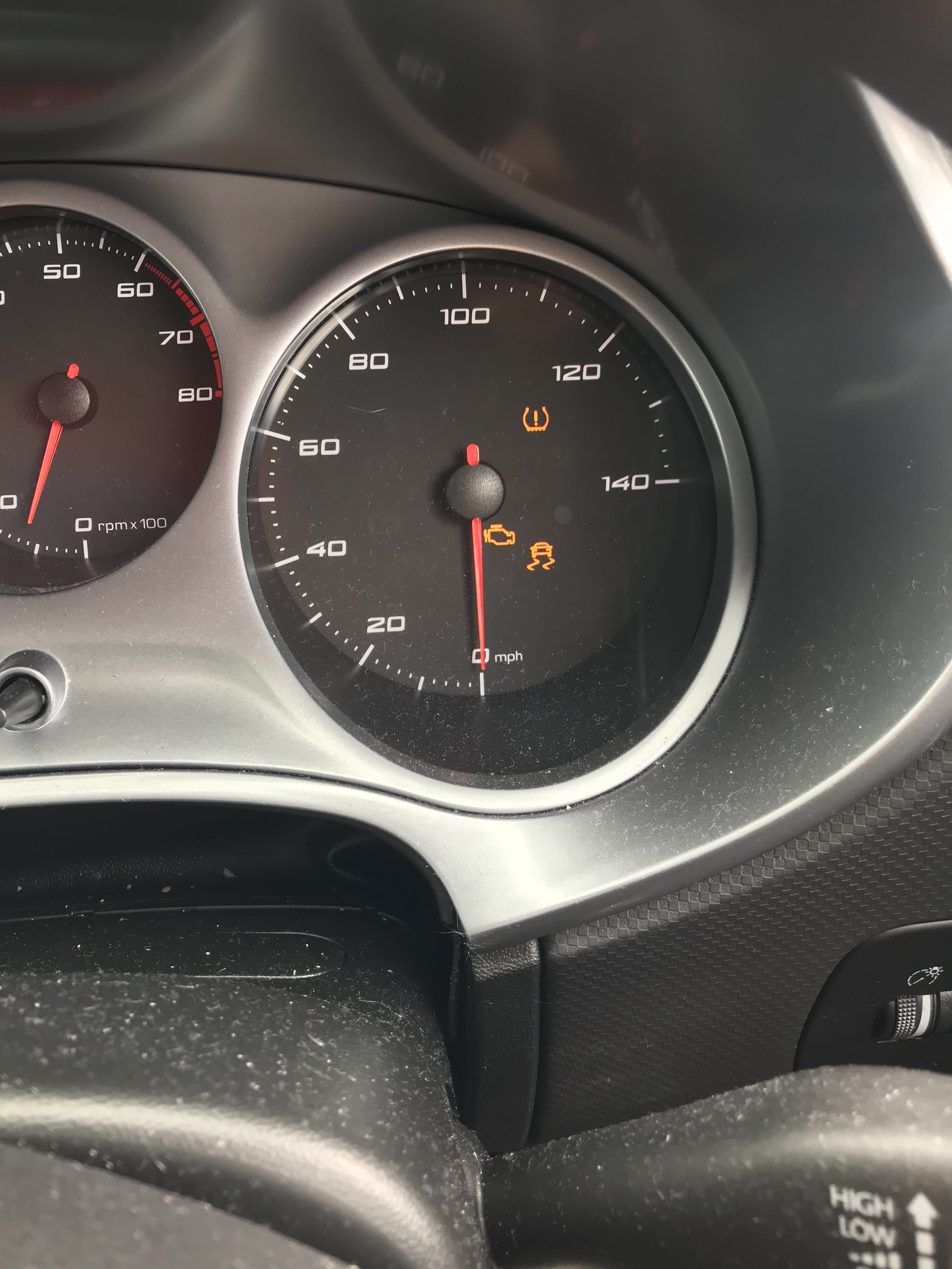

Hi guys
I’m still having the following lights come on my dash, does anyone know what could be causing them as my local garage isn’t sure at this time

Could it be ABS sensors? Do you have access to a VCDS or ODBEleven (code readers)?
That would be able to tell you what's going on.

Really you need to either bite the bullet and get a VAG specialist to diagnose and fix it, or get a diagnostic interface and read the fault codes so you have an idea of where to look if you want to try fixing it yourself.
OBDeleven seems to be a popular choice for diagnostic interfaces with people on here, though I haven't used it myself as I have a genuine VCDS cable.
Unless you start narrowing it down to more specific things you'll just keep going round in circles. In my opinion it's pointless to replace things because they 'might' be at fault (like the battery you mentioned in the first post).
Also, for people trying to help you it's far easier to have actual fault codes to work off rather than vague descriptions.
"I've got fault code xxxxx saying inlet manifold air pressure is lower than expected" is significantly more helpful than "garage used a device and said air leak"
