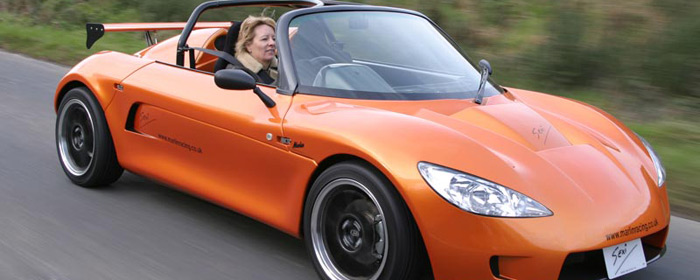

Very nice indeed ... what's the space like in it ... I know from the Marlin site it says if you're >6'4" or 13 stone it may not be comfortable inside (and I'm both :cry:)but wondered what it was actually like.
Had my eye on doing a Dax Caterham 7 replica for a while which should have a nice lot of room inside, but the Marlin is a lot rarer on the roads (and nicer looking) :)
limpabit
Nov 10, 2008
63
There can be things done to account for tall people. I'm 6' and my head goes slightly above the rollbars. But I fitted a false floor to mount the seats and a comfy seat as I will be going on long trips. But again you can get lower more uncomfortable seats.:D
But there is another drive taller than me that fits ok. Another thing you can do is lower the floor base.
The main reason for me choosing this kit was because it was different from other kit cars.
