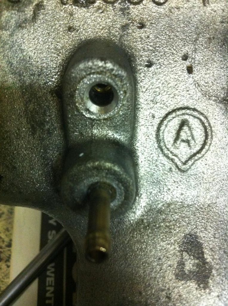

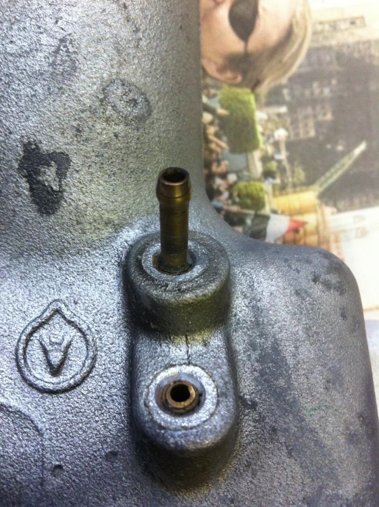

Anyone know where I can get ones of these ?
It's the small 5mm vacuum nipple that sits on the under side of the inlet manifold on the left hand side.
I managed to get the old one out, Soaked it in WD40, then screwed a self tapping screw into it and pulled it out :)

Get a piece of tube that fits the hole, something thats a tight fit anyway, and loctite or solder it in place. Don't suppose it needs to be particularly strong so long as it stays in place and doesn't leak?
