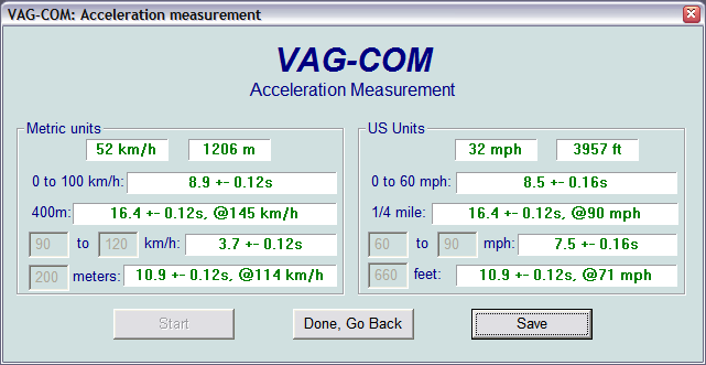

There isnt a 0-60 bit.
You need to find a block that take speed measurement and log it. The log will give you a time stamp, and with these 2 figures you can calculate your time to certain speeds.

Correct, but there will be in the next version:

I was lead to believe its more accurate than a stopwatch and inaccurate speedo so unless you have a proper GPS timing kit then its about the best way you're going to measure speed over distance. I think I remember Uwe saying that the speed sensor was on the output shaft of the gearbox, could be wrong though.
Block 005 gives speed in kph and a timestamp, just multiply the speed (kph) by 0.6215 to get speed in mph.
60mph = 96.5kph
100mph = 160.9kph
Uwe, the feature you have in the next version of vagcom looks really good.

See my comments on accuracy here:
http://www.uk-mkivs.net/forums/thread/590931.aspx
Sample rate does not seem to have a big effect on accuracy given the math we're doing. Although our test car with 2.0 TFSI engine is capable of much faster sampling, we've tested down to ~3.3 samples per second (which is doable on any modern car) by deliberately slowing the timing parameters on the options screen and still came up with numbers that compared the same way against our time-slips.

read that thread on uk mkivs, re. accuracy, whilst still being very good, it still appears to be too wide of the mark to say your car is definitely xx fast, 0.4 secs is too much for my liking, call me picky buts thats me, i like a good old fashioned external timing system that gives you bang on results.
I do agree its better than nothing, and probably the next best thing to actual timing, but for me its not good enough to write off taking your car to be properly timed
