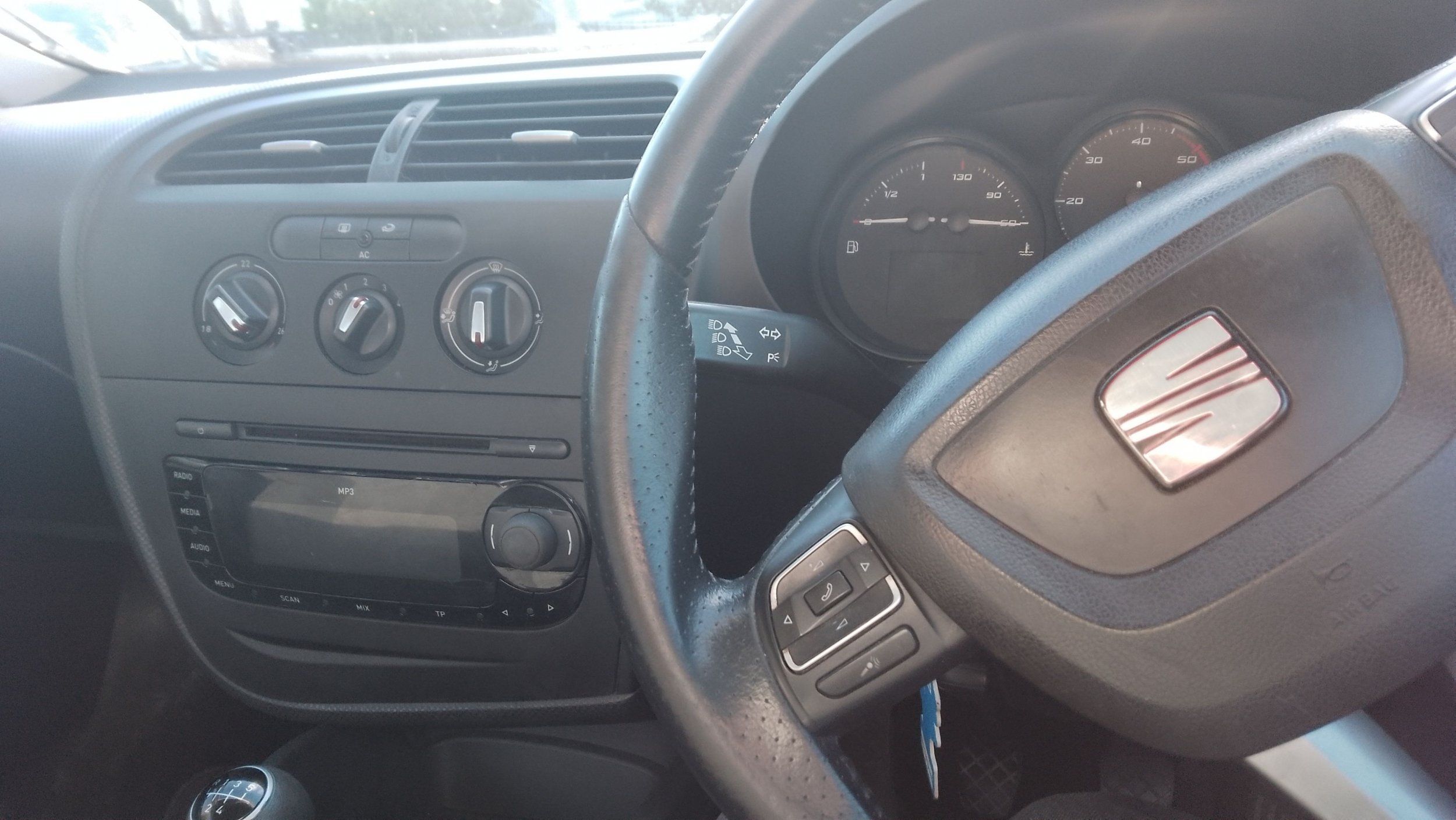

It's not the one with the card reader. And as I mentioned neither this nor the Android unit are powering up. Despite power coming to the quad lock.
