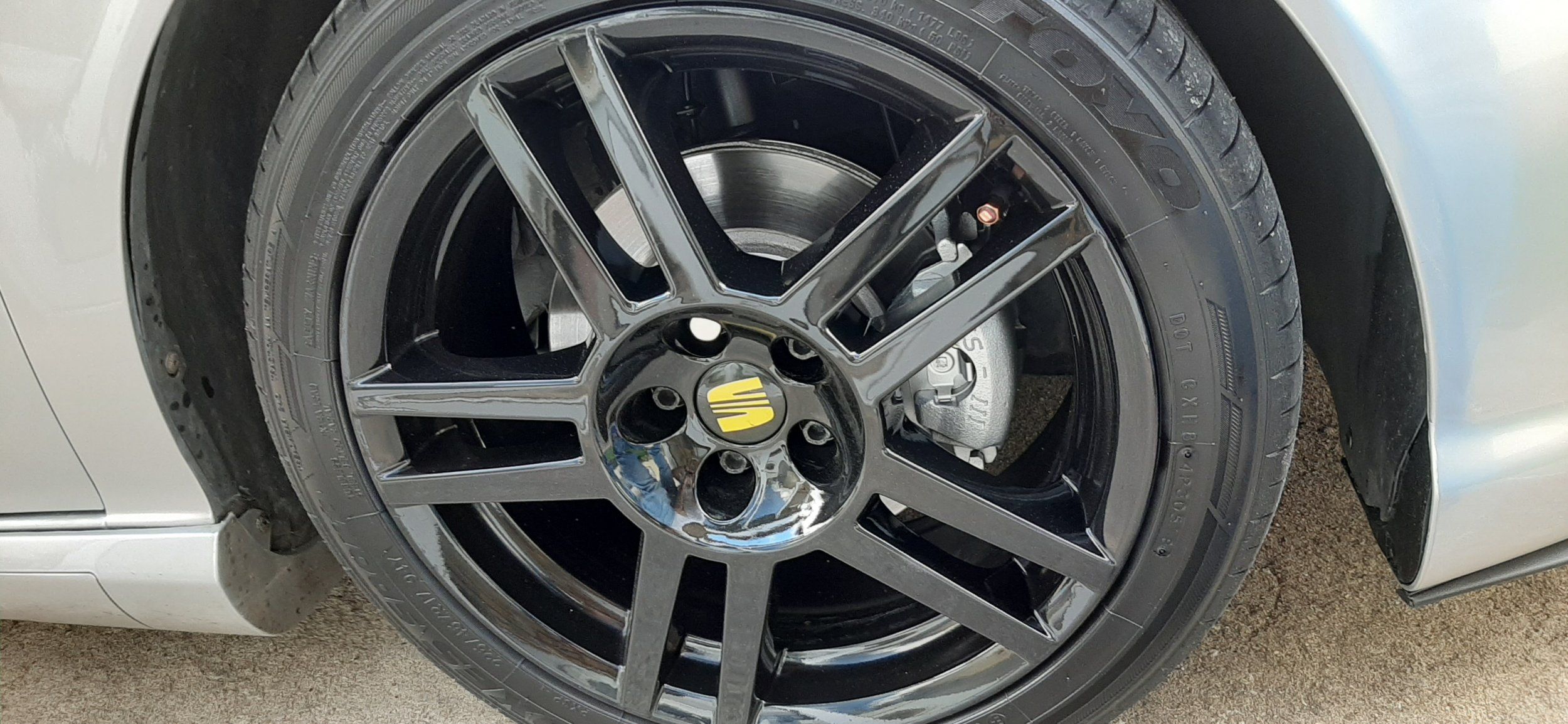

Hi everyone,
I am looking to replace my current wheel center cap and I dont know the current size. The wheel is a “lcr” 17”

If it's from a Leon Cupra R then it'll be a 18" Ronal alloy wheel.
The late mk1 FR+ came with a 17" version which is what you have here.
The centre caps are 56mm and readily available on eBay etc

I have seen other posts in this forum and some say 55mm, either way 55 or 56 both do the job or not ?
i though lcr had 17 and 18, whats the “codename” for mine then ? 🤔

55mm is too loose.
The LCR only ever received 18" alloy wheels In the UK.
I've seen European released vehicles with 17" wheels but these ones also missed out on the 323mm Brembo front brakes.
No idea in regards if a "codename" but both sizes were manufactured by Ronal.

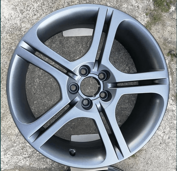

Sorry to "steal" the thread. I have similar problem. I bought the wheels of an Ibiza Cupra 6L (17") to put on my 6F Ibiza.
I went to a guy today that used a specific tool to measure the center wheel hole and he measured 62mm (outside) an 60mm (inside) diameters.
This is the wheels I bought.
Does anyone knows the correct measure for the center caps? And also confirm this is an Ibiza Cupra 6L wheel?
