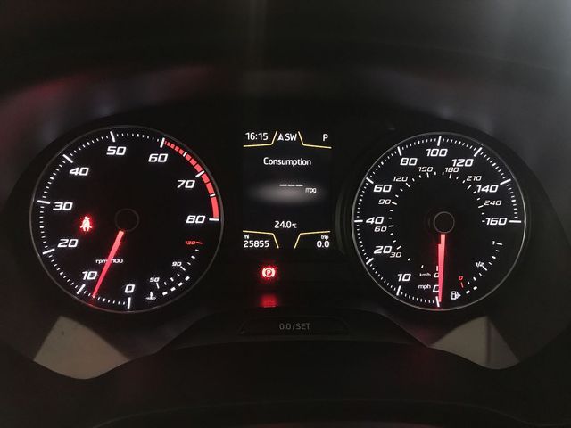

(The rev counter and speedo are analogue while engine temp and fuel guage are digital. The DIS doesn’t look like the one in the photo, not sure if it’s facelift or not - how do I tell?)

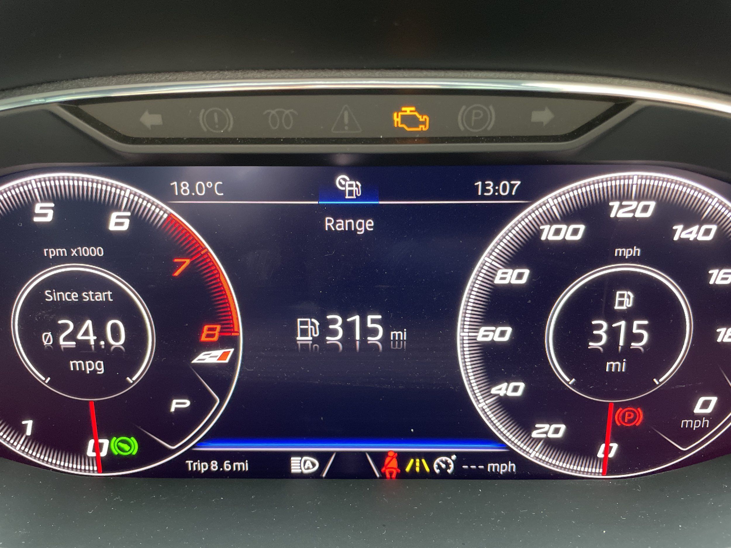

In terms of the range display, it will not be possible to put it in one of the corners of the DIS. It will display in a similar fashion to the photo I posted (I have a digital dash which is obviously more customisable than the analogue dash - eg range is displayed in the speedo on the RHS of the dash).
Easiest way to tell if the car is pre-FL or FL is to look at the front lights (if LED). Pre-FL there is a separate LED indicator bulb. On the FL cars, the daytime running light switches to orange when the indicator is activated.
Apr 25, 2022
It looks like this
I think the indicator repeats in place of the drl. The car has the radar on the front grille and larger centre but dash is as above do not sure if FL
