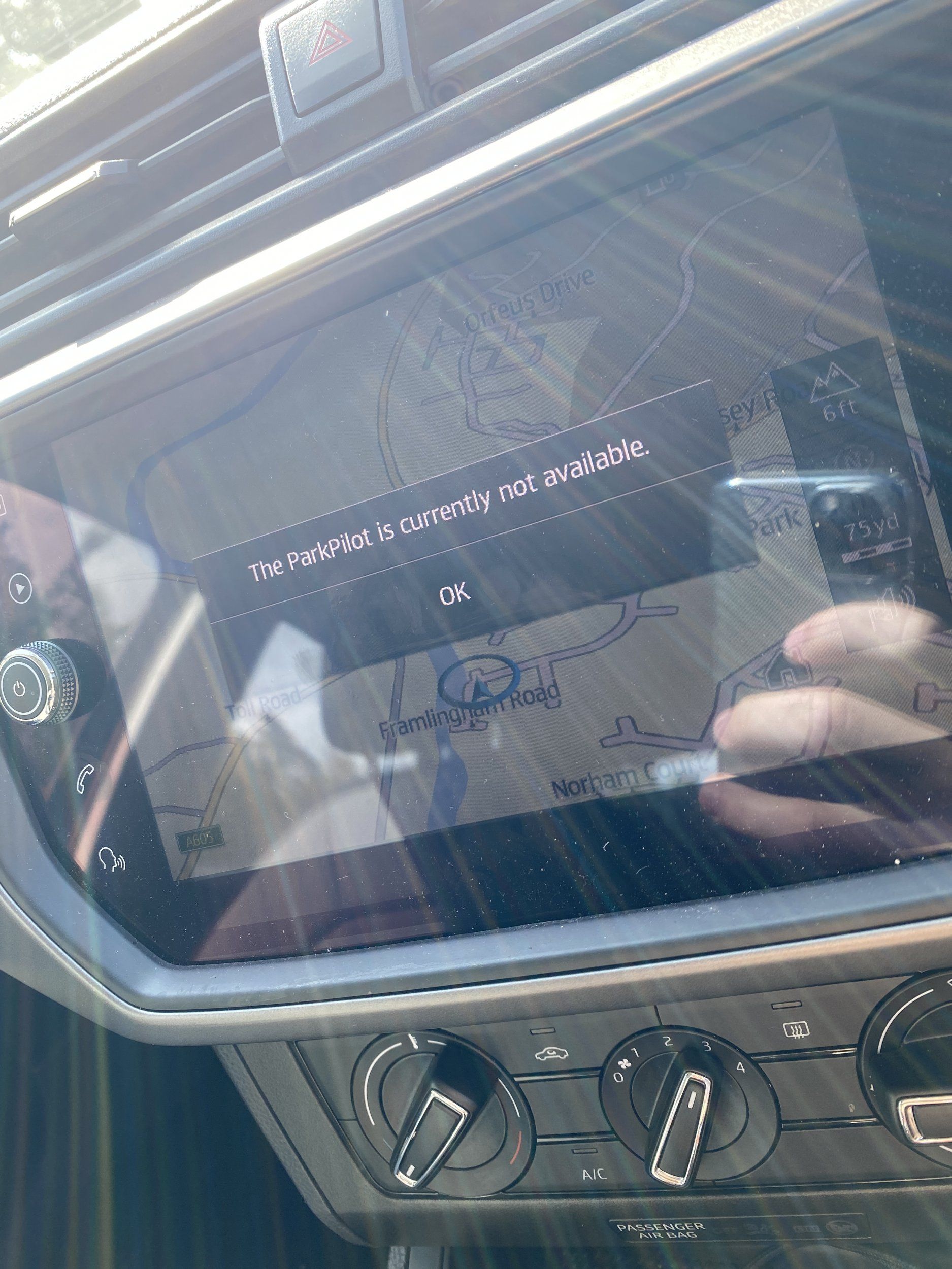

After a successful install of a RVC to my 2019 Seat Ibiza 6F, I have this error on screen after deselecting reverse:
"The ParkPilot is currently not available"
I assume this is because the power to the rear camera disconnects after taking out of reverse due to being powered by the reverse light.
I am hoping there is a VCDS coding tweak that can be made to prevent this message appearing, rather than having to move the camera to a permanent 12V source?
I do not have sensors installed to the car, just the camera.
I would really appreciate your expertise in this field.
Regards
Harry
