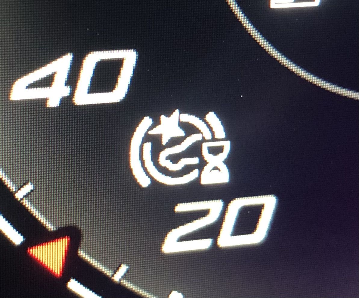

This warning symbol came on recently, can’t find it in the manual. It was orange when it first came on and the standard warning light (exclamation mark in a triangle) came on at the same time. Now whenever I start the car the symbol comes on in white for a few minutes.

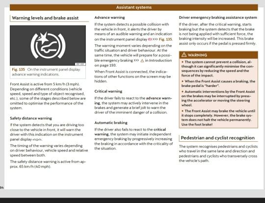

Thank you for finding that. Strange though as it happened when I was driving at night and there were no other cars on the road. Also strange that it comes on now every time I start the car, but with an hourglass next to it too?
Apr 17, 2024
12
I’ve found that the symbol comes up with the hourglass on startup as it’s calibrating. And I suppose the brake assist/collision warning randomly when driving is just one of those things, something similar used to happen in my old car too, Mercedes A-class, always thought I was about to hit pedestrians that were on the pavement.
