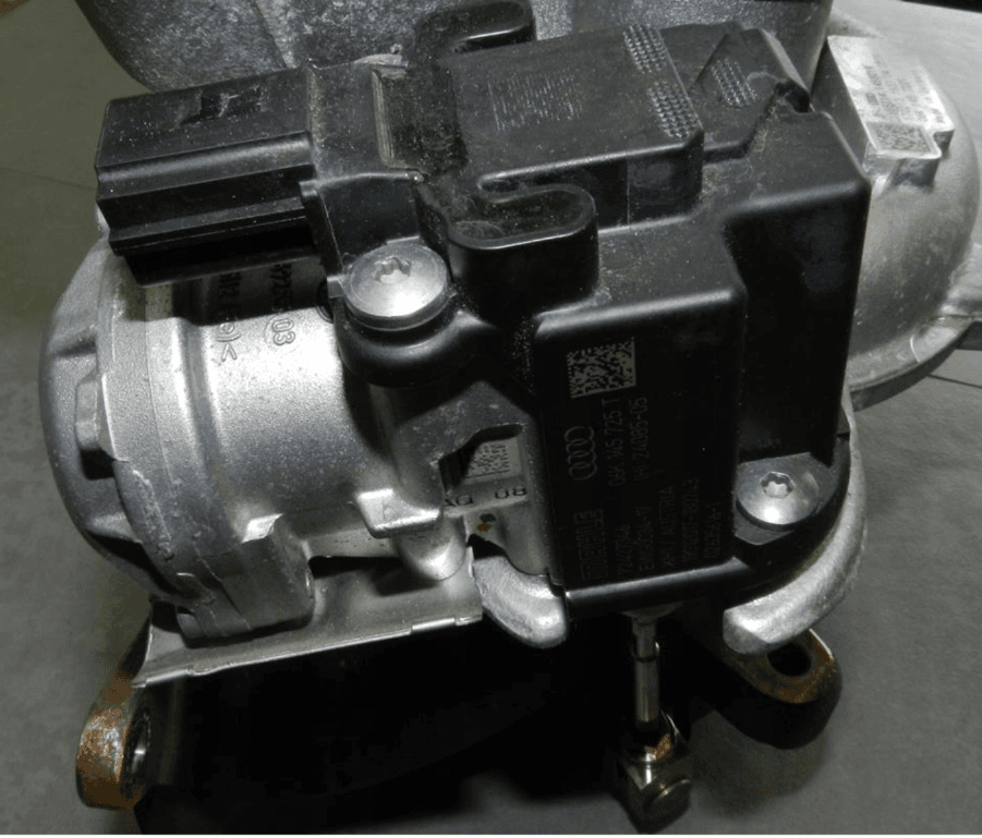

The turbo is an IS38. Assuming the fault is the actuator and not a worn/sticking actuator arm & flap in the turbo body then this can be replaced without needing a full turbo swap.
However, it may also be worthwhile putting your existing wastegate through a test to see if it is out of adjustment. You'll need VCDS or possibly OBD Eleven if it does the test.
Did the garage who did the diagnosis do this test or have simply reported the OBD code fault and bigged up the job as a turbo swap?

06k145725T is the actuator (servo motor) OEM part number.
Make sure your pivot and flap are free and not seized/stiff. If they are use some high temp grease.
Seat and Audi don't list it separately - but VW do - strange!
Mahle make the OEM part Mahle number - 72427347 - you may find that 50 quid cheaper for the same part.

Had the same in a bmw 120d. You need to establish if the actuator is faulty or just the turbo vanes sticking. I managed to disconnect the actuator arm gave the turbo vanes a good cycle over by hand and it ran like a champ for two years and then I sold it, was still working perfectly.
Ps you could hear wh3n starting the car the actuator does a full cycle of the acctuator /vanes to check it works correctly. I could hear the actuator binding and that's what lead me to the sticky vanes.

Could also be out of adjustment this can be checked via vcds it should be around 3.5-3.7v when static I believe.

Our former Golf 7 TSI, engine EA211 (not IS38), which I sold to a close friend 5 years ago, started to act the same way a couple of months ago.
First EPC light on, then going into limp mode. After restart it worked as usal.... He works at a garage. After some investigation they replaced the actuator servo motor. Rather cheap operation, say about 180-250 EUR for the spare part.
This solved the problem.

I had a problem around 4 months ago with a fault code 15202 turbo actuator sticking and a EPC light on the dash. This would only come up when the car was cold and when the turbo was coming on boost for the first time. If the code was reset it wouldn’t appear again until car was stopped and cold again. No lost of power etc when the fault was up.
Took car to my local independent who did a re adaption on the actuator. This didnt work as fault code came back Pretty much straight away after the re adaptation.
He suggested spraying WD40 around the rod of the actuator and the pin thats attached to the waste gate flap. I also changed the air filter as found it pretty dirty when inspected.
After doing both of the above the fault never came back.
Whether it was the WD40 on the actuator rod or the changing of the air filter I can’t be certain but it worked for me.
I was careful with spraying WD40 around the actuator, as when the turbo starts to get hot it smokes like a steam train.
So I would say just don’t go mad with the can of WD40.
The reason for the air filter change was I wondered if the turbo was being starved of air, which the ecu thought was an actuator fault and flashing up a fault but it was actually a choked air filter.
You can PM me if you like and can run you through in more detail what I did.
