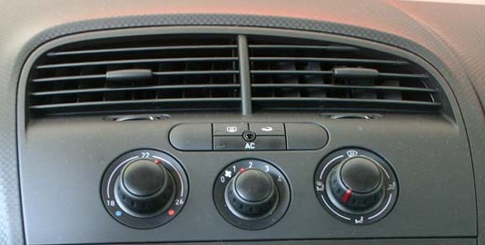

With the semi automatic aircon (3 knobs) there should be a pre-resistor sitting under the glove department, where an additional cover must be removed to show a white(?) plug (flat contact housing, connecting part, series resistor, 4 pin, replacement part was ~30€ some years ago).

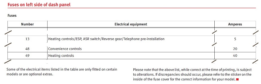

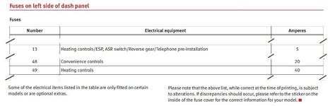

You might check whether one of the heated washer jets burnt through (odor sample), plus make sure the fuse #13 (5 Amp. on left side of dash panel) is ok.

To make sure we're talking about the same aircon version, this is the one that holds a pre-resisitor:
