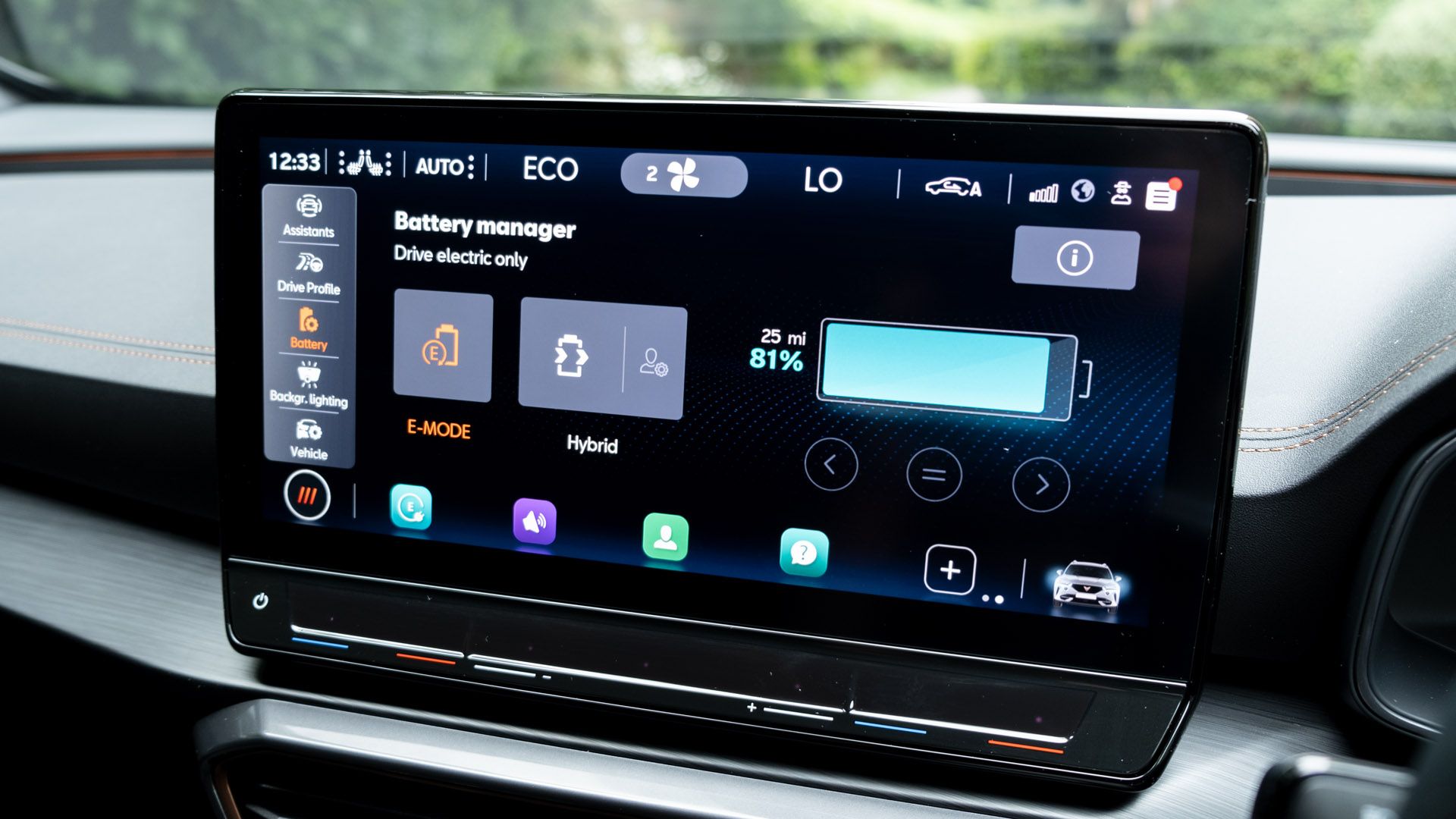

If you ran out of battery, the car will try to charge it to at least a 5%, mostly when cruising. So the engine needs to work to move the car and at the same time charge the battery.
The best way I found around was to set a minimum of 20% battery when I´m low on battery and not going home yet. that leaves the car a buffer there to use electric when driving slow and try to charge the battery back to 20% slowly when driving faster. But if you let it go to 1% is going to try to charge the battery back as fast as possible using a lot of petrol for it.

What’s this witchcraft? Where can you set the minimum battery?!

Oh sorry I misunderstood. I thought you meant there was a setting to set it so it never goes below 20%. I constantly manage through that menu. It’s quite tiring.
