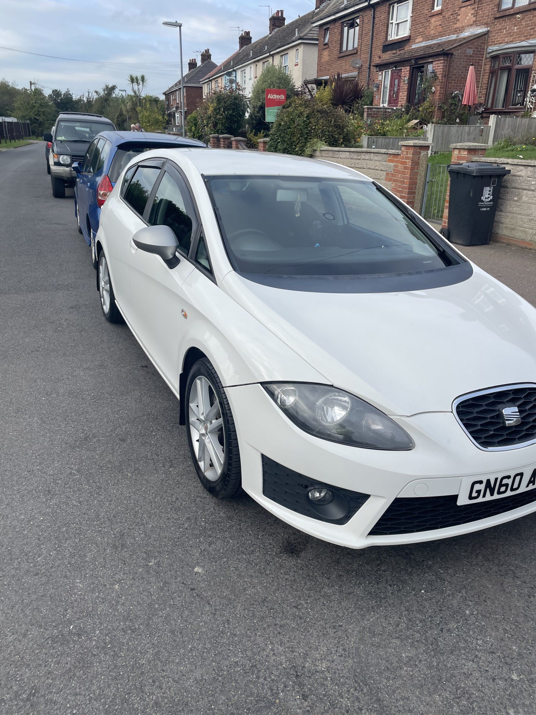

Hi all , what are the screws holding the front bumper on to the wings ? Neither side has any in so unable to go by either side.
Previous owner was an animal with the car and never looked after it.
Any help would be appreciated very much…
Genuine VW Audi 25x Wheel Arch Undertray Interior M5x16 Coarse Thread Screws N90974701. 25x N90974701 - M5x16 Screws (supersedes N91160401). They are commonly found fixing the wheel arch liners, undertray and also in various interior trim panel fixings.
www.ebay.co.uk
You need to take a look to see if the retaining clips for the screws are still in place otherwise there won’t be anything to screw into.
