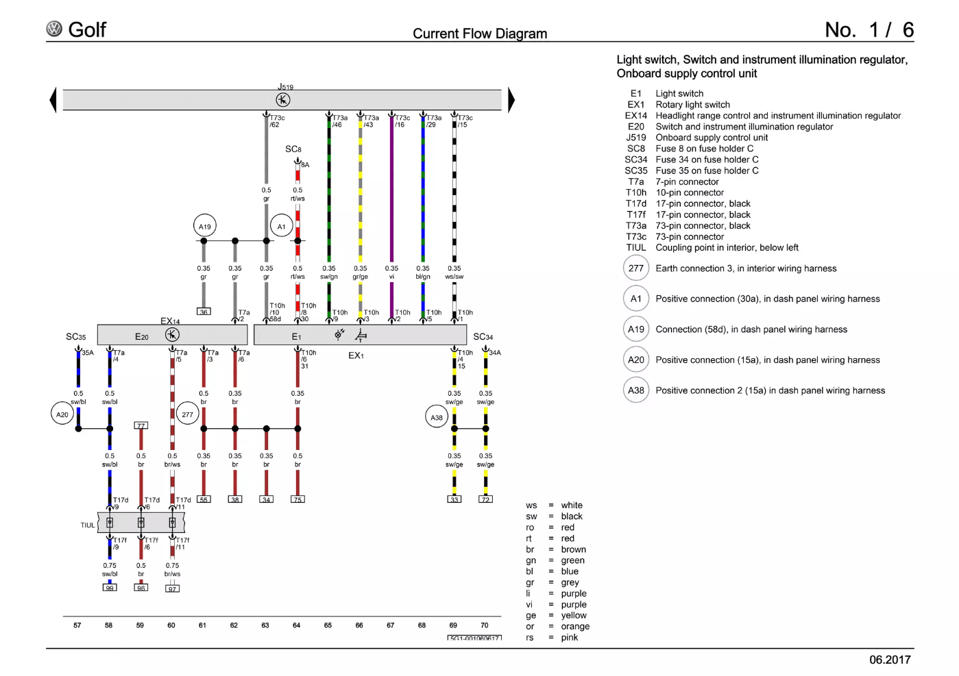

The image below is from a document for Golf Mk7, dated 2017, showing electrical diagrams.
It should be most likely the same for Leon 5F.
The rotary light switch is identified as EX1 and the diagram shows that there are two positive wires:
One on pin number 4, colored black-yellow, connected to fuse SC34, 15a.
The other is on pin number 8, colored red-white, connected to fuse SC8, 30a.
Please make sure all the other cable colors & pin positions shown here match to the cable colors & pin positions on your rotary light switch before doing anything, just to be sure that this diagram is valid also for Leon 5F.
