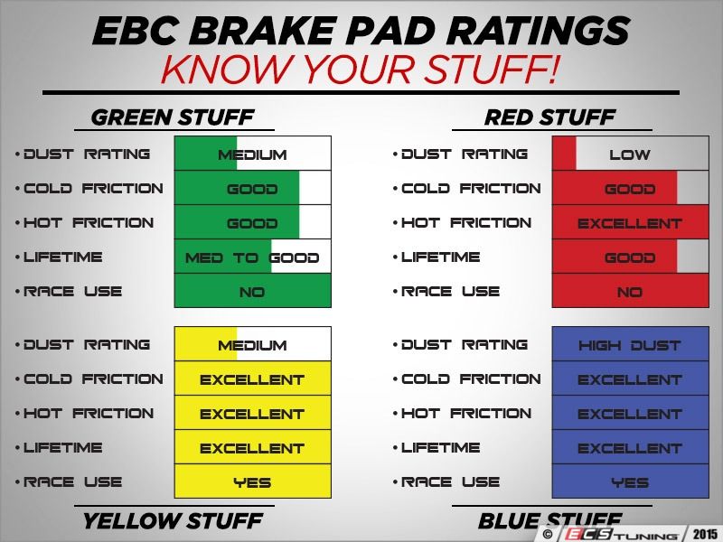

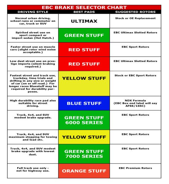

I can vouch for EBC 👍🏼 I’ve had Bluestuff, but Redstuff would be best for you, no?
Here's some comparision tablesof the different EBC pads, I think I was a but put off by the Blue Stuff pads because they produce a lot of dust and I don't want to be having to clean my alloys all the time. The downside with the Red Stuff pads is that they require more warm-up time for optimal performance, which I guess could be an issue for shorter journeys, especially in winter. Yellow stuff pads (from what I've read) are harsh on the rotors (especially if I stay with the stock ones), so could wear them out quickly.
