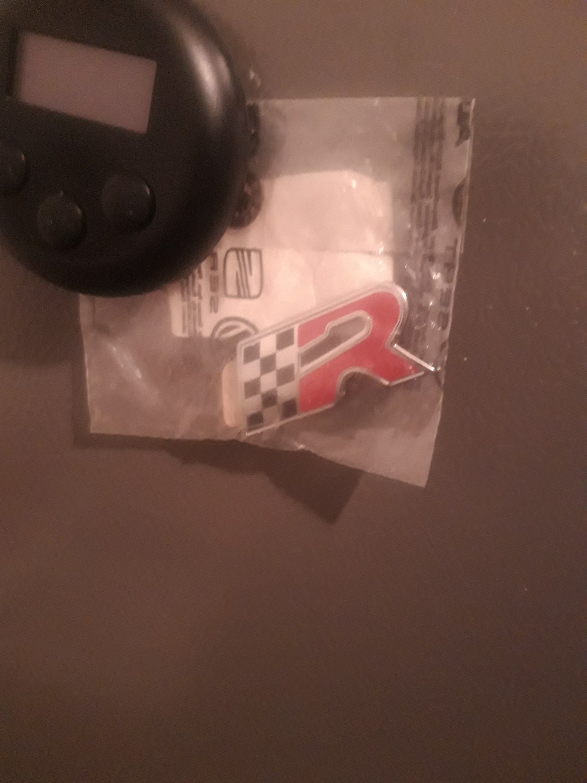

I bought a pair of front wing R badges im may last year off of Ebay. Im going to check mine tomorrow.
Also won an oe one from ebay recently for the boot. Still in its bag, stuck to the side of my fridge at the moment with a magnet.
