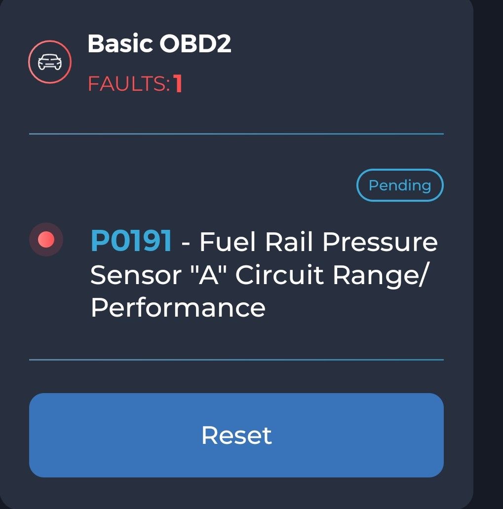

I had similar issues with my 184 a few weeks ago but got code P0191 and replaced the sensor. It seems to have solved it for me though.
Sounds like yours is more wiring related and I don't know what to suggest. Hope you get it sorted.

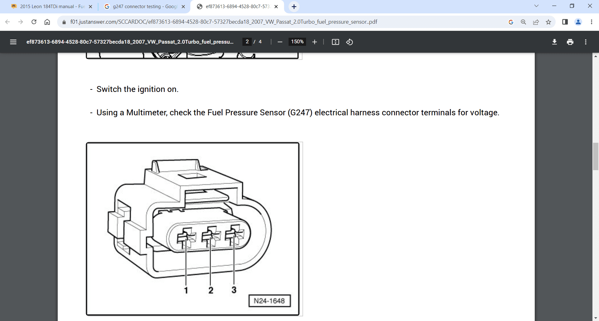

Cheers for the suggestion.
Just for clarity - can you confirm which way the pins are numbered ?
The diagrams on line show this :
BUT
The connector on the car has 1 and 3 the opposite way.
BUT
I don't have a connector diagram.
I would follow the labeled numbers on the actual connector.
Voltage should be checked between the pin and an earth - not the battery positive.
