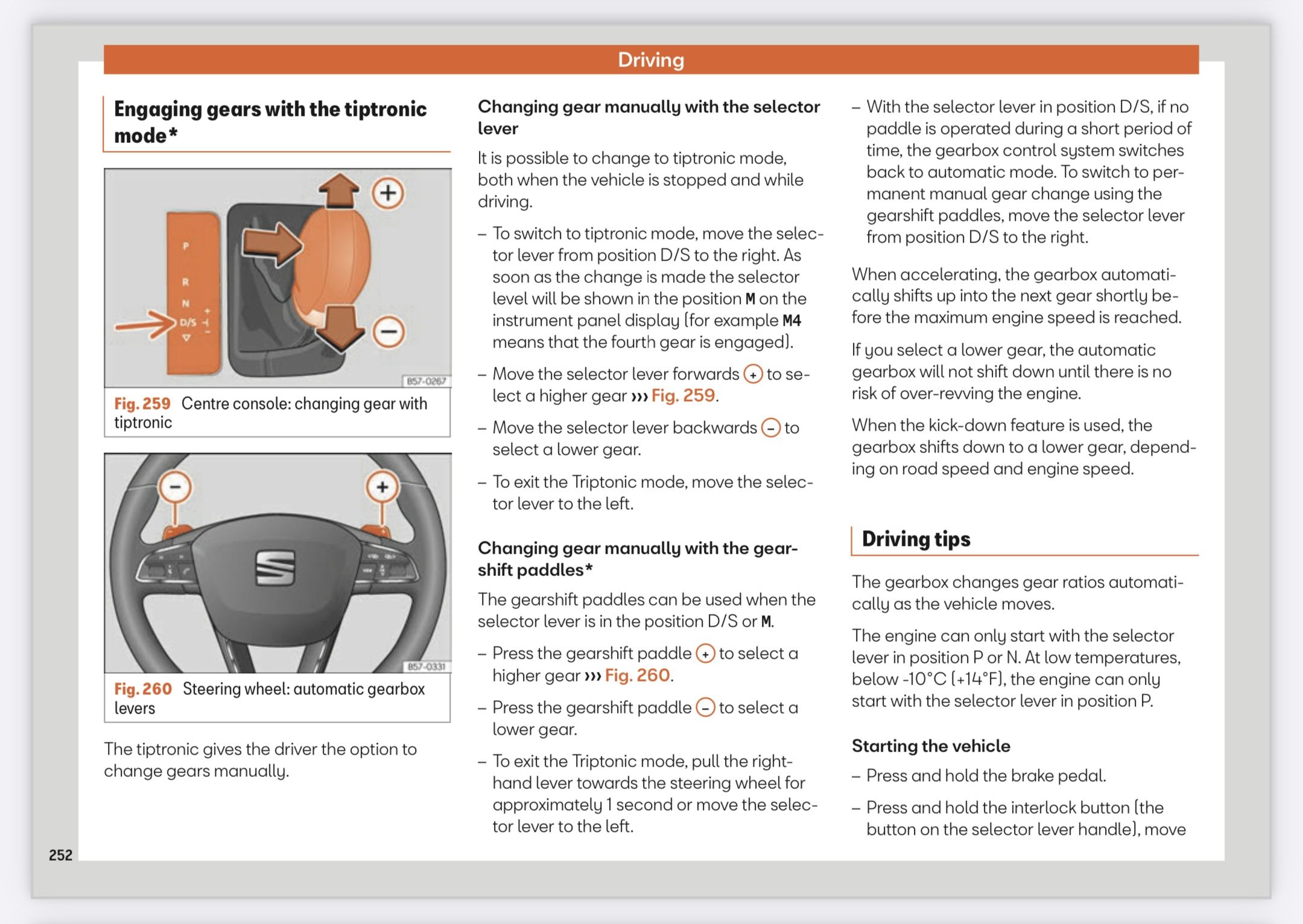

I think it’s unlikely the GPF is blocked on your car - from what you’ve described (engine fan running after switching off the engine and high fuel consumption), the car’s attempting to carry out a forced regeneration which will happen when the soot level in the GPF reaches a predetermined level. If you become aware a regeneration is in progress towards the end of your journey, if possible, IMHO it’s best to continue driving until the regeneration has finished (admittedly, it might not always be possible to do this) so your car doesn’t go into regeneration mode at the start of the next journey.
The DSG does have a tendency to change up gears early as Seat / VAG will have programmed it with emissions and economy in mind. However, you can use manual mode to override this characteristic - either by using the the steering wheel mounted gear selector paddles (if your car has these) or by moving the gear selector lever over to the left and then moving the lever backwards towards the minus symbol to select a lower gear or forwards towards the plus symbol for higher gears. Returning the selector lever back to the right puts the transmission back to full auto mode. Screenshot below is of page 252 from the Nov 2018 edition of the Leon owners manual (if your manual is a different edition, it might be a different page number);
