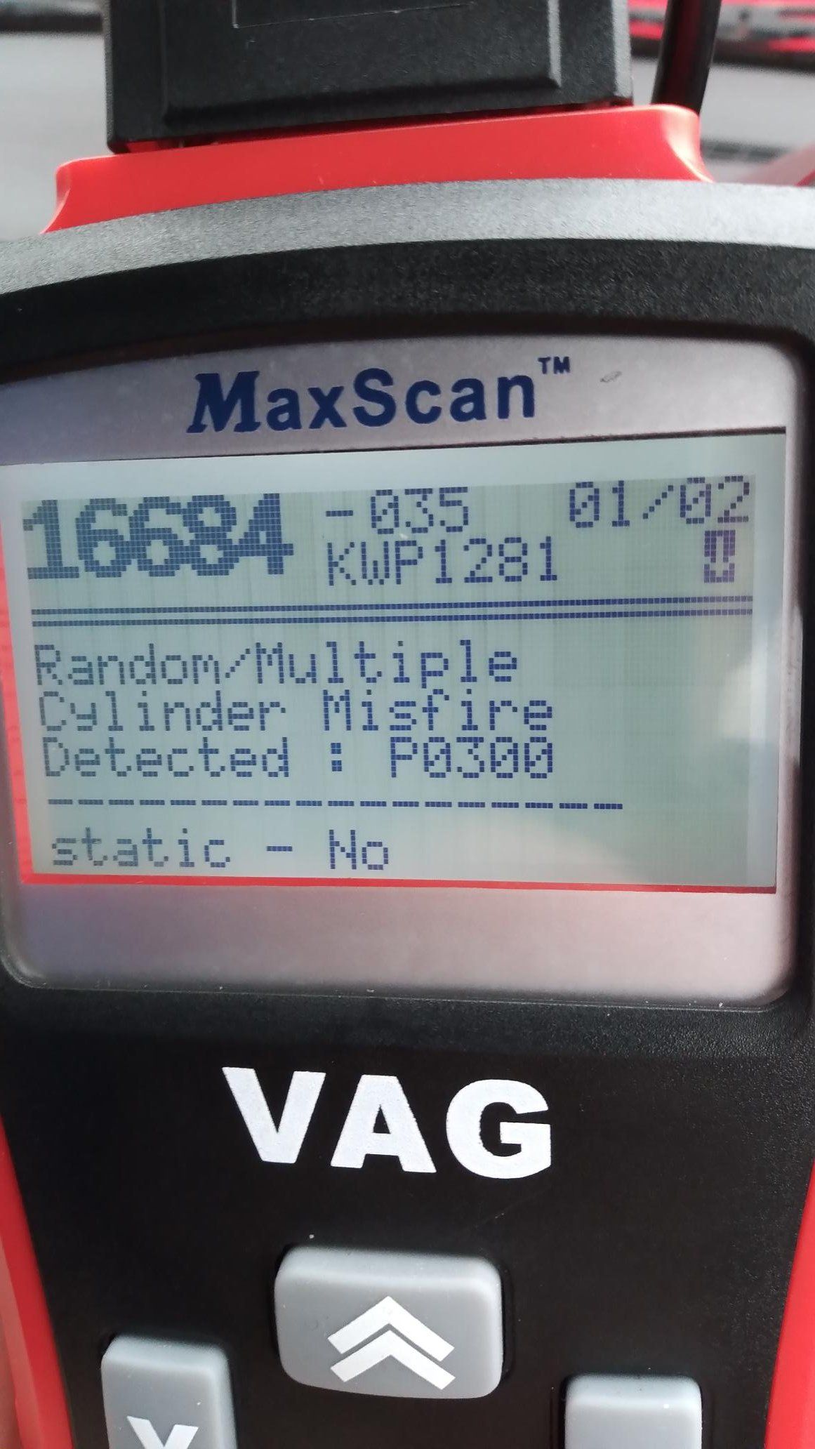

We were coming to the end of a 50 mile mixed drive in appalling weather with loads of surface water when suddenly I felt her hesitate, shortly followed by the yellow ignition light flashing on.
Went away and came back several times especially when I asked for extra power.

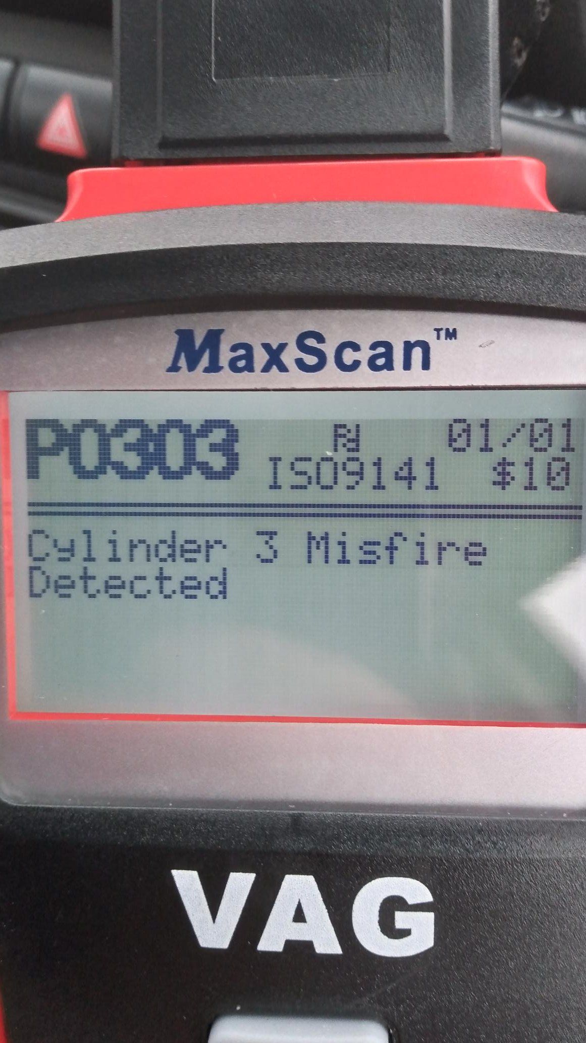

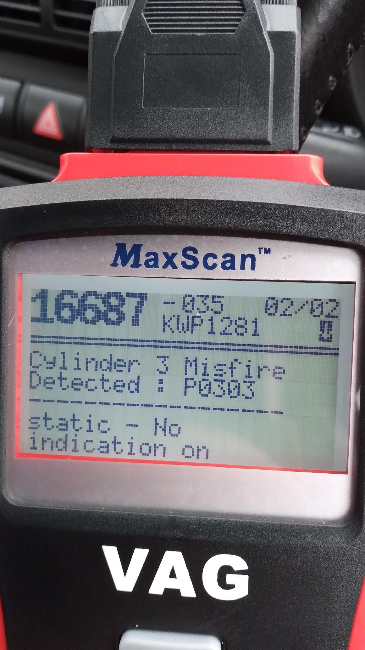

Scanned her with my reader to find the attached misfire error codes.

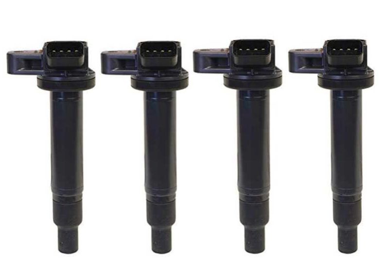

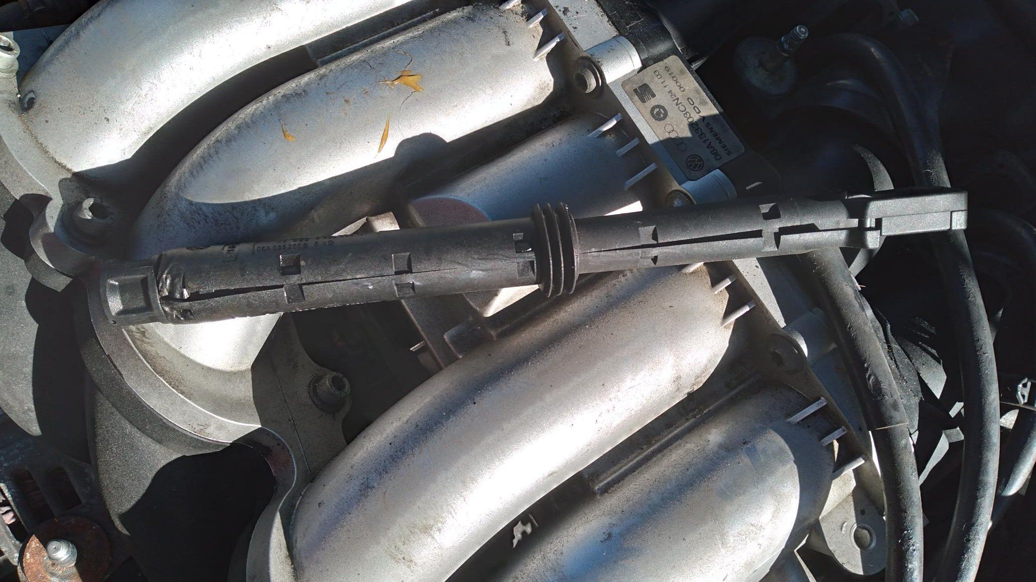

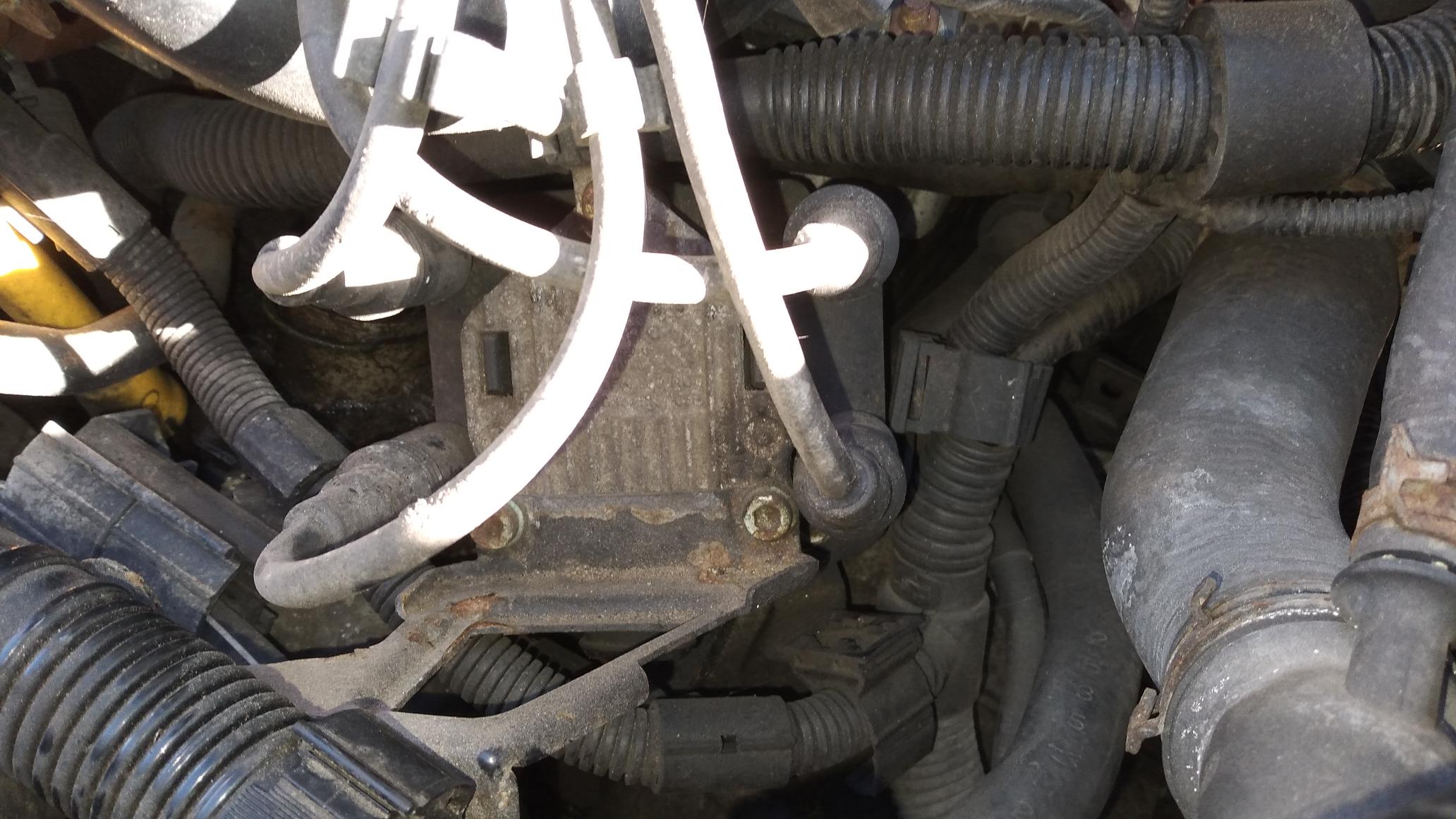

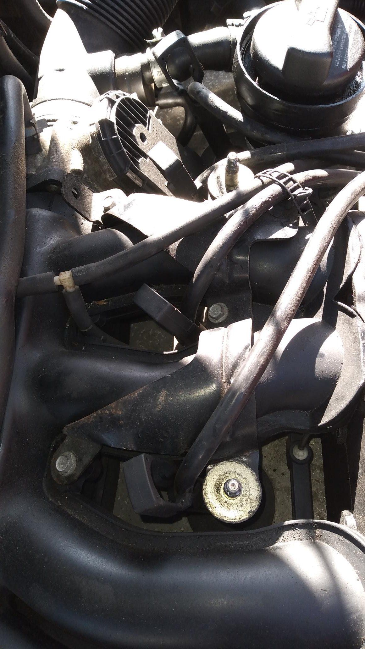

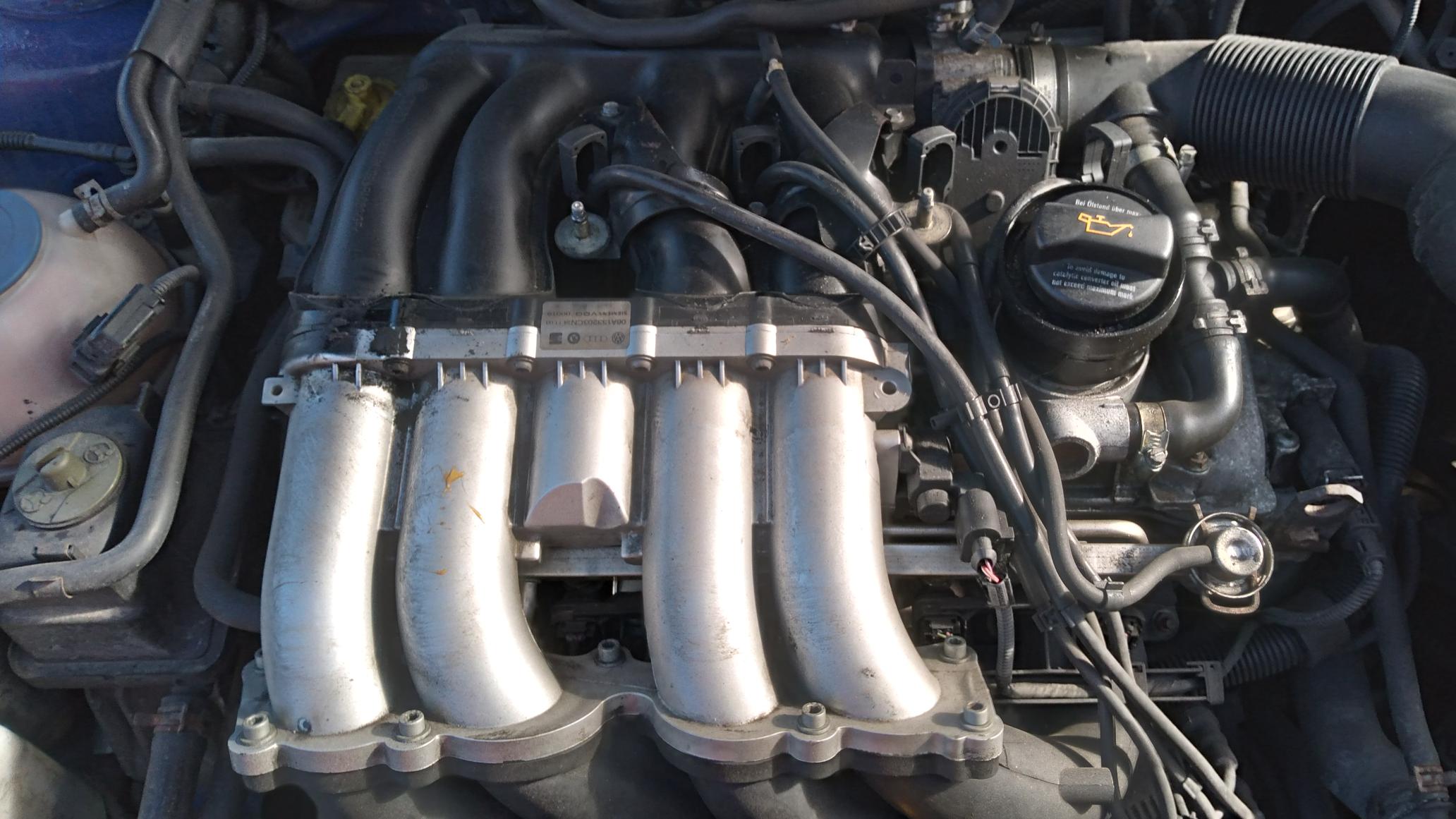

Today I took the plastic engine cover off and found my coil packs don’t look like I was expecting, mine have a very helpful little plastic loop to aid in withdrawal.
I took out cylinder three’s and cleaned out the socket and plug.
Put everything back and have just come back from a good run in which she behaved faultlessly.

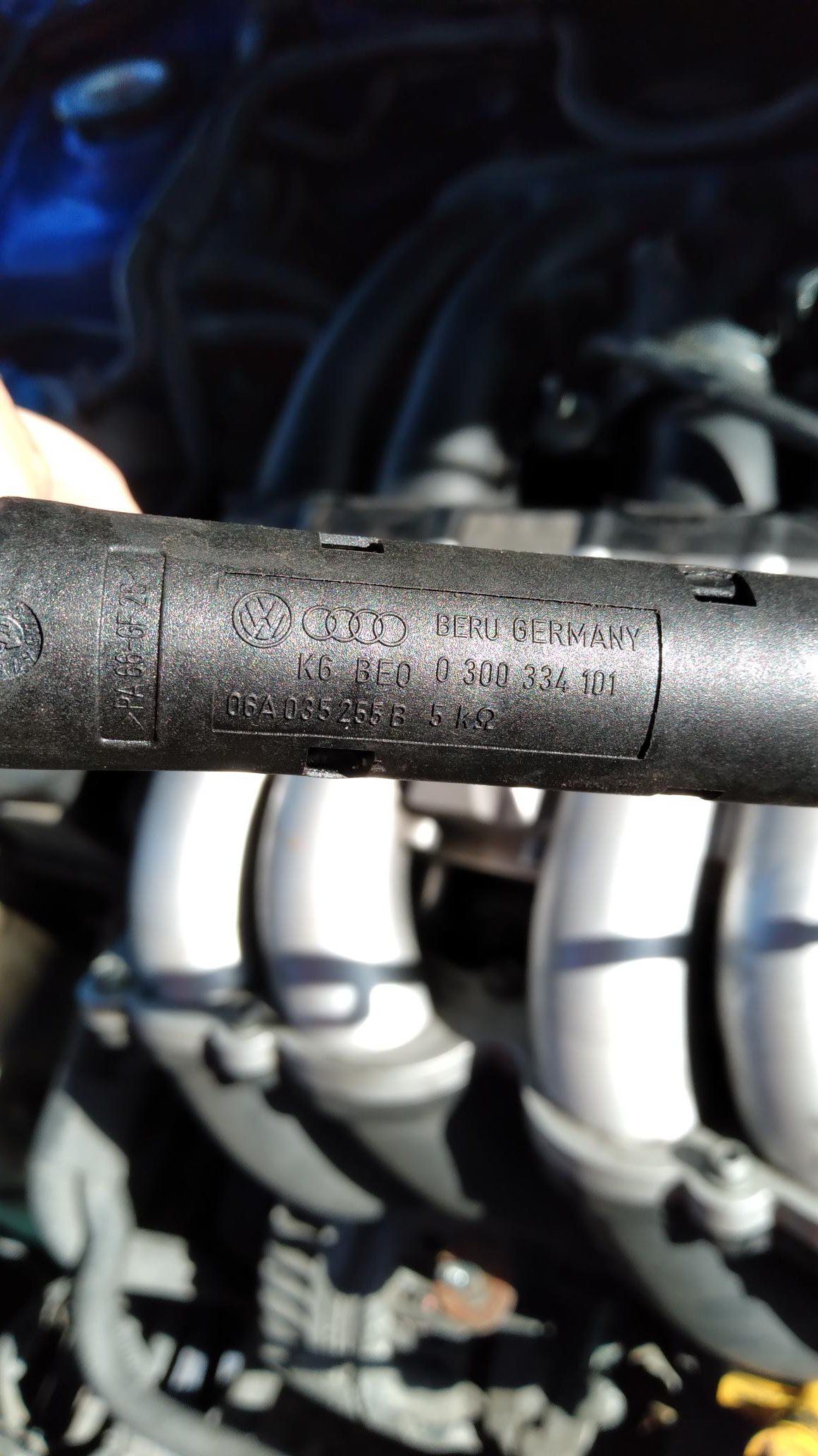

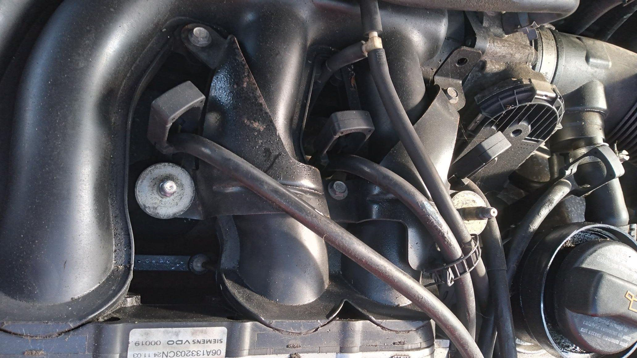

Also, is this the distributer? (pic 7)
So what am I looking at here guys, feels like water related to me but if so what?
