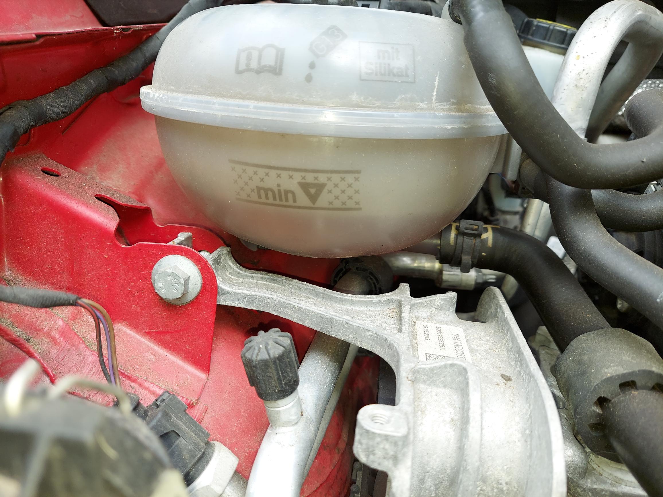

got this pop up when i scanned wth vcds
looking at the coolant tank it is below the line
is this simply a sensor fault or just low or something else going on leak etc
i have a bottle of g12 plus plus can i use this instead of g13 ?

On the question concerning is G12++ okay to use with G13, I'd say yes - okay the overall system protection will have been dropped slightly towards the G12++ protection level from the supposedly improved G13 protection, though mainly, I think, G13 was very similar to G12++, just manufactured in a slightly more environmentally friendly way.
Maybe if you solve this sensor issue, by replacing it if it keeps on repeating logging that fault, then it will be time to consider dropping out the entire load of G13 and refill with G12evo.
Edit:- oh, and get rid of the "mit silikat" either by removing the pouch if that is inside the tank, or get a new reservoir without that stuff, when you change to G12evo!

topped it up but fault remains. i noticed the coolant bottle sensor wire loom plug was wet inside when i took it off and a bit corroded.
would this create the same fault though ? or is my water pump on the way out , it`s such a low mileage car though

after weeks of messing about with this, turned out it was the thermostat housing water pump that needed replacement. luckily i found a brand new INA one on ebay so bought that and took it to a vag specialist to fit hopefully i will have no further issues with this, the quoted prices are shocking really considering its some moulded plastic and an impeller.
