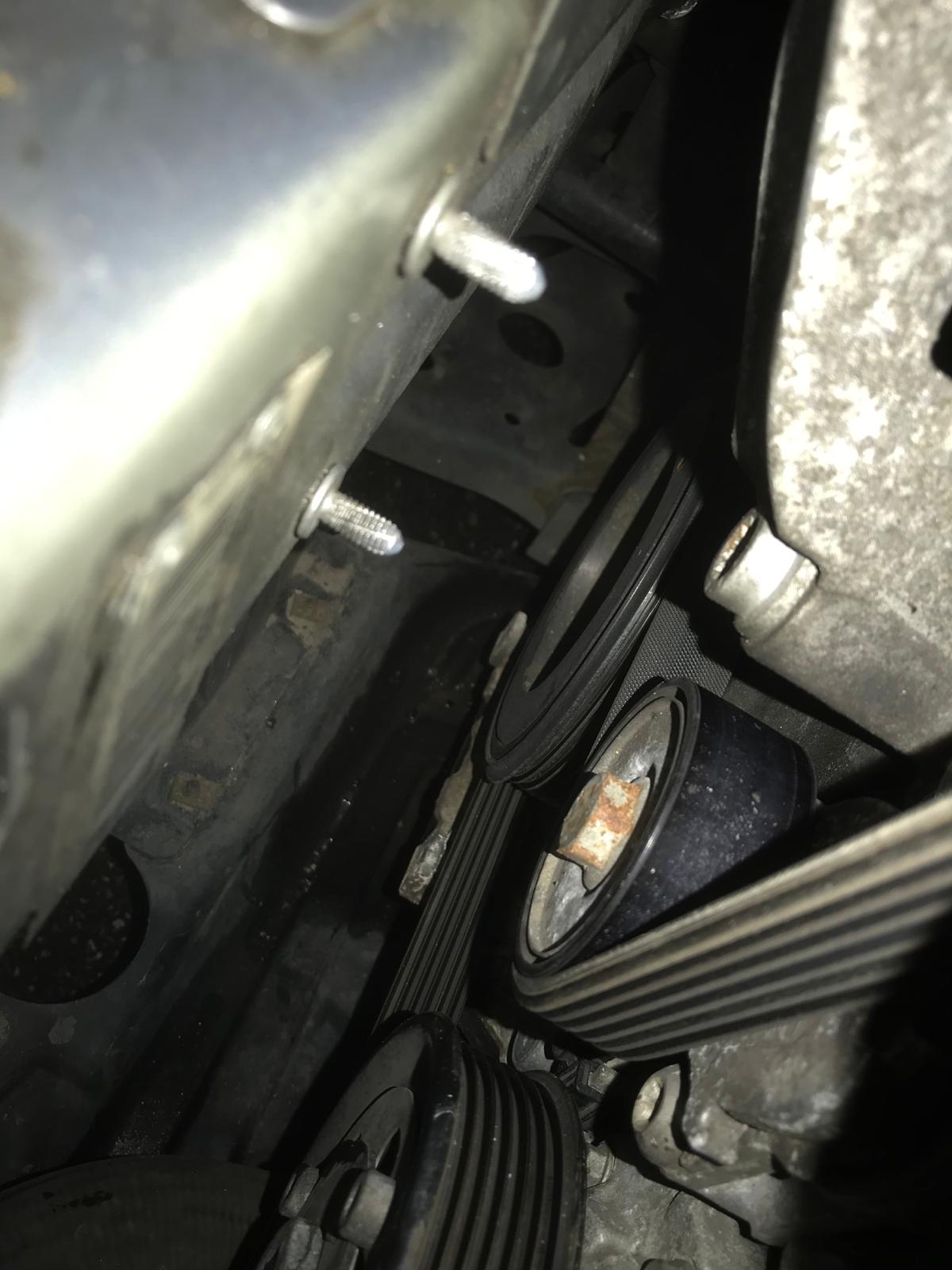

checked hoses and all tight.Car not making any strange noises or erratic engine issues. There is a pool of lIquid on the protector tray - see below. I was out last night and the roads here were very wet so not sure if it’s just that. Ok I’ll search on here to see if there’s a thread on how to change thermostat so can start to narrow it down. I agree that it is unlikely to be the coolant silica bag removal but I never had a warning light throw when it was in- probably coincidence.

The wet part in your pic i guess is water comming from the wheel arch or the front /rain?.
This happened to us two times, once for a Golf R mk 7 and once for my sons Leon Cupra 2019. The unit was replaced on both cars. Covered by the machine insurance.
I was also thinking the same just water maybe as he said it was wet outside so puddles and stuff will do that. To OP: have another look in the morning see if it is still there, and if it is then dip your finger in or put a tissue on the end of a stick and dip it down then you’ll be able to identify the liquid itself :)
