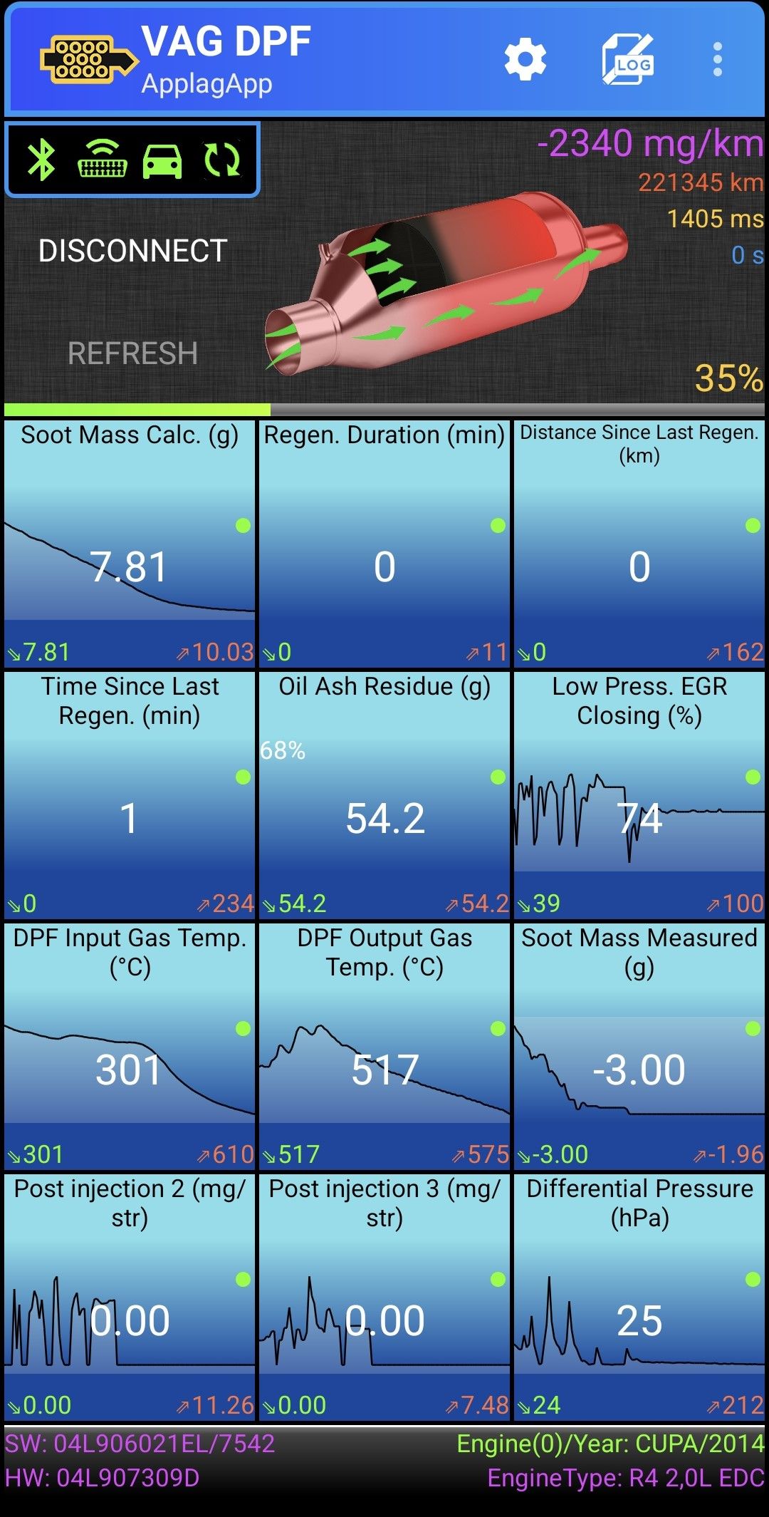

Mar 5, 2024
Thanks for the additional advice, will bare in mind for when issue occurs again.
I have also downloaded the VAG DPF app. I read a previous thread which you posted regarding the Carista and VAG DPF app, great bit of kit.
Here is my DPF results from this afternoon. Reading the threads, I take it 31% on the Oil Ash Residue isn't all that bad?

BillyCool
Jan 16, 2020
655
249
Leicestershire, UK
Looks good to me. You'll see from mine that I'm on 137,000 miles and have 54.2g oil ash residue measured at 68%.
It doesn't mean that it runs fine to 99% then gives up. I will start to get blocked, regen sooner and probably need sorting before that.
Mine regens around 100-120 miles with my shorter 7 miles to and from work but on longer drives I can still get 150-180 miles.
Your hPA pressure is also low, which suggests an unobstructed DPF.
