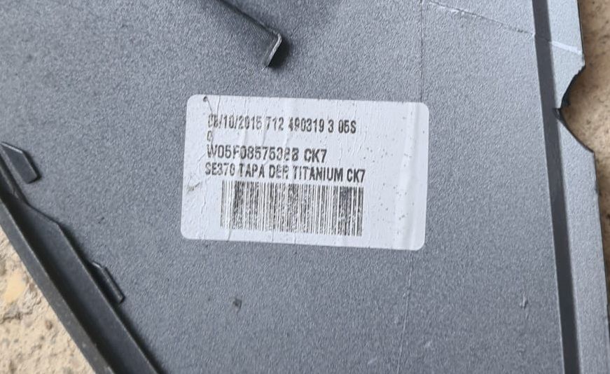

So that's what I see, but what part is the colour code?

Thanks, looks like the guy found it but didn't leave a clue. Someone else said ZH9, but i'm not seeing that anywhere on the photo of the sticker i uploaded.
getting frustrating now haha.
Mar 7, 2023
Titanium CK7 I would say.
I knew i came to the right place! many thanks my friend.
