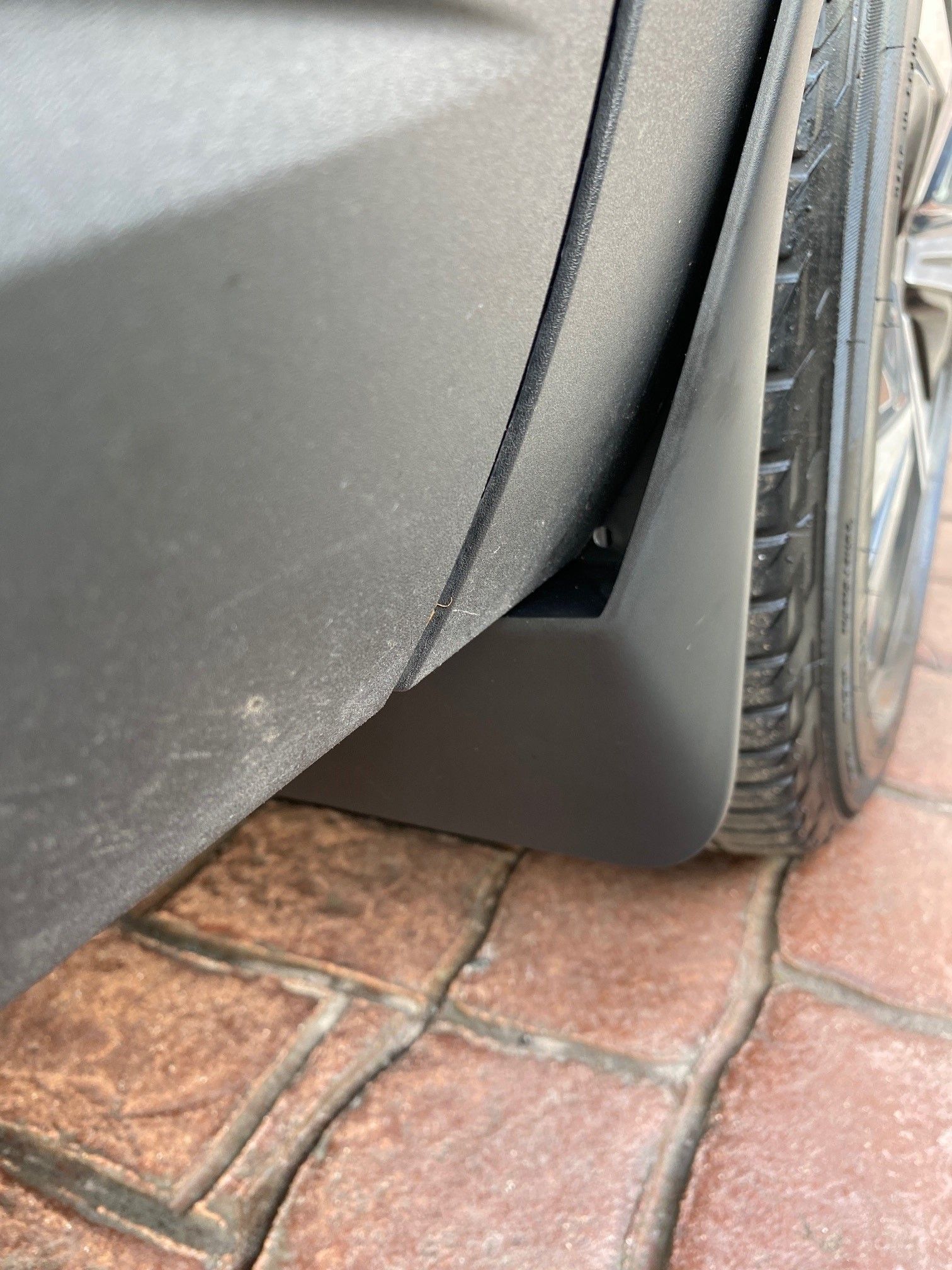

Hi all I'm new to this forum and just purchased a 72 plate Ateca SE Tech from a Seat Main Dealer. I asked them to fit mudflaps to the car ready for when I collect it, when I arrived they said Seat only fit front mudflaps. I noticed that the front mud flaps didn't look a good fit (attached photos) and as I needed to get away and knowing there will be others things needing rectifying I said I'll be in touch once I have had it for a day or two. Has anyone had front mudflaps fitted and does the fitting look like mine fitted by a main dealer.

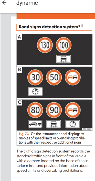

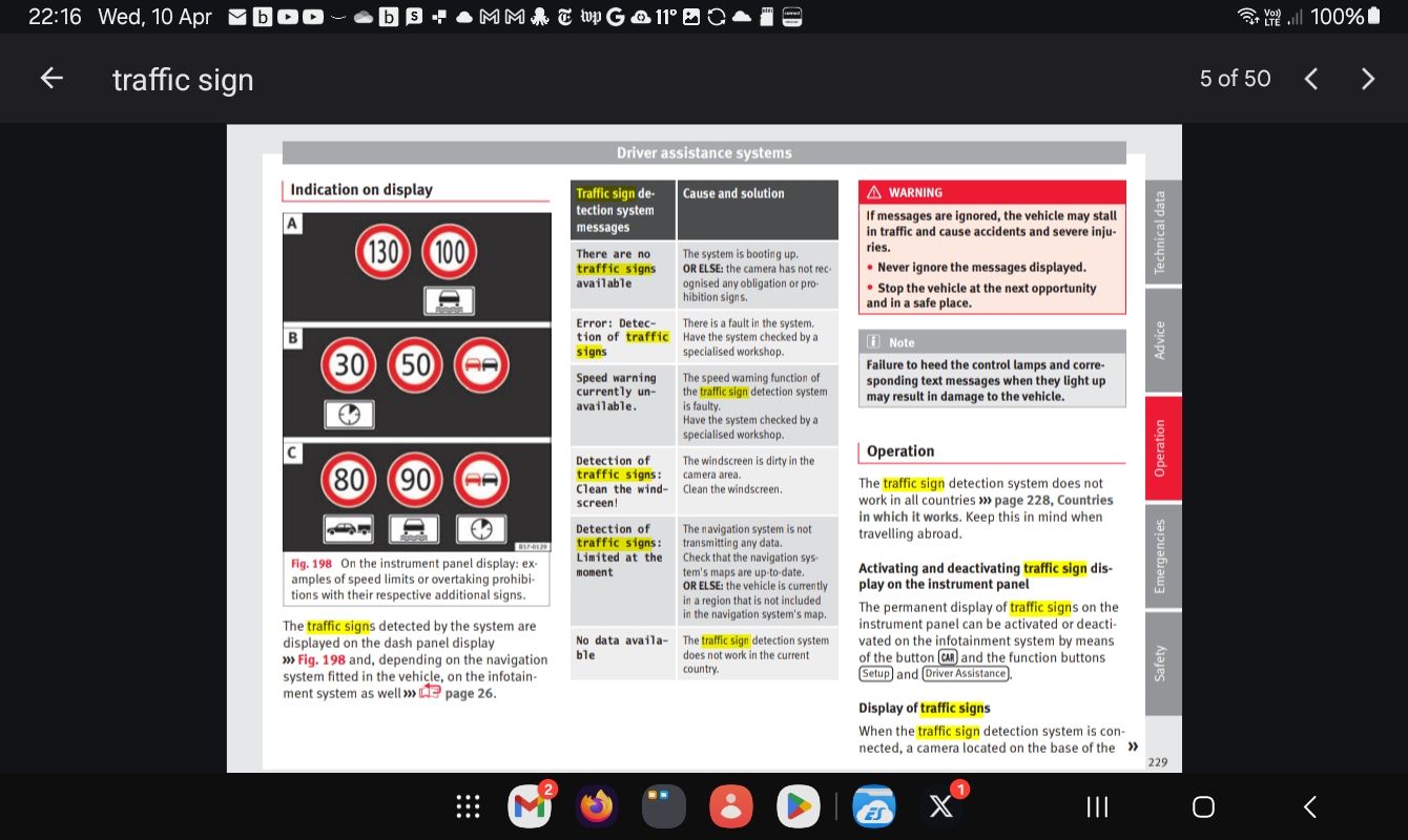

I have enabled TSR with vcds on my 2020 Xperience Lux
seems to work fine but I don't get any other traffic signs! just speed limits
I thought that it was supposed to pick up other traffic signs too?
Reactions: Tell
Tell
Correct.
Suck it and see on these things now as the Vag bin of parts may be more specific. We always got good results on the Ateca, it was people following the coding on other models that found the camera wasn't right.
Traffic signs with speed on them are what it sees. Clever stuff.
The other signs can be shown as two panels. The second one is the option. Seen that in France. Its where the limit has an option. You decide whether it applies to you. You can toggle to see the other sign from memory. I wondered what the overlay was about and the next trip or two twigged.. and mine is a 2017 Ateca.
Ateca manual at time. I paid for the full trimmings. I had everything except the tow bar. They were sold like pizzas 🍕 then... you selected extra topping. Vag then changed how they sold their cars. Stuff on mine you can't buy now 🤣.
Tell
Yes you see it as you get off the ferry on those roads. As I recall the split sign, you see two or more is on the infotainment screen, side by side or you poke it to split out, whilst you just see too rings overlapping the FIS / Virtual screen. You poke the display to get them to split out to see what it's saying on the infotainment, least on mib2. Will be similar on mib3. Took a few visits to work out what the overlapping road sign on FIS meant. Speed change on wet roads on the French / Belgium road.
