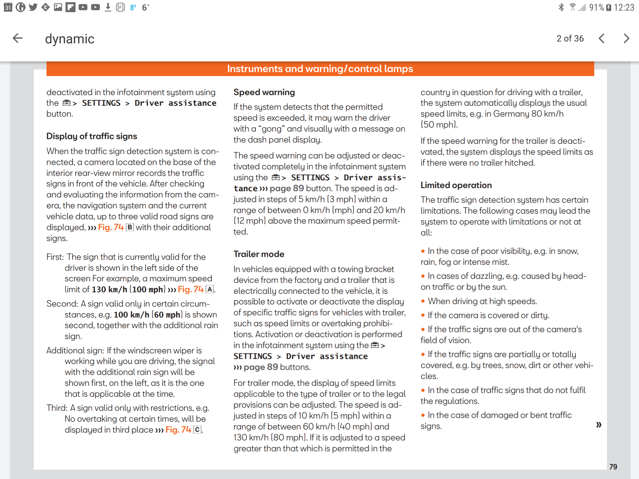

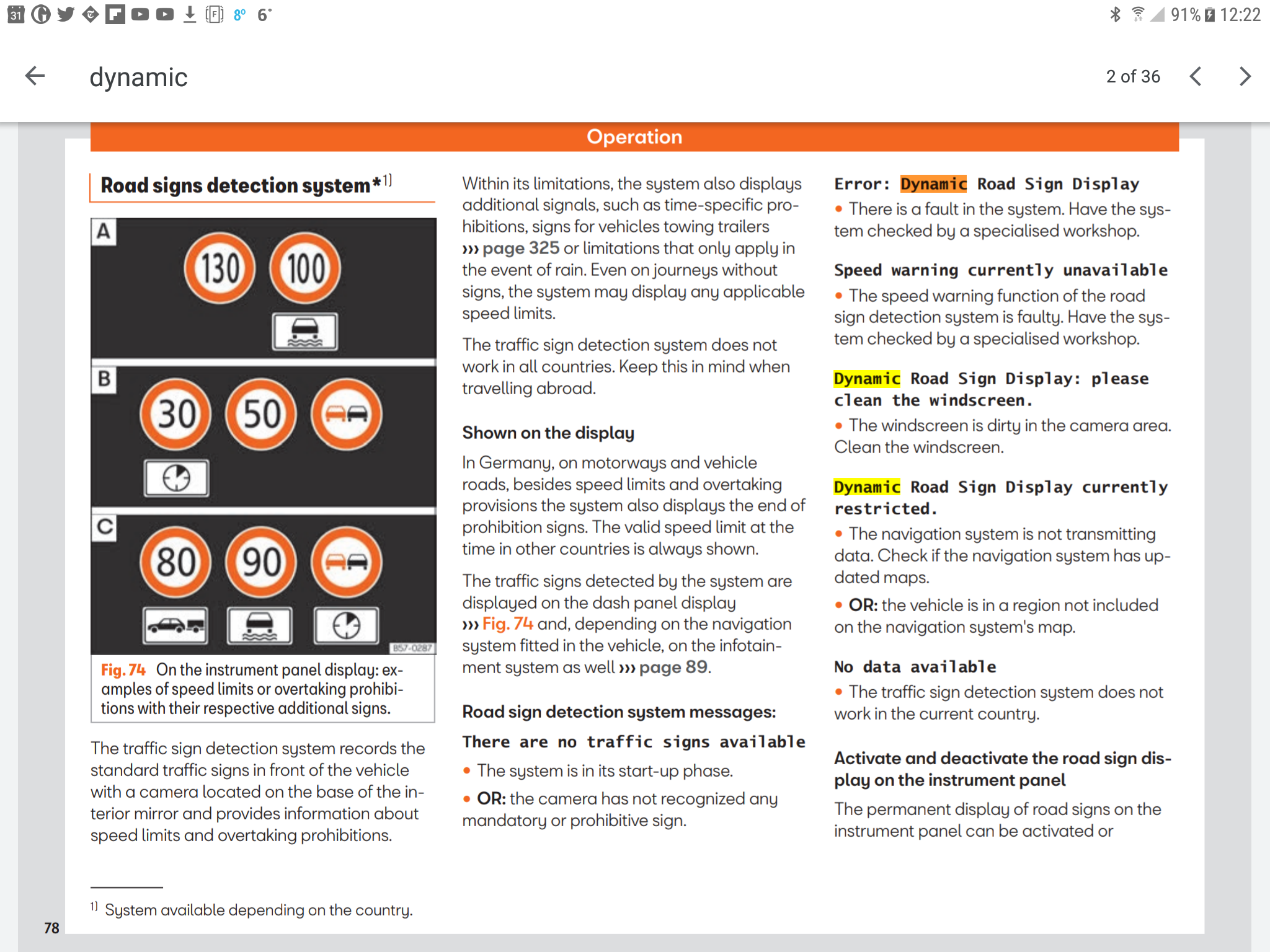

Traffic Sign Recognition (TSR)
The latest Ateca's do not have TSR as an option, if you do have Lane Assist you can turn on TSR. The software already exists in the car. This option will be of interest to Xcellence Lux people or Ateca people with Lane Assist but not TSR enabled.
OBDEleven does have a micro payment app which turn it on, although in 2017 this app did not work so normal "long coding" can be used and toggling the adaption screen. We follow the Spanish Seat Club forums post on this supplemented with images from my built in one so as to show how it looks.
https://www.clubseatateca.com/threa...deleven-procesos-verificados.2417/#post-98523
Translated:
CONTRIBUTED BY @RaulKO :
RECOGNITION OF TRAFFIC SIGNALS
Before proceeding, it is highly recommended to make backups of the modules to be touched, which are: A5, 5F and 17
We access the A5 module and go to Coding , Bytes mode . (Front Sensor Driver Assist)
In Byte 16 we activate bit 4.
We accept the change and then access the 5F module , adaptation.
(Note access code to save changes 20103 for A5, 5F)
In via the Adaptions option...
We enter the Adaptation option Car_Function_Adaptations_Gen2 and activate the following parameters :
menu_display_road_sign_identification and menu_display_road_sign_identification_over_threshold_high
We accept the change and enter the option Car_Function_List_BAP_Gen2 Adaptation , where we activate the following parameter:
traffic_sign_recognition_0x21
Now we look for the option traffic_sign_recognition_0x21_msg_bus and we give it the Databus Infotainment value (the text may vary depending on the language, but it is what it says is the Infotainment bus)
[image as above... uses the bus number as used elsewhere 15 in my case]
We accept the change and, finally, we access the module 17 (dash board)
Inside Coding, Bytes mode, in Byte 5 we activate bit 2.
[Confirm, code 25327]
As soon as we confirm the change, we will see that the compass in the FIS has moved to the lower left zone, leaving the upper central zone free in the FIS.
I recommend restarting the Infotainment (press +10 seconds the power button) so that the configuration option under Car-> Assistance to the driver is refreshed.
See manual for adjustments once enabled. Pages attached below of the Ateca July 2019 manual on TSR.
For VCDS see discussion on this:
https://forums.seatcupra.net/index.php?threads/tsr-xcellence-lux.447779/
Note West European Vehicles
For non West European vehicles the navigation maps do not support TSR, however there is a workaround covered in this thread. Good for where TSR is not sold but you have lane assist with the correct camera and period where the fix works, see and follow the links.
The digital maps work hand in hand with the camera but can be toggled off to make it work. Relevant to Australia, NZ, parts of East Europe etc. Removes the error. See links.
