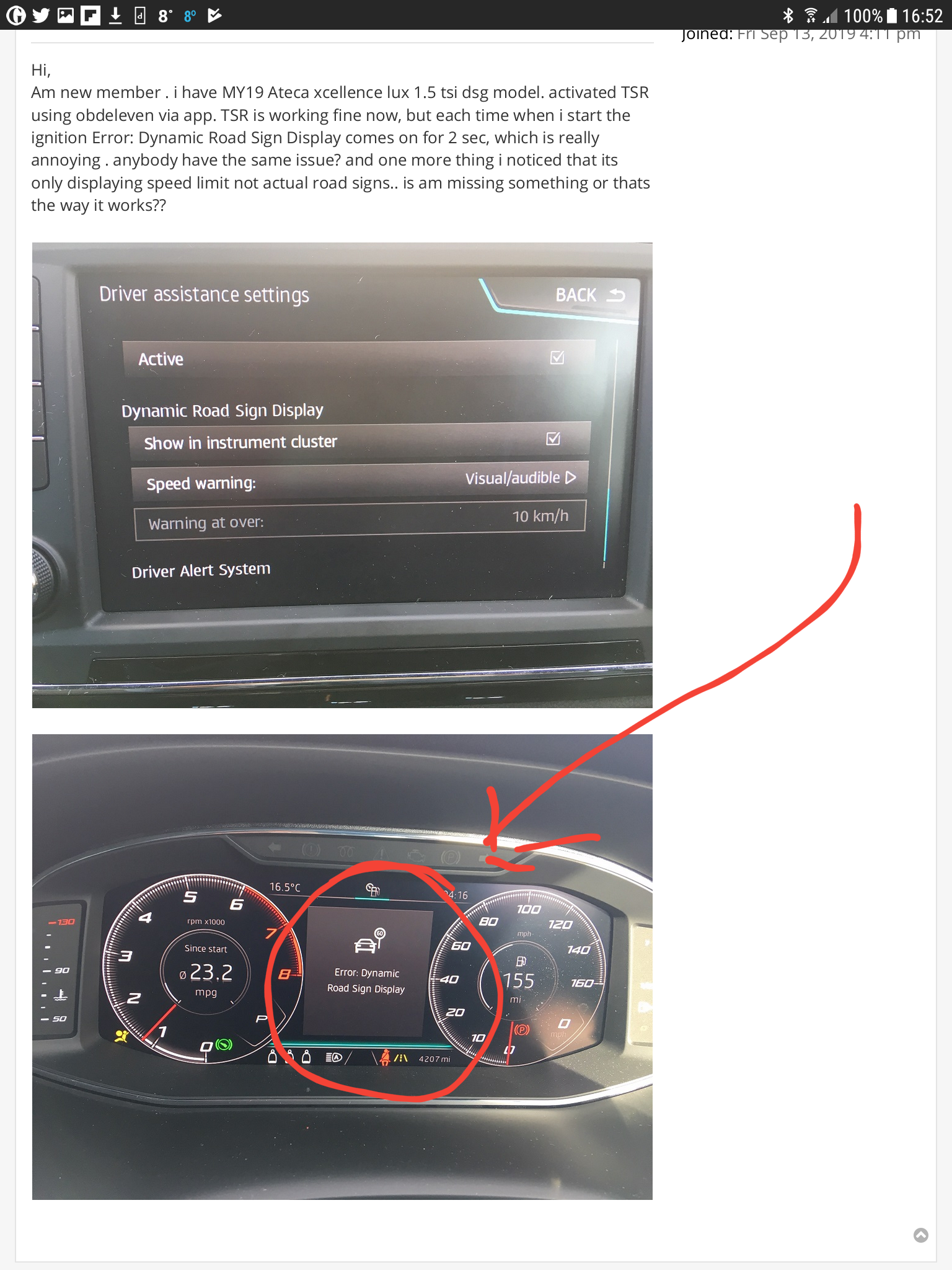

I’ve just tried enabling traffic sign recognition and I can’t get past the first stage.
I went into A5, coding, into bytes mode and byte 16.
Bit 4 “Traffic sign recognition” and tired to enable it and I got an error which I think read “not supported”. I took a screen shot but it’s on my android phone and I’ve left it at home.
My bit 4 read “Traffic Sign Recognition VZE”, not sure if this makes a difference. Going to do some googling and will report back but in the meantime if anyone has some suggestions they will be much appreciated.

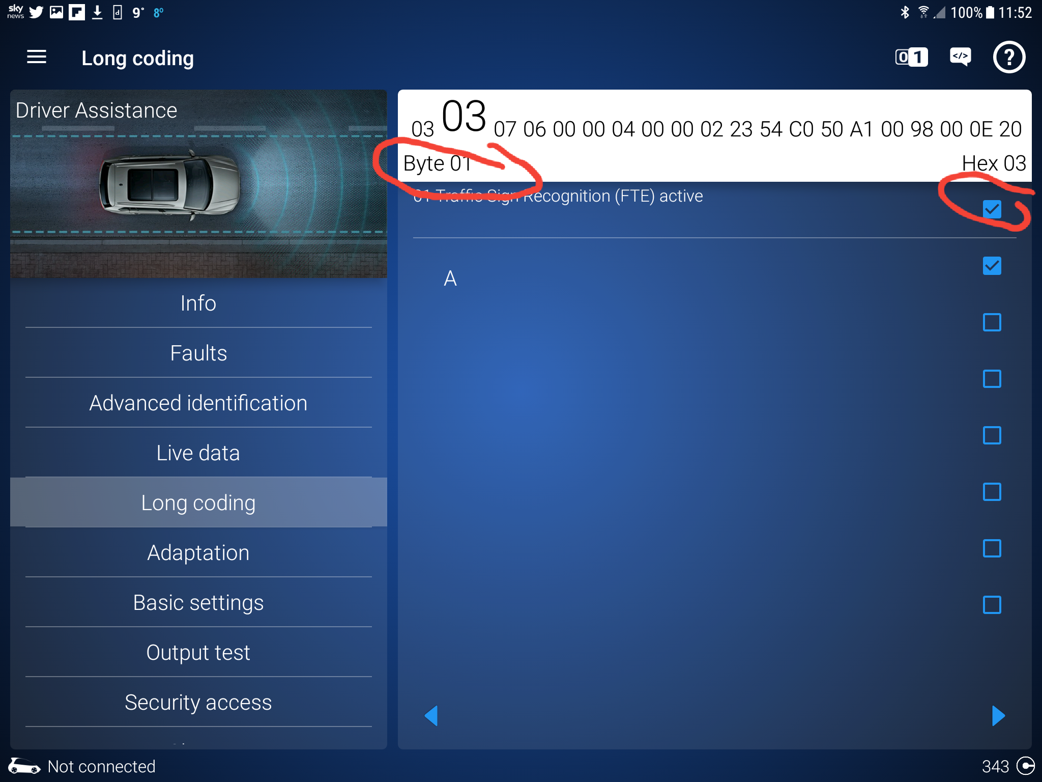

Related or not I see that the Obdeleven A5 module also has another byte set in mine which doesn't appear in anyone's documentation of this mod. Byte 1, hex 3 checked, see attached.
It could be until you have everything set up it does moan about things missing as the modules won't be talking to each other ?. I've not done the mod since mine was factory fitted but can be done on cars fitted with lane assist.

The Seat Club Spain Ateca instructions I annotated with screen above have it in a different order... you could try that order if it moans less.
Mystery A5 screen on mine attached. Have a look at that as well and perhaps add to yours if still no joy.

Looking at the board that published in post 96 above in the different order to the Spanish one they are getting a 5 second error message on start-up. Hmmm what they are missing is the Spanish instruction in post 65 above
"Now we look for the option traffic_sign_recognition_0x21_msg_bus and we give it the Databus Infotainment value (the text may vary depending on the language, but it is what it says is the Infotainment bus)

I'd stick to post 65 instructions and look out for the byte 1, hex 3 on A5 which it has showing in my Obdeleven. There are posts that talk about this field on the Obdeleven board. Since I have it in my factory fitted one, you could check mark that for good measure as well. That's the first attached image. You could try without it first then with it. It's connected to the model of camera.
