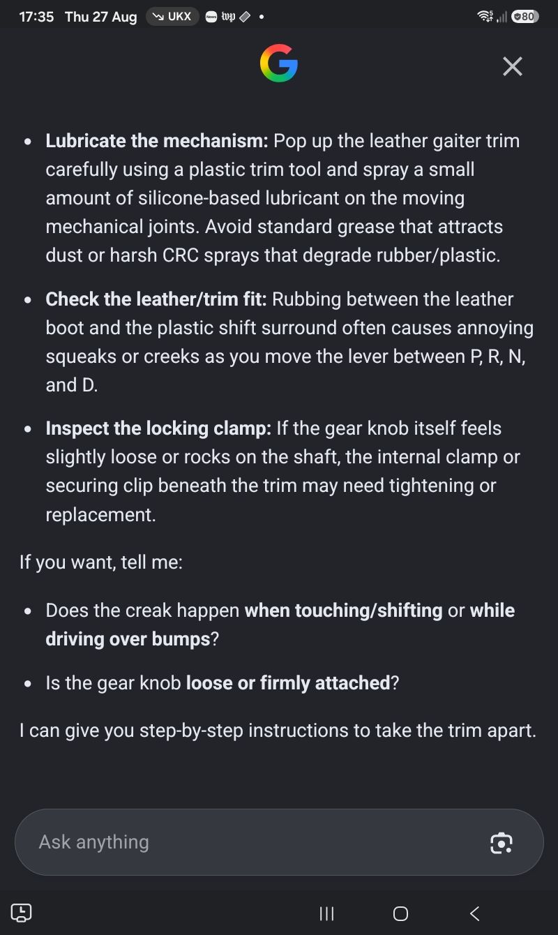

And Aunty Google AI seems to know about it
Like that other link but ties this to the Ateca DSG.
