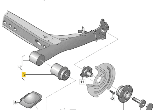

The car is on 110,000 miles. I was going to change the bushes but i wanted to make sure it was the part thats making the noise also i cant find the part for it
The rear beam axle main bush is 5Q0 501 541 C
Number 3:
My rear dampers were shot at 90k miles so if your going to replace your axle bushes - I would also replace your dampers.
