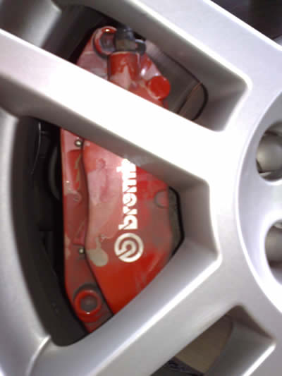

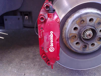

first of all, here is a pic of how bad mine were,
I thought the paint had come off bits, but it was just the air bubbling up the lacquer.

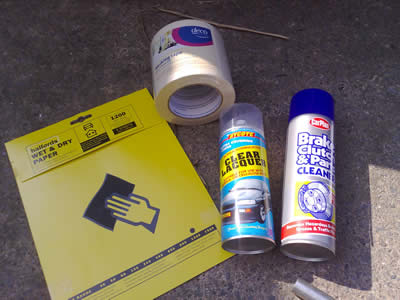

Make sure you have the essentials:
Masking tape
some degreaser (I used car plan brake cleaner - £5 motor world)
Lacquer (Hycote Lacquer Paint)
1200 wet and dry paper (£1.99 Halfords)
approx cost £15

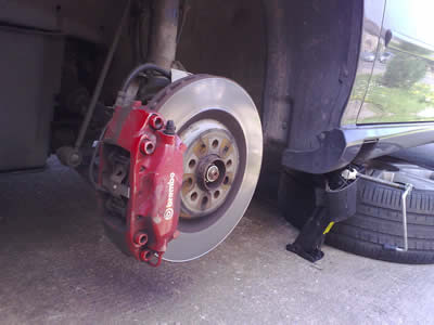

1. take off jack cap on the side skirt (pull and squeeze from bottom)
2. use tool in boot to remove nut caps
3. loosen off bolts on wheel (dont take them off!)
4. Get jack, and jack up the car aligning the ridge on the jack with that under the jack cover.
5. undo the bolts on the wheel, remove it and put the wheel just next to the jack in case it falls, also make sure your hand brake is on tight
6. degrease the brembos with appropriate degreaser.
I didn't want to remove the brake pads so i got some car plan stuff that i could use whilst they were still on, I had to use a cloth the wipe off the dirt as it evaporated quite quickly.
7. try and peel off any lacquer that is flaking, i used the my nail (pushed it away from me to stop it going in between my finger) this method also pushed the air into other areas of the lacquer which made removal of top layer loads easier, this bit can take ages, but the more you do now will mean better results.
should look something like this

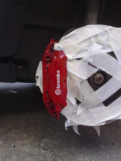

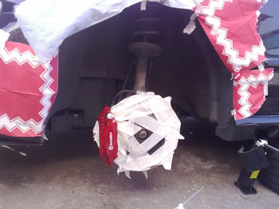

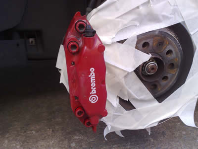

9. Mask any areas such as break pads and anything your not spraying
10. Get some newspaper to cover the surrounding areas incase any lacquer gets on any panels, or if your a pikey like me use some rags and christmas napkins that are the only things you can find
11. Use thin coats of lacquer, and do about 5 of them going back every 10-15 mins, or as directed on the can

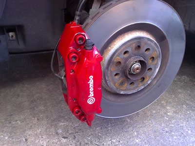

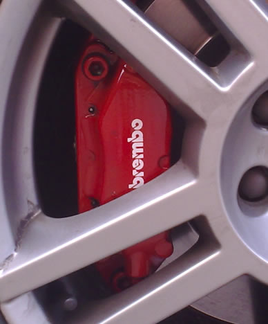

here are the before and after shots:
