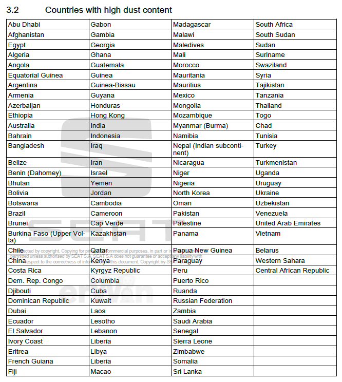

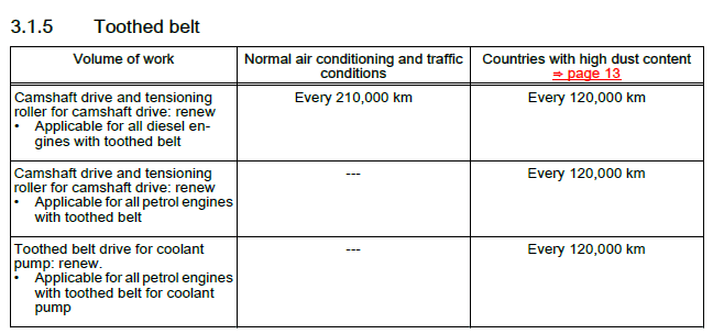

Maintenance manual does not specify a replacement interval for petrol engines in countries with normal air quality.
There's a 120,000 km interval for countries with high dust content.
There is no time interval, such as "4 years or 120,000 km, whichever comes first", it is specified as kilometers only.
So even if you live in a country with high dust content, 40k-miles looks early to replace it.

Great thanks for this, I just found the links to those service manuals via this forum and had a flick through. So it does seem VW group do indeed consider it 'lifetime'.
