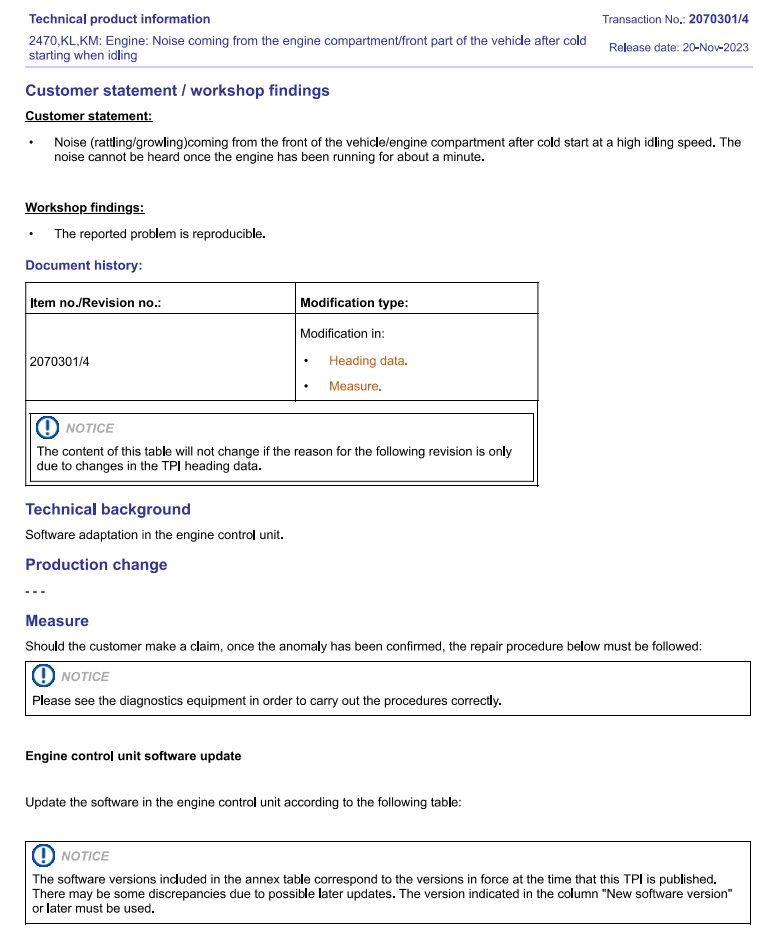

Hi all. First time posting anything. I’m looking to get some some help. I bought a 2021 1.4 Ehybrid Leon at the end of November. Straight away I noticed a strange noise when petrol engine starts (everything seems fine when running on electric). The noise lasts for a few minutes then I will go away. It also seems to be coming from the right hand side of the engine
I took back to SERE. After a few attempts they told me the noise was the water pump and replaced it . Still made the noise so they took it back in to “investigate”. They installed a software update and decided that the noise was normal.
I brought the car to Cupra on the Boucher road. They installed another software update and is going back in to investigate.
apologies for the long post. I’ve attached a couple of clips of the noise to see if anybody has had any similar issues or may have any idea what it could be.
