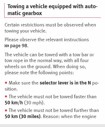

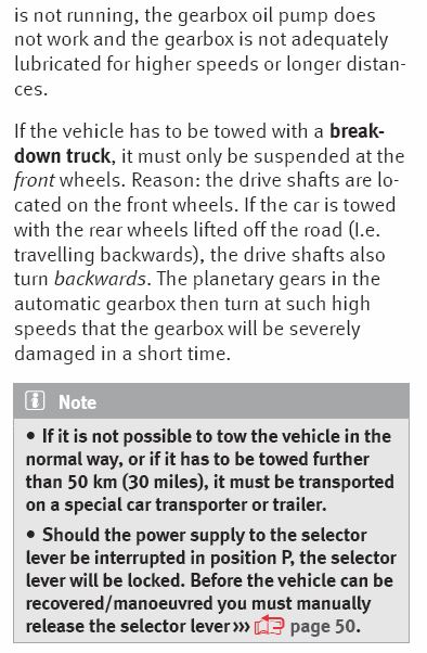

Can the Leon's (cupra 300) be towed?
How would it work with the elec handbrake?
Could I change the tyre and keep the rad topped up with water every few miles til I get to a garage?
Or should I just get a recovery truck?

You can turn the electronic handbrake off, just need to turn the auto off (button next to it).

DSG Cars used to have to be flatbedded rather than towed .... is this still the case these days ?

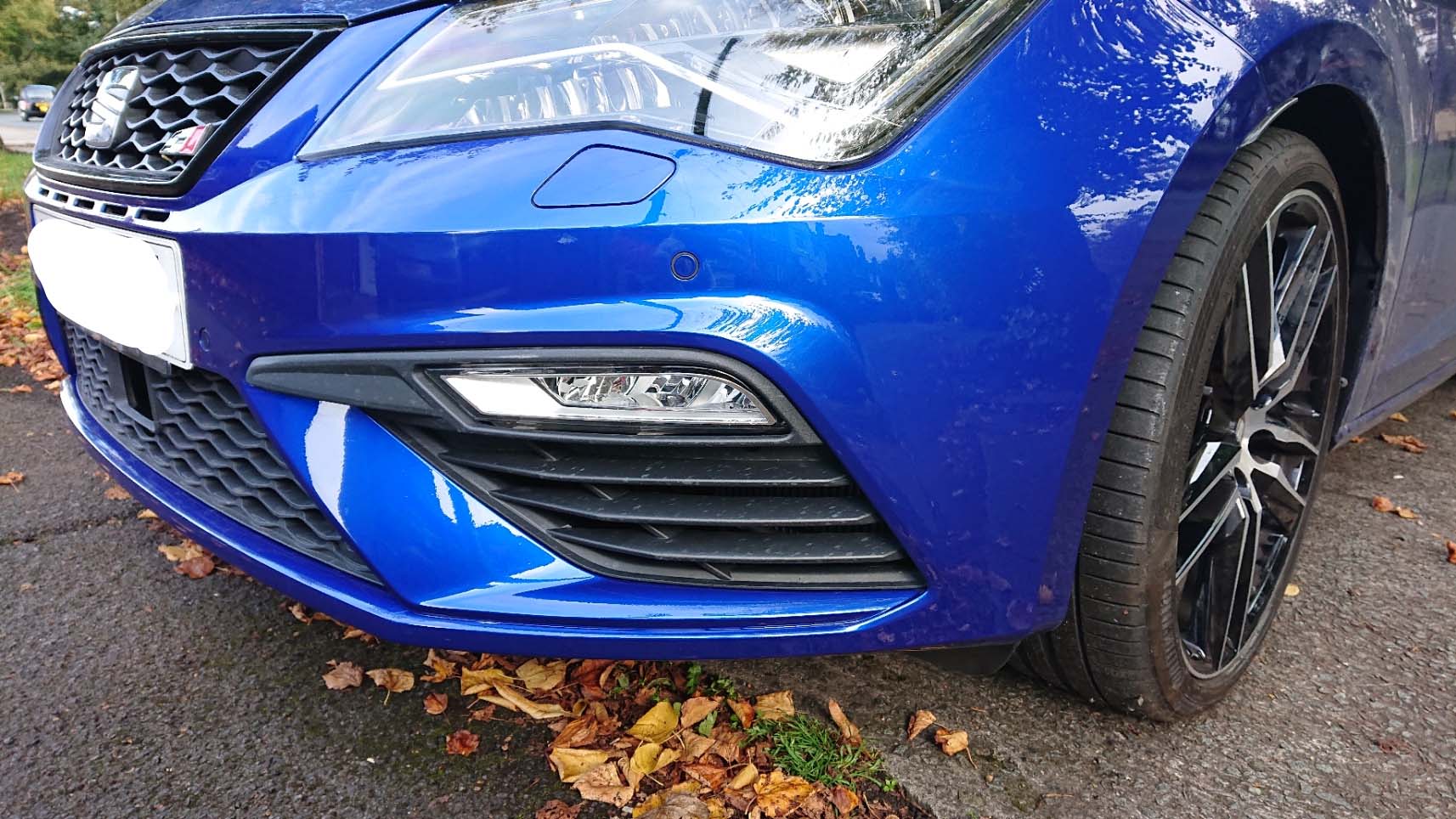

Just a quick update on this.
So I have had the damage repaired, total bill came to £1550, which wasnt too bad.
Just got the problem now that the front looks so much newer and shinier than the rest of the car. haha.
Might have to treat her to a good polish.
Also i hope it ok to do on here but I just wanted to give a quick shout out to the body shop that did the repair, as they did a really good job getting it sorted for me and couldn't do enough to help et everything sorted.
