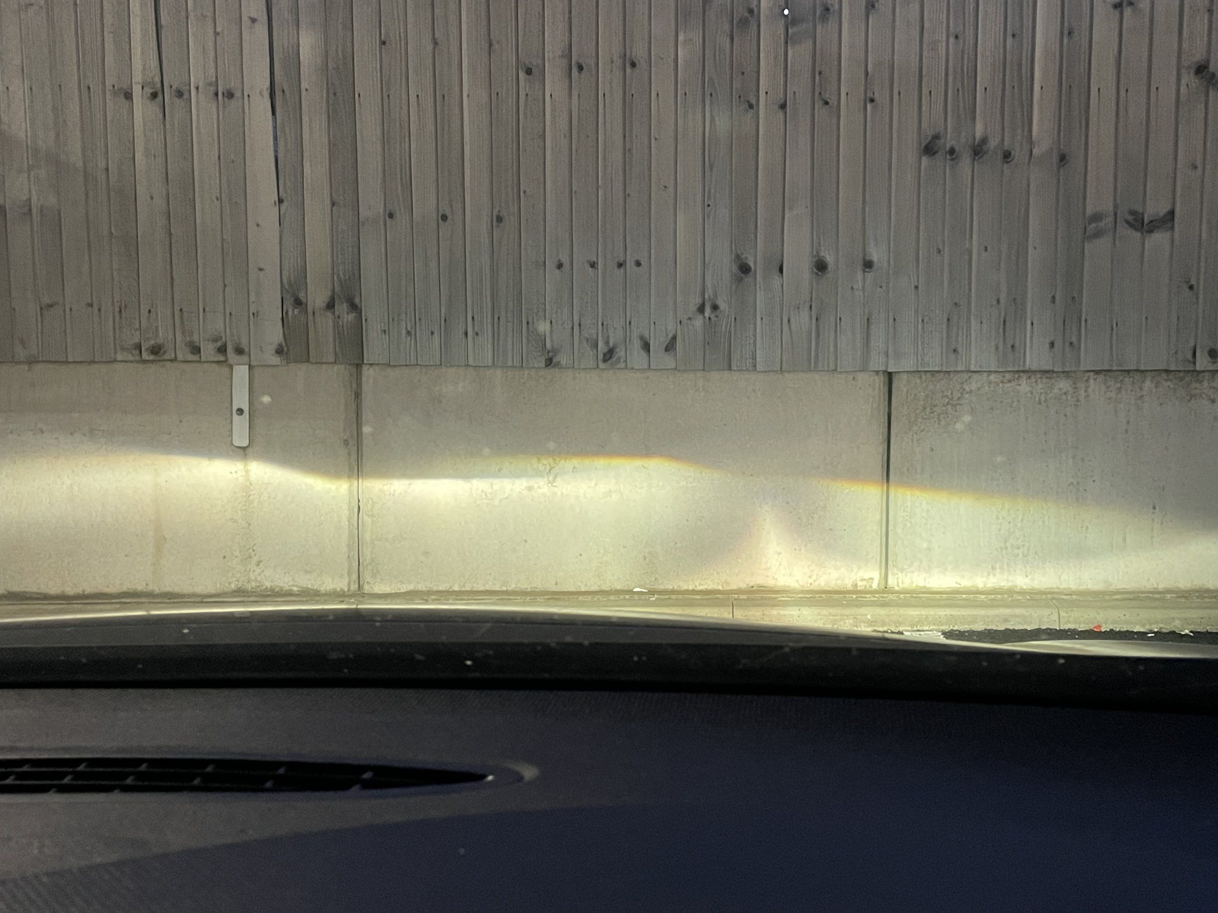

Mines has mud bottom the passenger side housing, must have splashed in there but both of the headlight covers are on tight. Also I made a video of my headlight with the scattered light pattern, not sure what’s going on here

will defo clean it, do u know why my cut off line looks distorted

Projector headlights have the obvious lens at the front and the polycarbonate cover, which gets milky and 'cracked' over time.
They also have a reflector inside the projector unit which produces the beam shape. If that gets damaged or dirty you'll get a faulty beam pattern.
When you pull the light unit out clean the projector unit off the lamp unit.
Did your car go through a ford or flood?

it rained heavy a couple of times this month in Birmingham, I was thinking it’s the puddles i drove through that caused muddy brown splash marks in the headlight, but how did it get in there when it’s got both covers on secured? Thanks

Well the headlamp unit is sealed, with holes for the fitting of the projector unit and other bulbs so through them holes I'd reckon. They should have seals but time or poor fitting can make them less effective

Only way is to take both of them off, clean, inspect and go from there. Will have to search youtube on on projector cleaning, thanks
