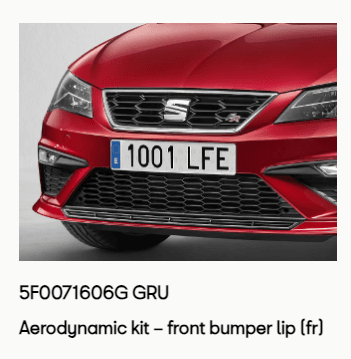

A complete aero kit would include a lip for the existing front FR bumper.
I didn't order it yet but I will eventually, probably in a couple of months.
I didn't hear anything about the sensor delete, but I don't think it interferes with the sensors in any way.

From the 2016 brochure - ' Sport Styling Pack1,2,9: Includes sports styled front and rear bumpers, body- coloured side skirts, rear spoiler and dual exhaust pipes. Deletes front parking sensors'
I couldn't find the same in the FL brochures. Something the PFL boys miss out on!

Current aero pack is introduced later than this sport-styling pack, I guess.
Maybe with a different front bumper.
EDIT: I meant the previous sport-styling pack had a different bumper. Aero-pack obviously doesn't include one.
