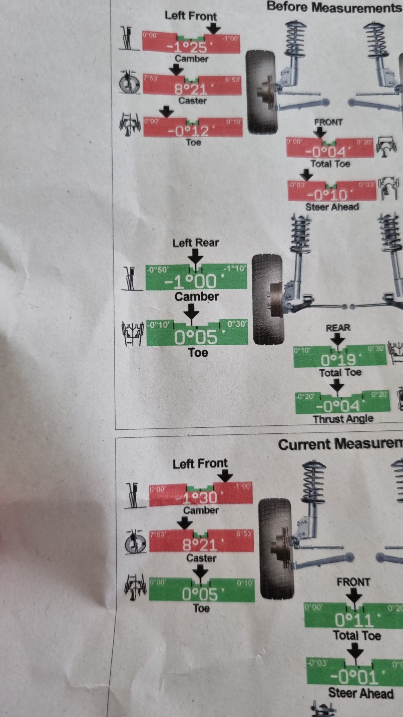

Had a wheel alignment done on the toe, at kwik fit. Was told that my camber and caster aren't within tolerance and that it isn't adjustable on these cars and would require new parts and installation to get it right?
Is that the case or a case they just didn't want to do any more work?
Conscious as now my steering wheel feels slightly off/looser to the left and not level
