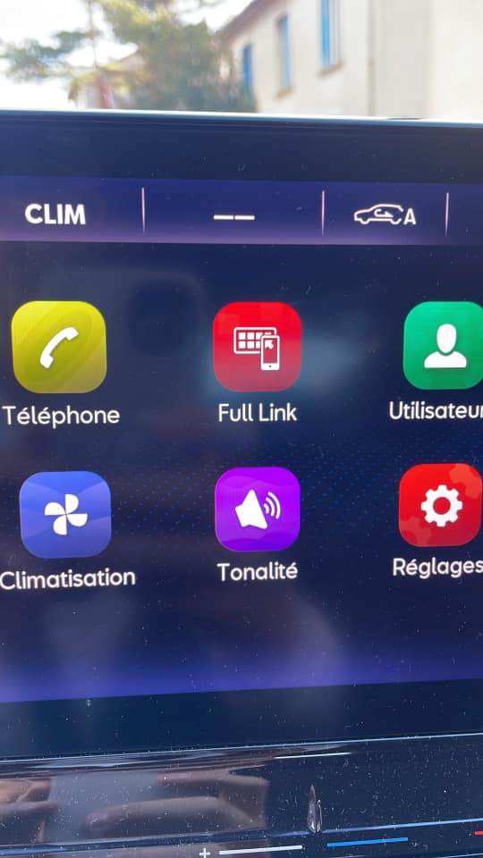

Hello !
I have a friend of mine who doesn't have Full Link activated on his Formentor (mine has it).
He got quoted 400€ for activation but now the dealer told him they can't activate it anymore because they don't have the software anymore.
Is there another way to activate it ?
Thanks :)

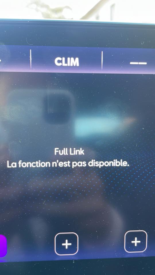

View attachment 39969 View attachment 39970
Hi, did you resolve this in the end? I have also bought a Formentor on which Full Link is "unavailable". The dealer says they can't activate it on my car because not compatible? Also when I try to buy the activation on the SEAT WEBSHOP it does a license plate check and it also says not compatible. I find it hard to believe...
No sorry, dealer can't do anything in the end...
Mar 31, 2024
I got Full Link activated successfully yesterday! It did cost me €430 which is kind of ridiculous, but still...
I also supplied the mechanic with the parameters to enable Wireless AA/AC. He made the changes using the original VAG instrumentation (not OBD11) and it works like a charm!
