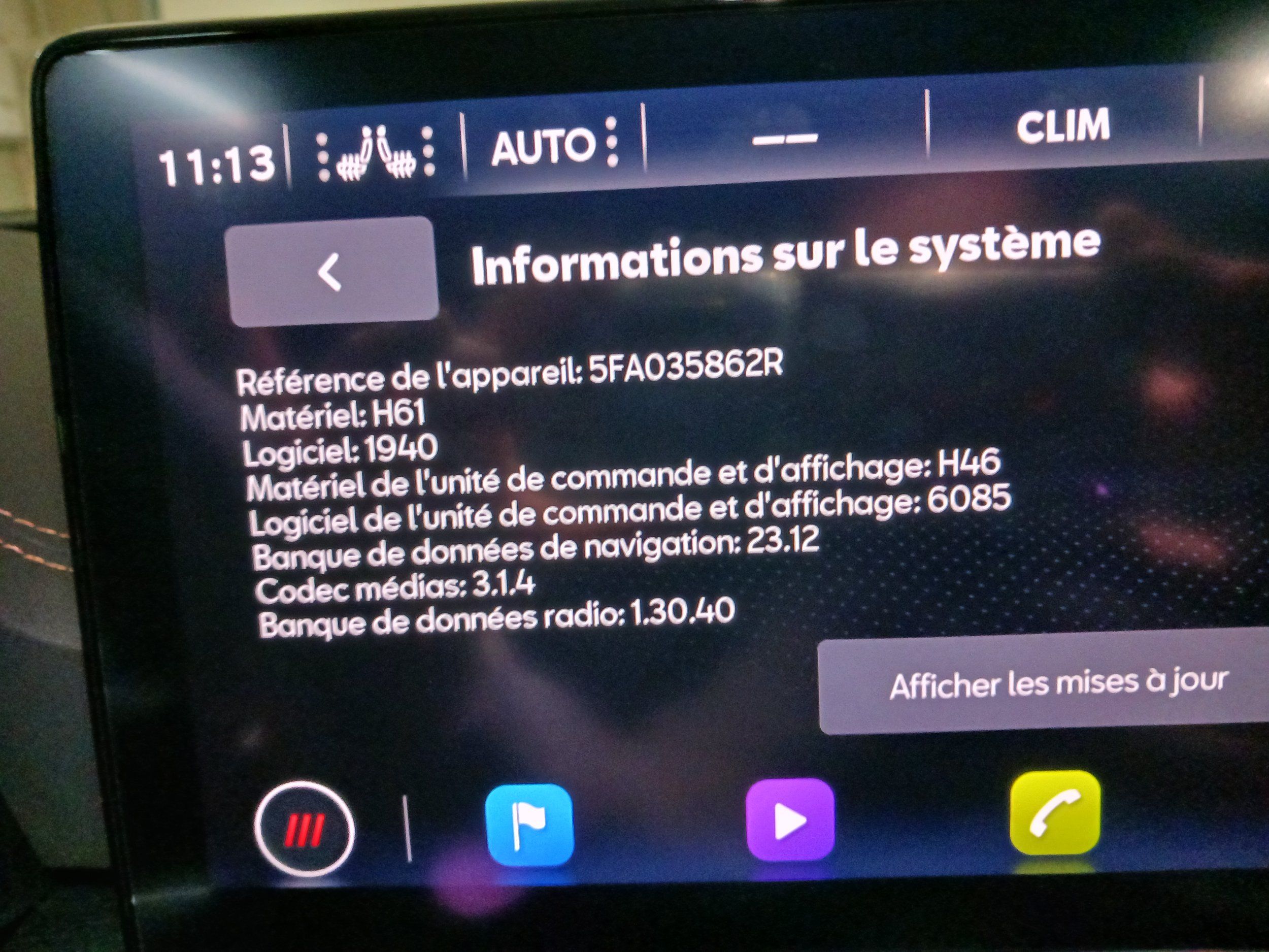

Feb 15, 2024
16
OK until the end of the warranty?
Here are my versions.
23.12 is December 2023?
