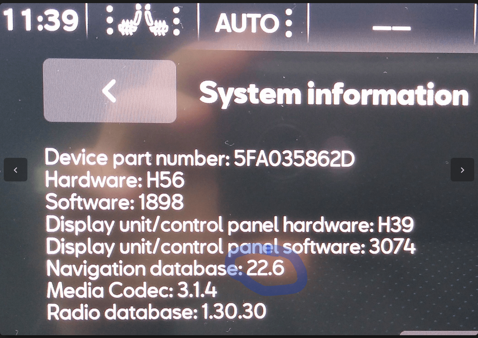

November 2024 release for Europe - scroll to other posts with more up-to-date links... kick off with these
Ok 24.06 now... push down list aka the November 2024 release indexed on the head as 24.06

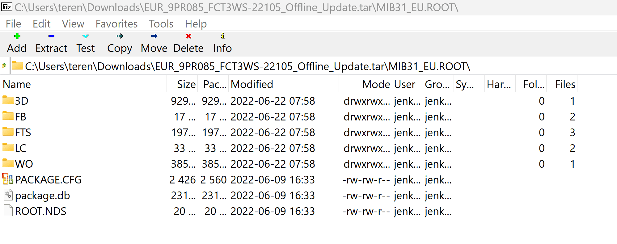

Whilst 7zip was the recommended VW way to open these files using the built-in file manager aka "File Explorer" of Windows 10/11 may be adequate. You might find 7zip faster.
Basically you open up the zip file, highlight all elements contained in the zip file, drag and drop to a blank directory on your HD / SSD. Then drag and drop that to a blank USB pen drive formatted in exFat. See VW instructions. Suggest you do it via the HD / SSD rather than directly so as not to thrash the port speed of the USB. Correct placement is important on the USB. It can't be one directory down. Looks like this in the root directory of the stick:

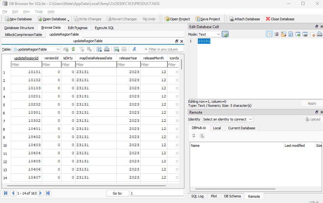

Derivation of YY.MM for the technically minded:
