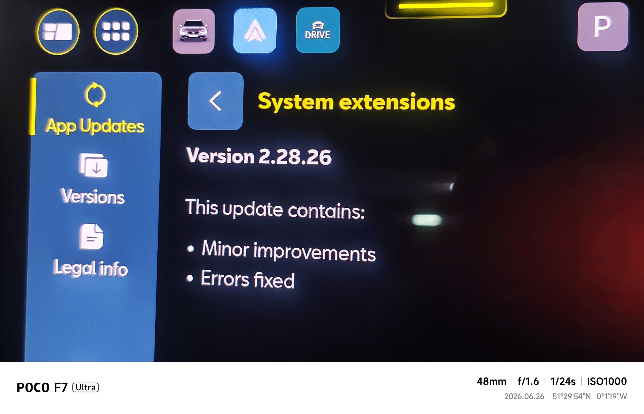

May I know what "update" was involved?
Mine got the update alert today (as shown in the pic below), too busy to have it installed.
(Any online resource with information of each update, by the way?)

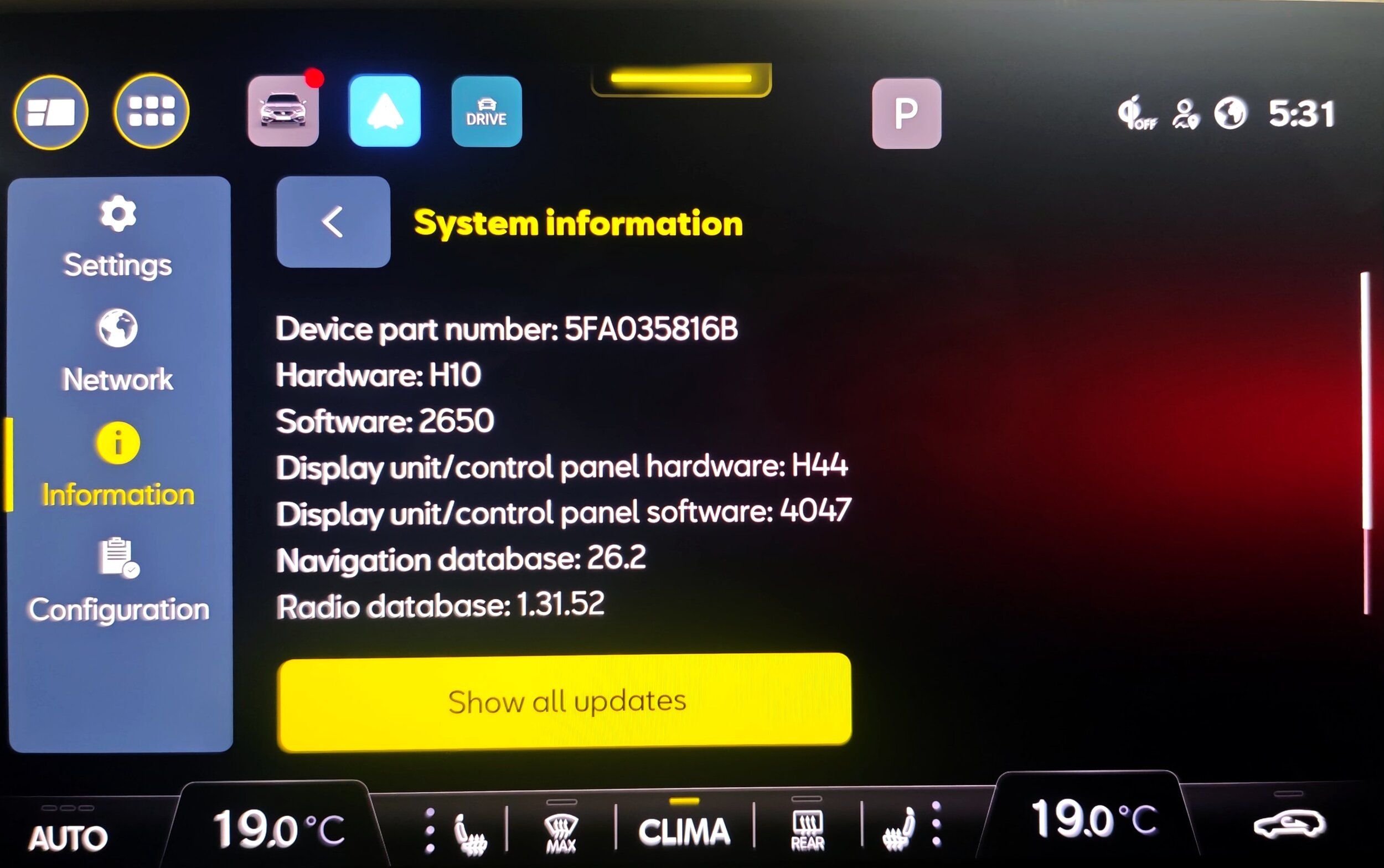

I don't know how useful this is to you, your screen looks nothing like mine (2021 Seat Leon PHEV)

2020-2024 vehicles use MIB 3
2024-Present vehicles use MIB "4"

I believe your photo shows the current hardware and software/firmware configuration, while my pic posted a few days ago was about the details of the software update being pushed to me via OTA.
(Anyway I later updated it on Tuesday while loading my grocery shopping at Sainsbury's, and so far no issue.)

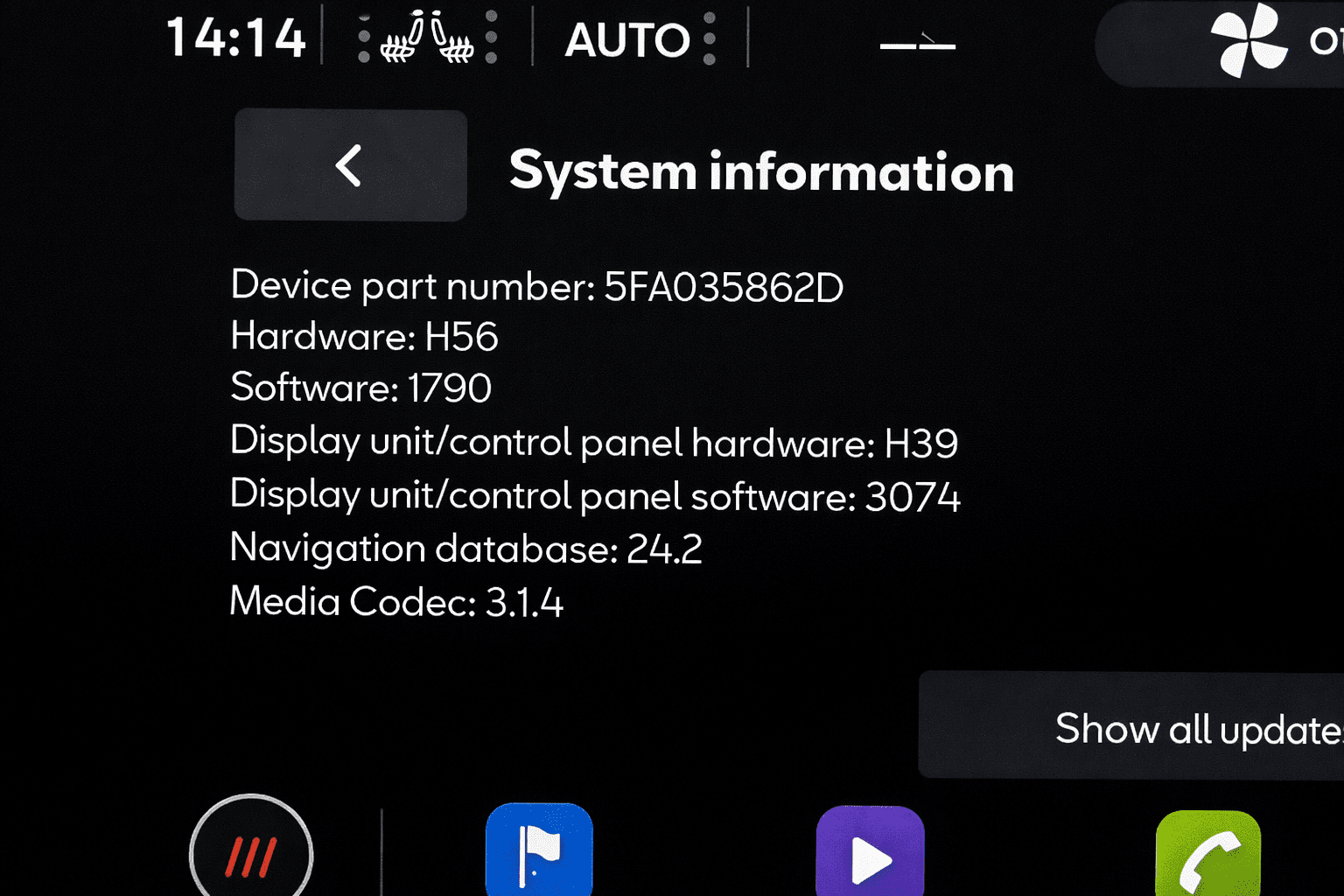

I always got confused - Google Gemini keeps telling me if there is no lighting element in the bar containing the temperature and volume buttons under the screen it must be MIB3.... My buttons do not light up anytime, yet my Leon left the factory in April 2025....
Do you have a picture of the software information on the infotainment system?
Hi james, below the pic I told back in late March this year.

You have an MIB "4", the latest software for that unit is 2768.

I've got mine booked in for a service and exorcism tomorrow. I'm going to ask for the Infotainment and modules to have their software updated, as the weird behaviours I mentioned before have gone away, but it's invented a new, even more annoying "features", hopping in and out of "Engine must run for extended period" mode, again and again and again, literally every few seconds.

Infotainment still shows 1790... I'm very "pissed".

Between 1790 and 1989 there are significant improvements.
I'd also say that around 75% of vehicle issues I deal with are resolved with software updates, VWG won't pay for a module to be replaced if there's an update available and the majority of time, there is.
When you replace a module it has usually has the same version of software or older, so all the same inherent issues. The issue has to be an obvious hardware defect to warrant replacing it, then it needs updating to the current version as best practice anyway.
