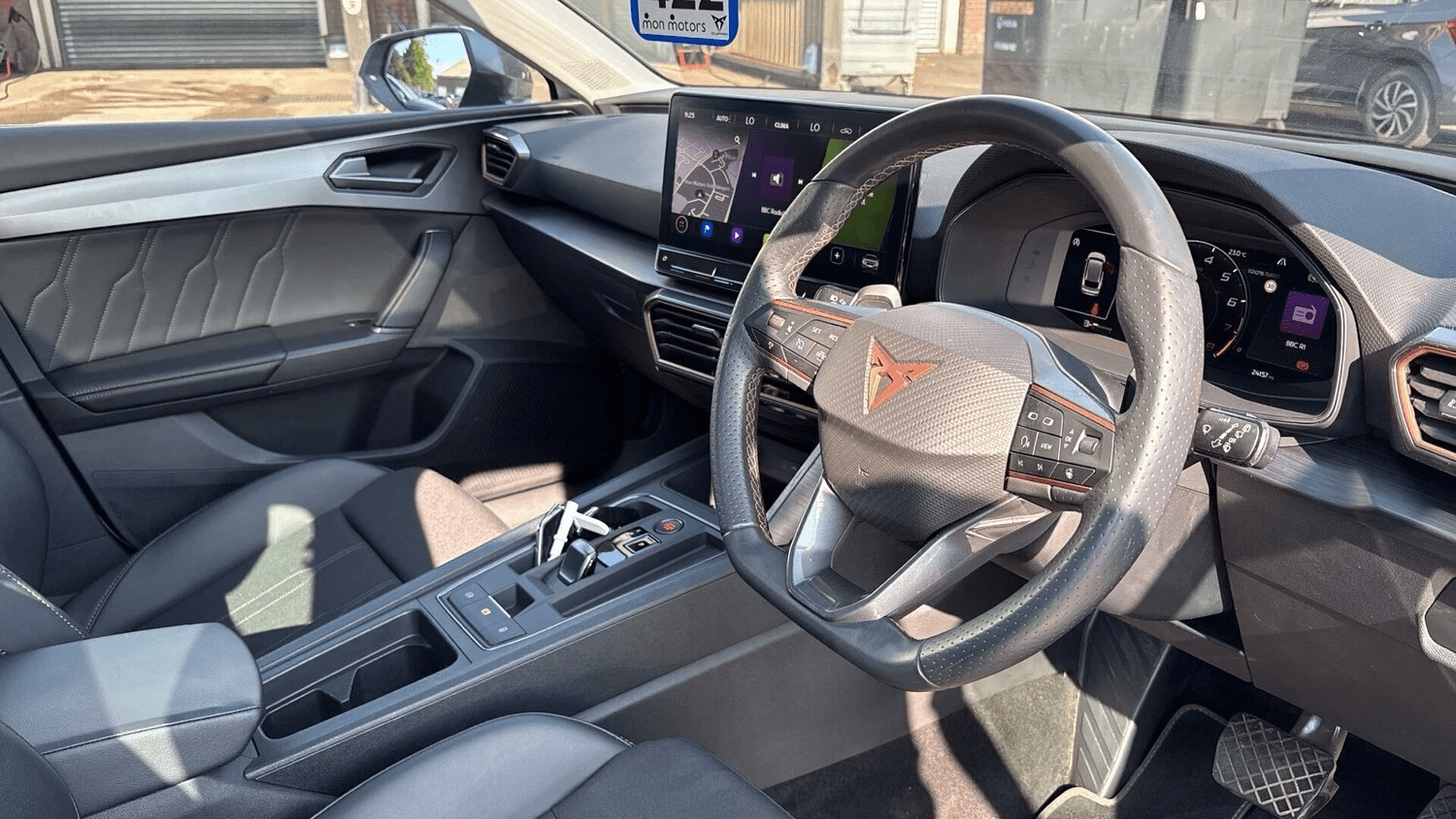

This is the V2

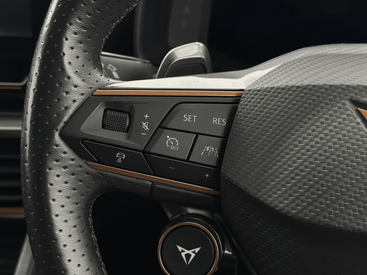

This is the V1

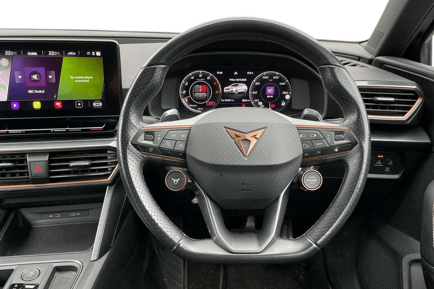

And the second V1

To tell if acc then I think if you press the button under res it brings a drive assist menu and I think if you scroll through those you’ll see acc where you can turn if on/off. The first v1 and v2(same buttons I have on the steering with acc/pac on a xcellence lux)
PAC I’m not sure if anyway to tell without driving and seeing if it changes as you pass through speed change zones.
It definitely has ACC, check the driver assist menus. It will have two extra options under ACC if it has PACC

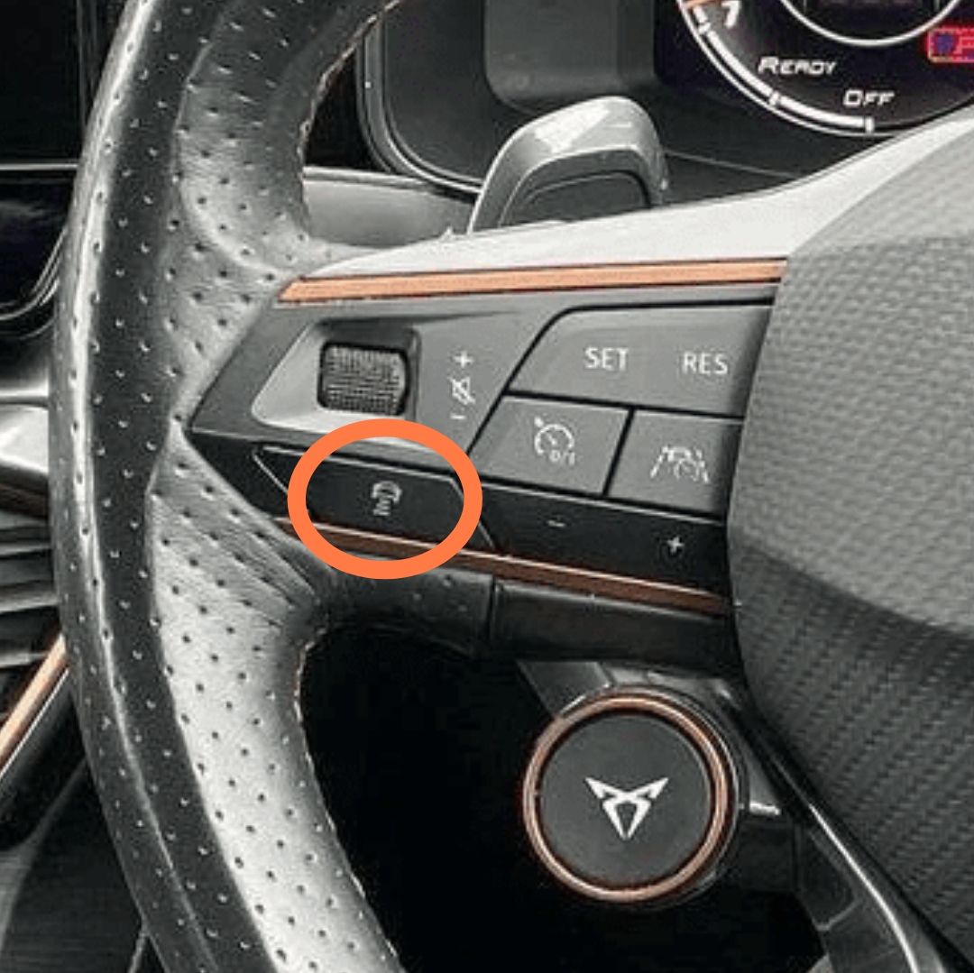

Distance setting button on the left side of the steering wheel (leftmost one) points to ACC.
Classic CC does not have distance setting.
Reactions: Rob66
- and + take the set speed down/up in 5mph increments. The 0/1 turn on or cancels acc. Res resumes at set speed, or takes up at 1mph, set sets acc at current speed or down minus 1 mph. The bottom left sets the gap distance between you and vehicle in front. The other takes you into driver assistance menu where you can turn on/off lane assist, front assist, acc

I believe all 3 cars in your photos have ACC, with the button (red-circled) being the distance setting switch for ACC.
My KL8 has this button "blanked" as it only has CC. ☹️

Having been in my car today I agree with above, all have acc. The first 2 have travel assist button.
