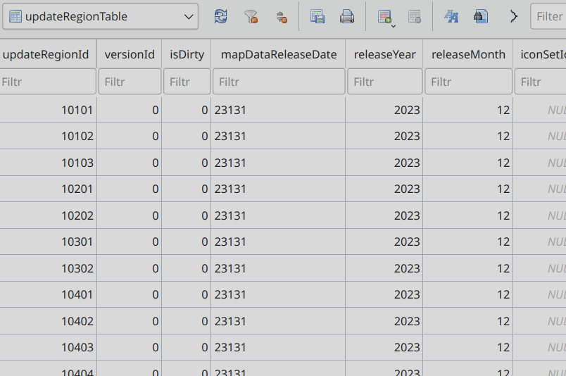

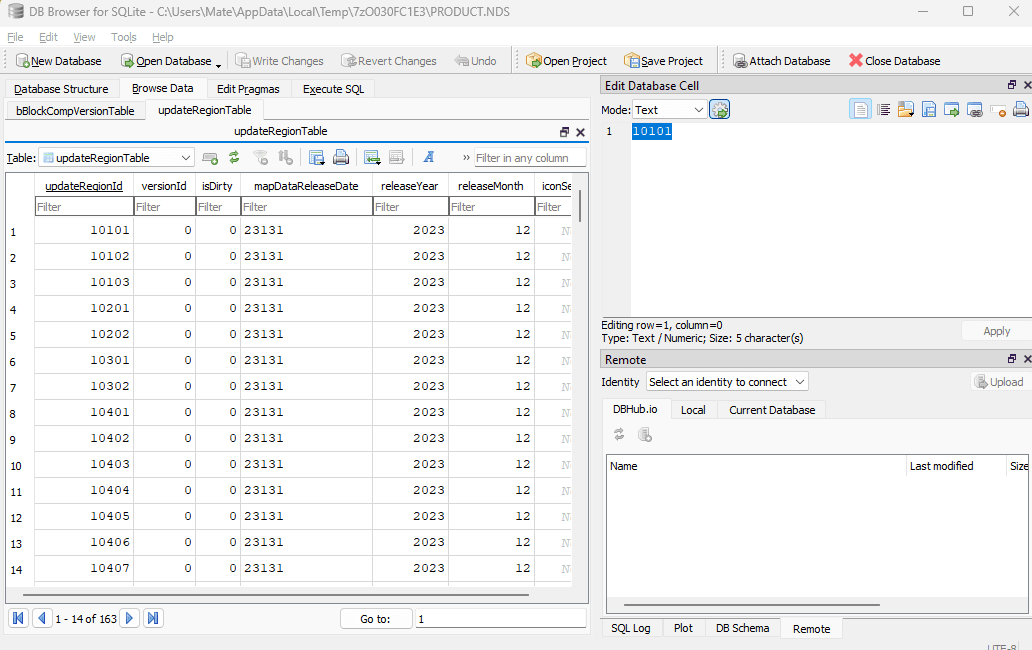

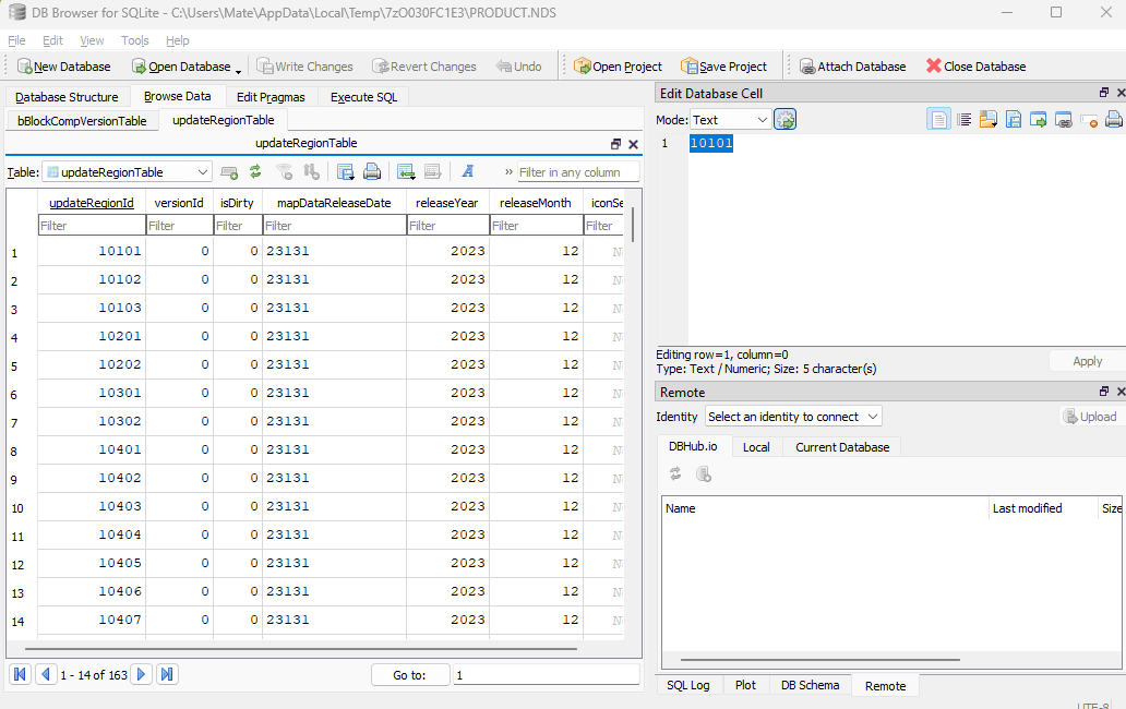

Technical Note - Derivation of the YY.DD as shown on the Infotainment Screen
I have now been told how to read that YY.DD date off the files after putting out my request for some time for a bright spark into these Mib3 files. It's been delivered. If you don't want to load up the file you can look up what year the and periods the files relate to. It's important with MIB3 files you don't alter the contents because you can't they are signed and they will refuse to load. So no tampering with the files like mib2 standard maps.
Anyhow, this is how you do it thanks to C34 on the Briskoda site... only two posts popped up to tell me. You need to install DB Browser for SQLite. This has an extension in it to read the NDS Associate files, the normal SQL Lite brower that is popular won't. Install the MSI of DB Browser for SQLite in the link above.
We now use C34's text... In this example on the file
Update OI_P119_EU_202425_Offline_Update.zip contains data from 23.12 (YY.MM).
You can check this for example in the MIB31_EU.ROOT/3D/PRODUCT.NDS file. This is a SQLite database, you can find this information in the updateRegionTable table.
You open the table up and have a look. Does help if you have database experience :). On the VW file, for 2024/25 I got this:
So that is they, for the technically minded of where the YY.MM is stored in the files. Handy if you come across one and not sure. That's how you nose about those files not that you need to... or you can just trust websites like this.
Just a side note for those that are use to looking inside the files for release information. Dropped down here due to edit size in original post.

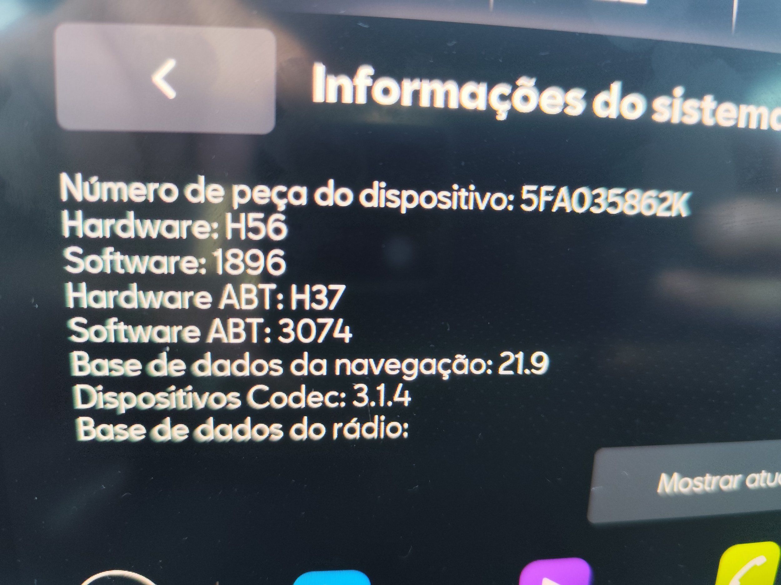

Hello,
I need your help updating the maps.
So I own a Seat Leon SportsTourer 2.0 Tdi FR 150hp DSG.
I got it on December 2020.
On Seat's official webpage where the offline maps are I have 3 options to choose the maps:
From 2021
From 2018 to 2021 Plus
From 2018 to 2021 6PO

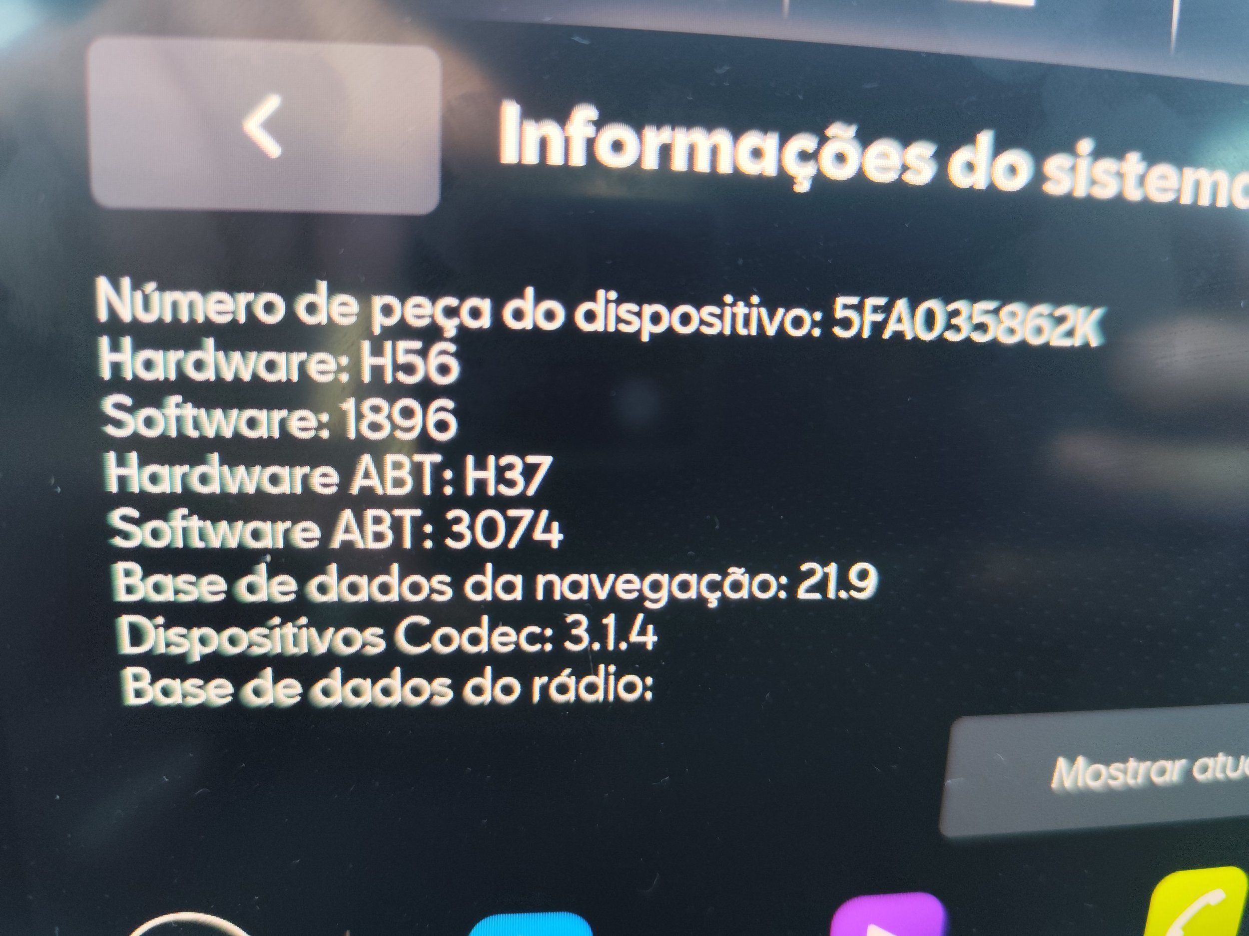

How do I know wich one is mine, as I got it on 2020 but late December already (got it on the 28th), going to attach the infotaitment info to see if somene can help me on that
Tell

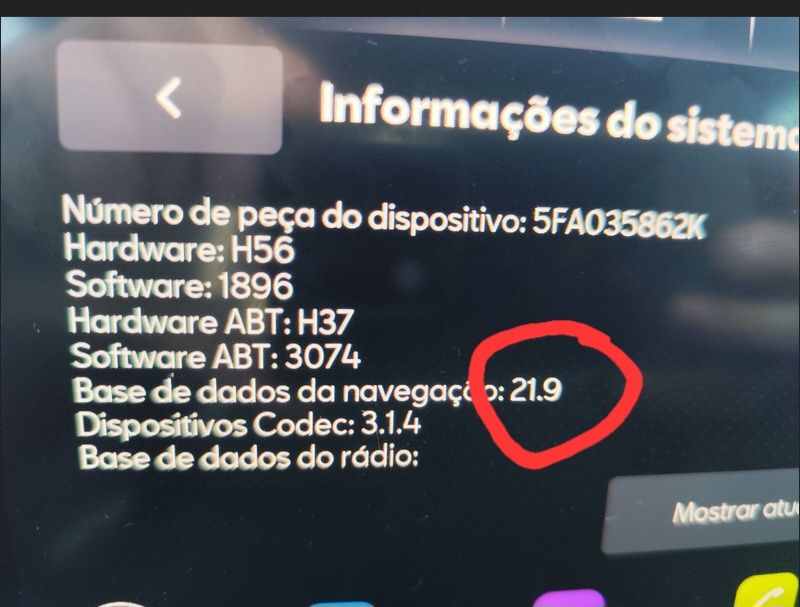

You are on thr right thread... it's a mib3. 21.9 is the YY.MM
You do post 1 on here using the Skoda link. The files are interchangeable in the Vag brand for mib3 for this model. After the update that YY.MM will change to the November 2024 release. That will change to 24.06 based on the current link shown. Think you'll find the Seat page is hopelessly out of date why we use the Skoda link or the VW. The links are back to the file server cutting out the need to know VIN codes or logins to access.
