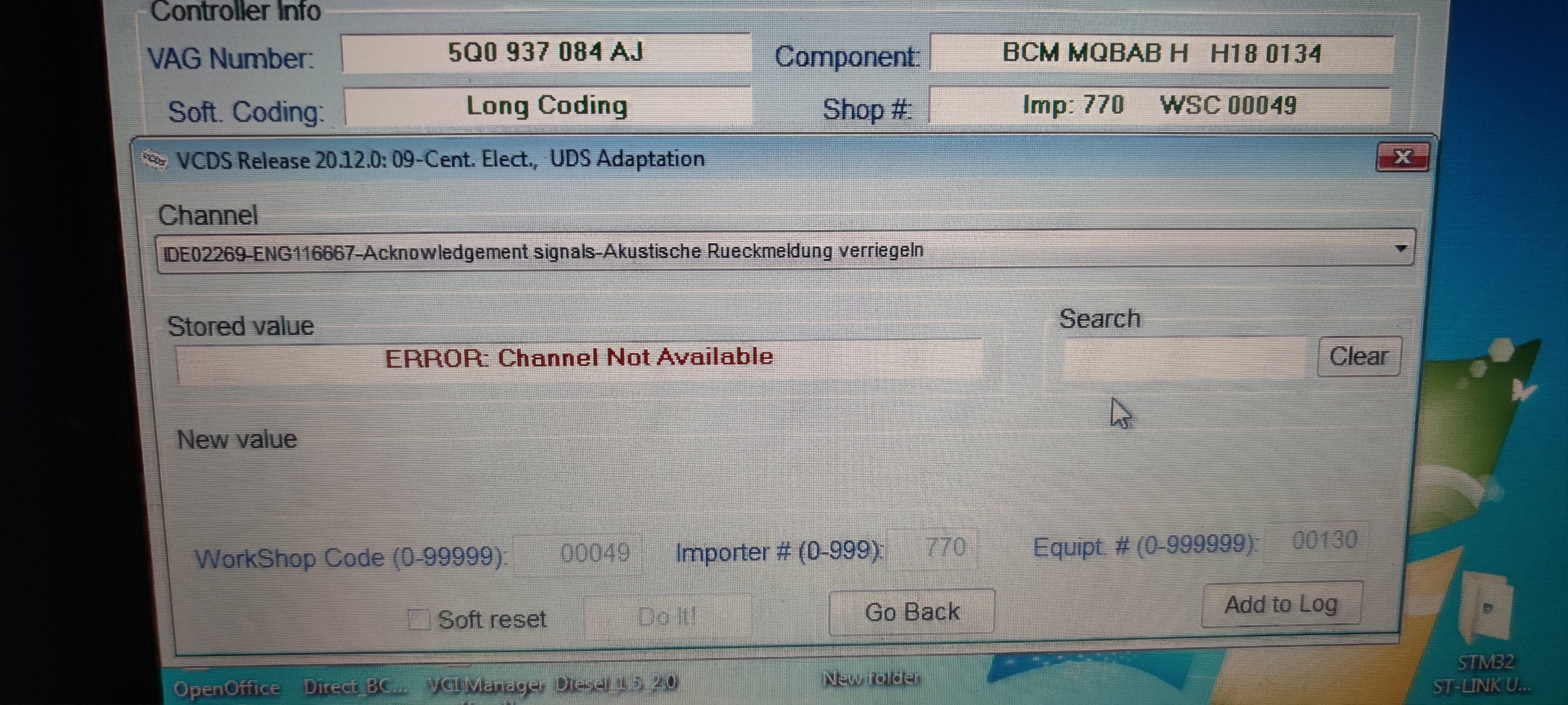

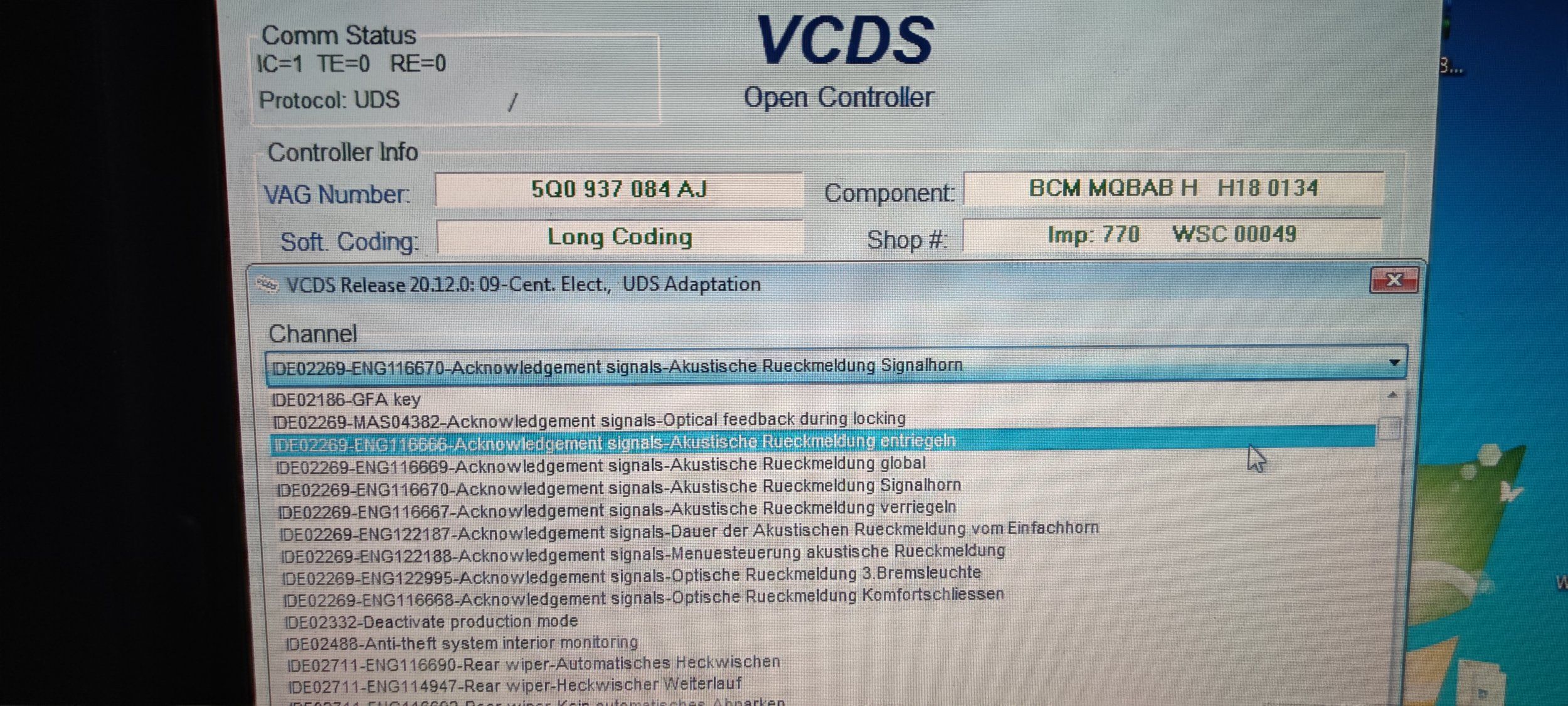

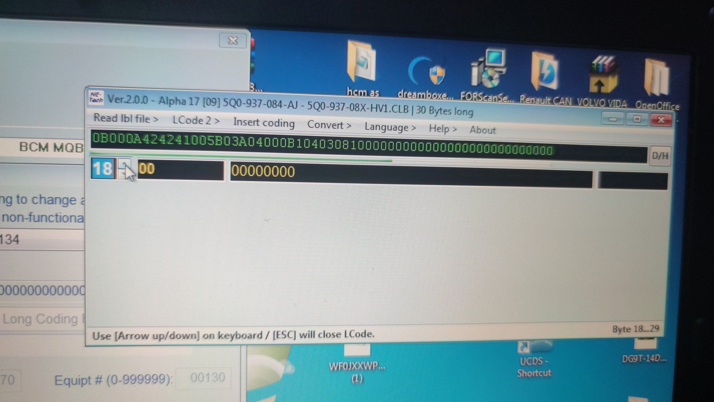

Hi guys,
I know there's a post (https://www.seatcupra.net/forums/resources/vcds-how-to-guides-mk3-leon-5f.5/) regarding locking/unlocking chirp activation through adaptation in 09 central electric module but it didn't work for me on my 2014 Leon SE Tech Pack. I've tried it but whatever I've selected from drop down menu I got error message channel not available 🤷..so I went to coding and then long coding helper and but could not see anything in options up to bit 17 what could activate the chirp sound. Then from bit 18 to bit 29 there is nothing to choose- no options, just an empty bits. Anyone have any ideas please. Car has factory alarm installed. I had this chirp previously activated in my Passat and it was really handy and would love to get it working on my Leon. Thanks for any advice.

Hey guys,
I managed to activate it finally..I did everything exactly as in this video
After you do all the steps in video, it will not work because there's one more step you have to do which was not mentioned in the video and it is that you have to go to car settings ( on the display in centre dash) and there you'll find "acoustic feedback" which you have to "tick" and that's it 😊..good luck guys
