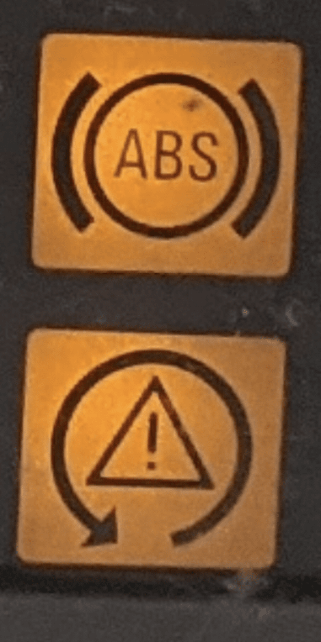

Sorry another noob question, just filled up with oil again, before I try and turn it over, any idea what might have caused these warning lights?

I think they just come on with the ignition?
See whats on when its started.
Good luck with the engine 🤞
