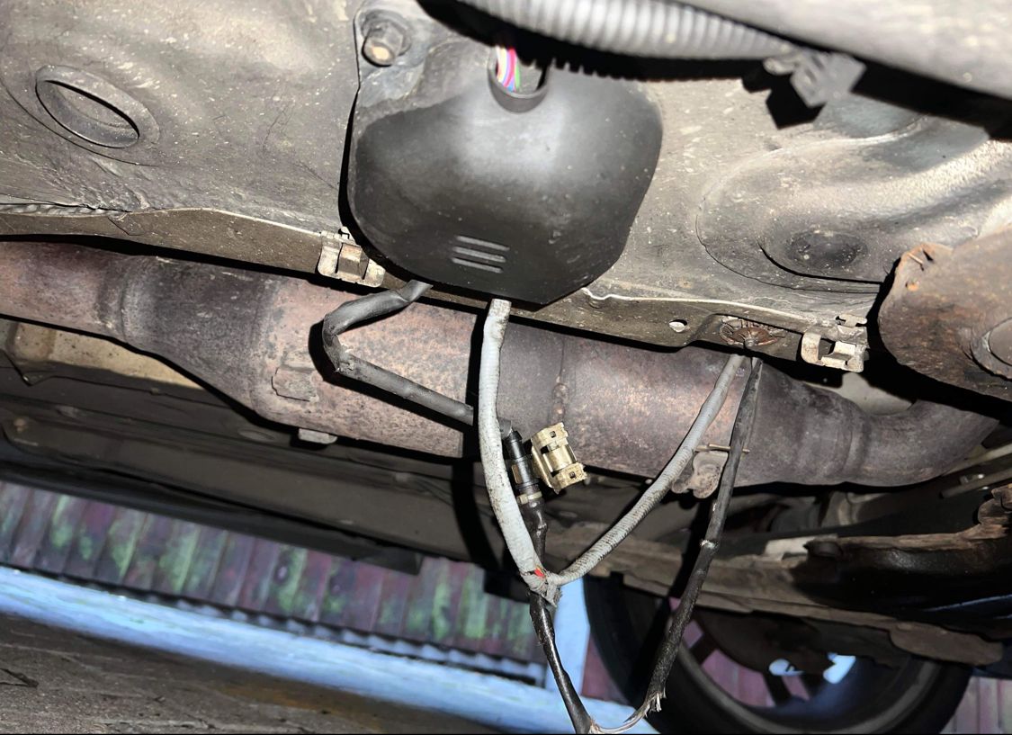

Hi there, I've been having trouble with my Cupra recently. Out of no where the throttle just vanished, no response whatsoever.
TBS, APS, LAMBDA SENSORS
  • I looked under the car and saw 02 sensor wiring dangling down and it appeared as if it had been ripped apart.
  • I have replaced the throttle body and the accelerator pedal, however, still nothing.

Image of the 02 sensor wiring -
Any form of help would be greatly appreciated, thank you!

Hi. Have you checked the accelerator sensor:
1J0907651A​
Also, see if this helps:
Ross Tech Calibrations
Hi there,
There is no codes on diagnostic tool for this so wouldn't assume it would be an issue
Out of curiosity where would the 'accelerator sensor' be found in engine bay/drivers side?
I have replaced the accelerator pedal and the sensor on it, throttle body and sensor on it, 02 sensors, still nothing.
Going to perform a re-learn/calibration today, see if it fixes the issue.
